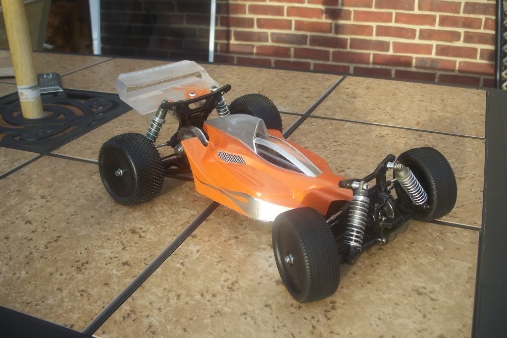

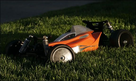

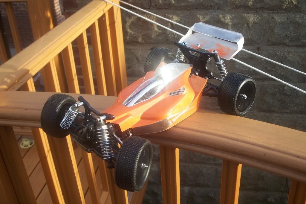

Whats up gents... This is my DF03. It has Losi 2.2 dish wheels dyed black, Losi tires, Losi XX4 WE shocks, Trinity mounts, Associated slipper clutch/spur, Carbon shock towers(still in bags)Keen Hawk body modied, custom hand made down force wing (yet to be finished off), custom front suspension arms and shock set up, and other misc mods including Castle sidewinder 5700 and Robinson Racing pinions.
Here are some pics... it's for sale.

Orange, your DF-03 looks awesome! Some questions:
1) How did you mount all your electronics underneath the keen-hawk shell? The Keen Hawk shell is probably the most aggressive and limits the internal volume the most.
2) "Custom" front suspension arms? Do you care to share with us what you mean by this?
3) Durga axle and Losi wheels. How and... HOW???

1. I mounted the Castle ESC on it's side with the heat sink facing out. I mounted the Airtronics mini reciever on the same side as the servo. It fits nice, the only pain in the ass is the drive shaft location.
2. Custom as in reversed, and shaved. I did this to mount the shocks to the front of the tower. It handles big jumps better this way, I also did the same with the rear shocks, but using stock rear arms.
3. Losi wheels
It took me a long, long time to figure it out but in reality it was very obvious. I used TRF 501x/ Durga axles front and rear. In the rear the losis dont use any hex, just a pin. behind the pin I used spacers to make it tight to the bearing. On the front I used the TRF 501x axle with 501x hex. Voila... Losi/ ae wheels and tires.
To my best knowledge I have the only DF with these mods (untill now lol). So if you want losis you just have to buy mine to get them
