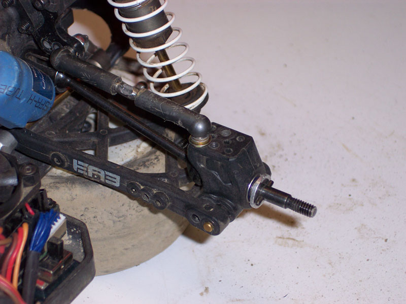

the xxx-cr hubs with either the BK2 or CR rear arms allow for more tuning options, VLA. when running the cr arms you need to run the bk2 rear cvds or they jam into the diff nut and cr cvds when using the bk2 arms...cvd wont be long enough.
Use a nut instead of washers in the rear, apply red loctite on the nut and screw it onto the ball stud itself. Washers even if you put ball stud tight they will still flex causing metal fatigue on your ball studs
