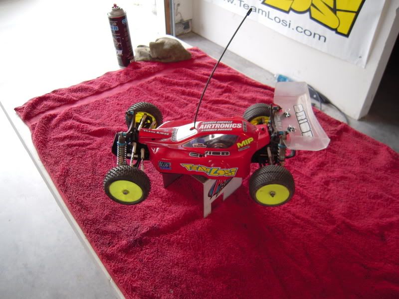

Originally Posted by Tim W.
Here is my XXX-4
What kind of shocks are you running on that thing?
It looks good too BTW.

correct me if im wrong, but thoes look like losi shocks, with blue threaded collars, on the red car.
Yes, they are losi shocks with blue threaded collars
This season so far I am liking my xxx-4 over my xx-4 WE on our current track layout. The xxx-4 is a great car.
