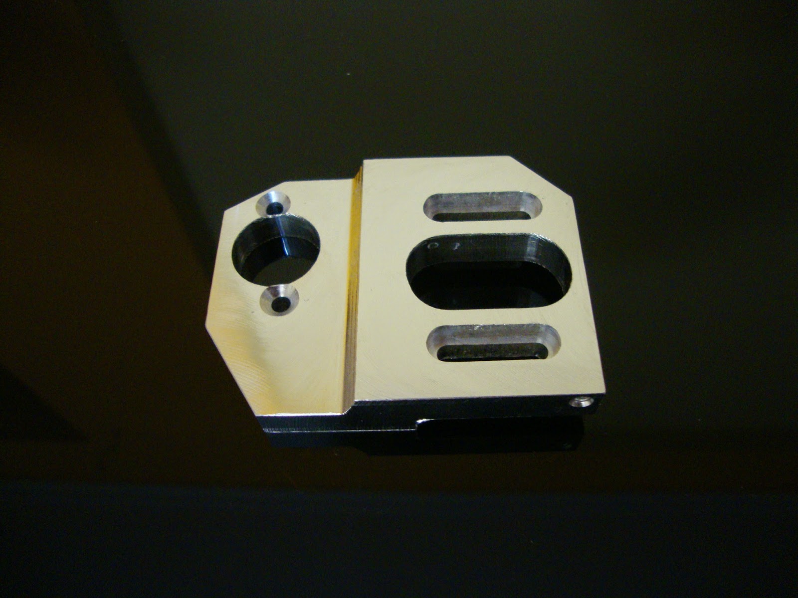

So here is my finished bl project on a friends traxxas jato .
Motor mount machined on aluminum 7075
Accept 540-550 motors
also 1/8 size motors 40-42mm but believe too much power for that car .
Machined plastic battery tray made from heavy industrial plastic material
Single speed conversion with 2 pin blocked method
Before ...
And after the installation of both 2mm pins
Mod 0,8 spur switced to mod1 from traxxas revo
This car ir really amazing converted to brushless,all the other 2wd electric trucks has the motor in the rear ,jato is a mid engine truck and this makes the hole difference .Powered with a 550 motor like the leopard 3674 on 3s lipo has crazy power ,on 4s its just out of limits (great for draster )
More infos at: http://brushlessmaniac.blogspot.gr/2...brushless.html
