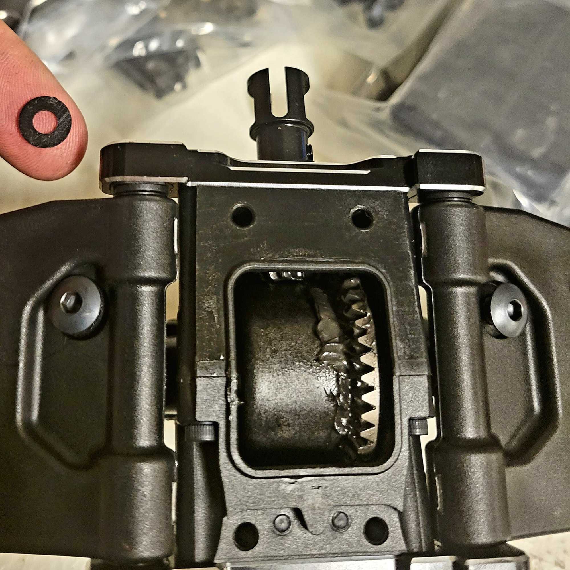

It's here! Of note - you get four of the plastic spacer pictured for the front end. You only need two, and it's real easy to miss in the instructions. They go on the outdrive side of the hinge pins on the front end (pictured installed).
Second note - kit packs a 2.3 bar, latest setup sheet wants a 2.4, so use the one from the option bag.

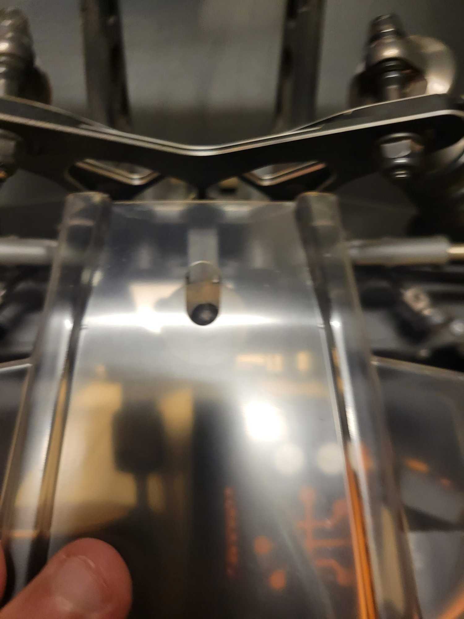

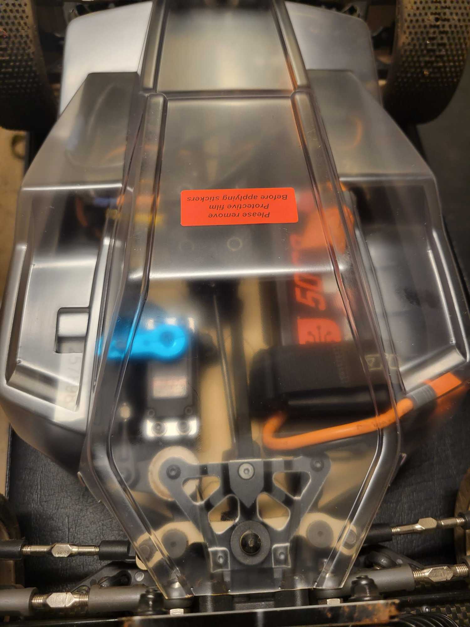

Not a direct fit, but the new body will fit on the old car if you ream the rear hole a little. The old body should fit on the new car with a similar mod if you use the new nose, just compared two side by side. Will take a fitment shot tomorrow when I put the clips on the chassis, but here's the new body on the old chassis so you can see.
