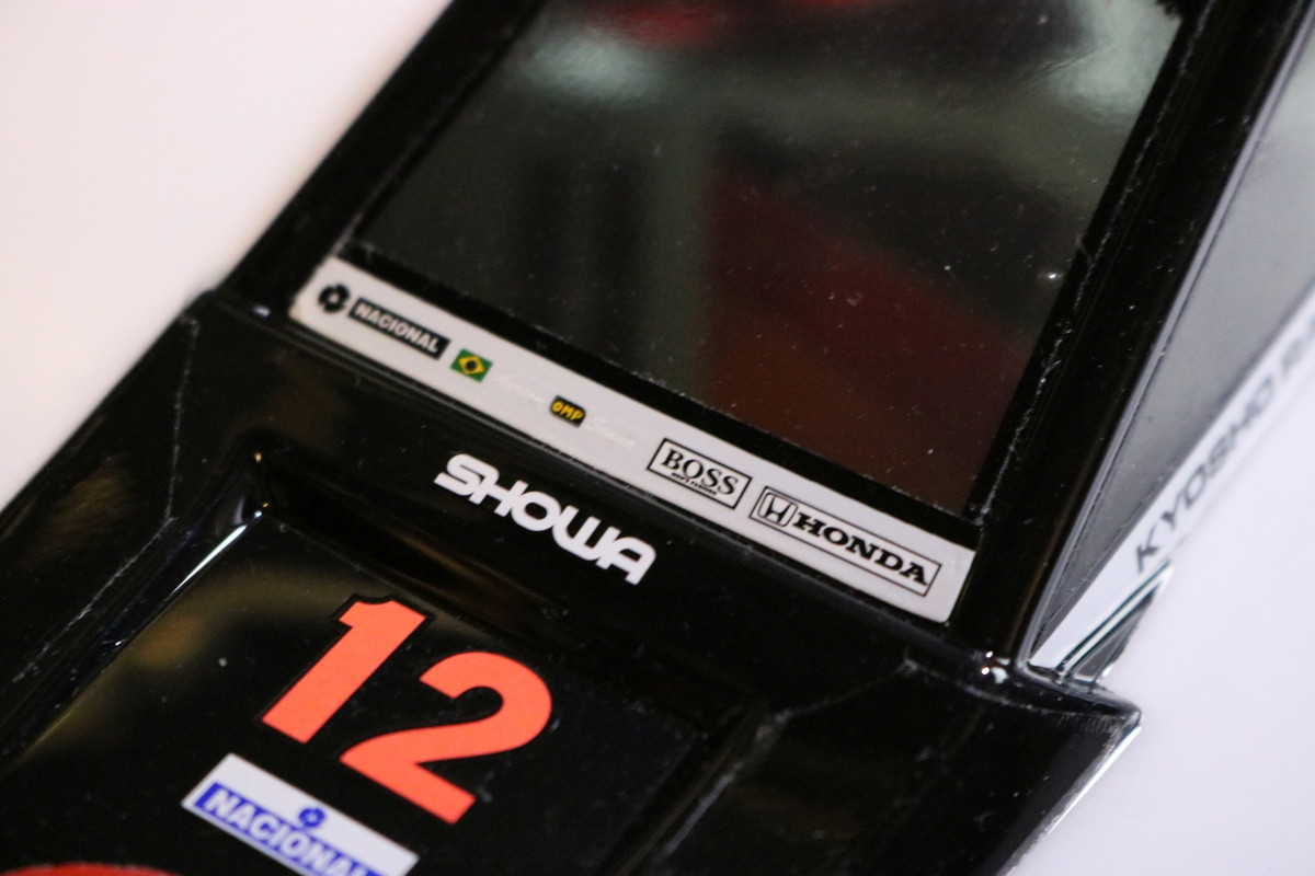

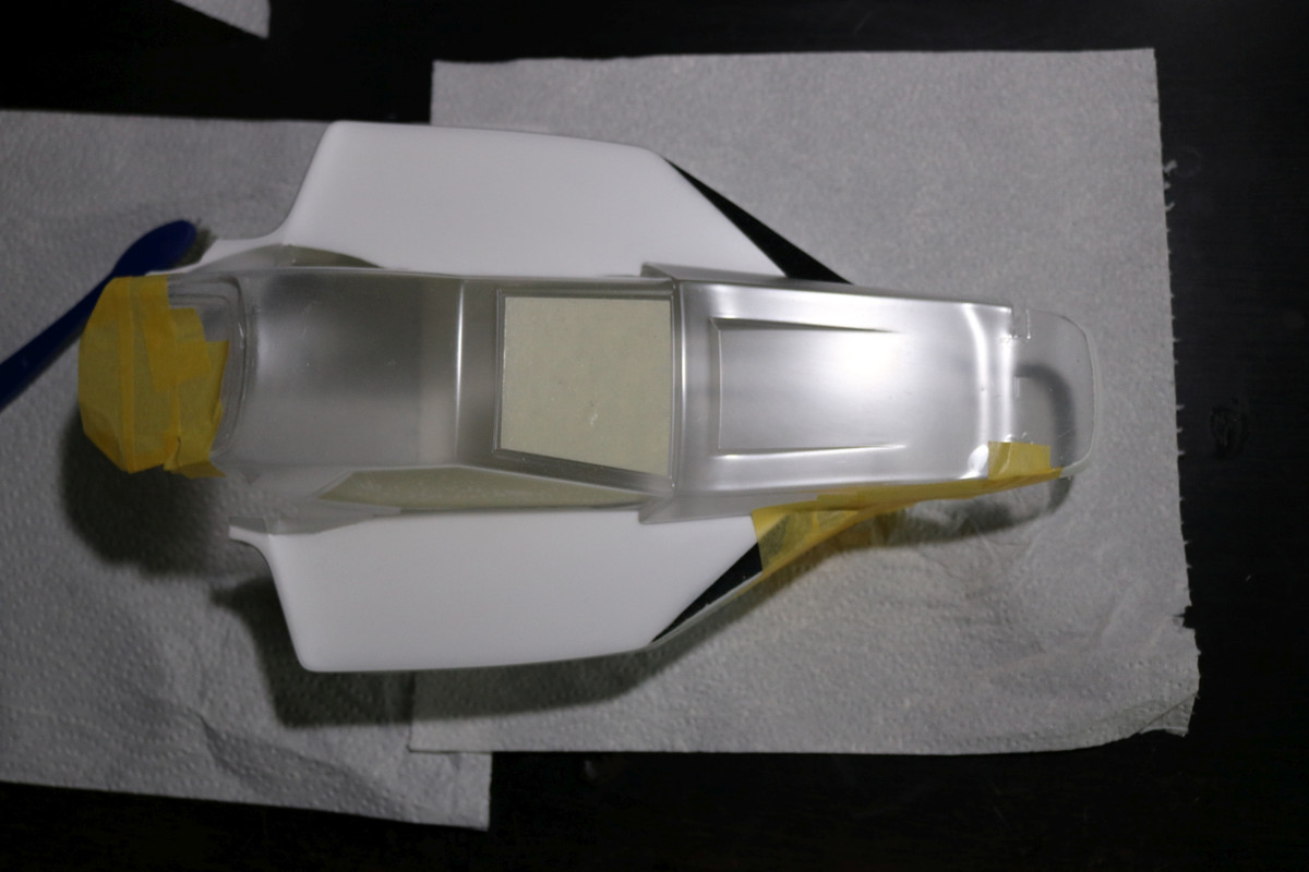

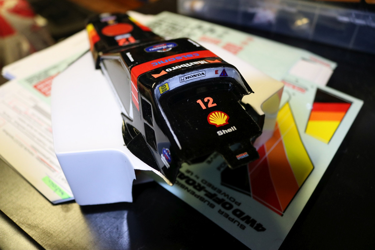

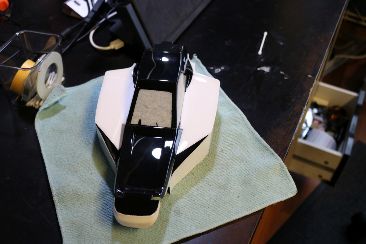

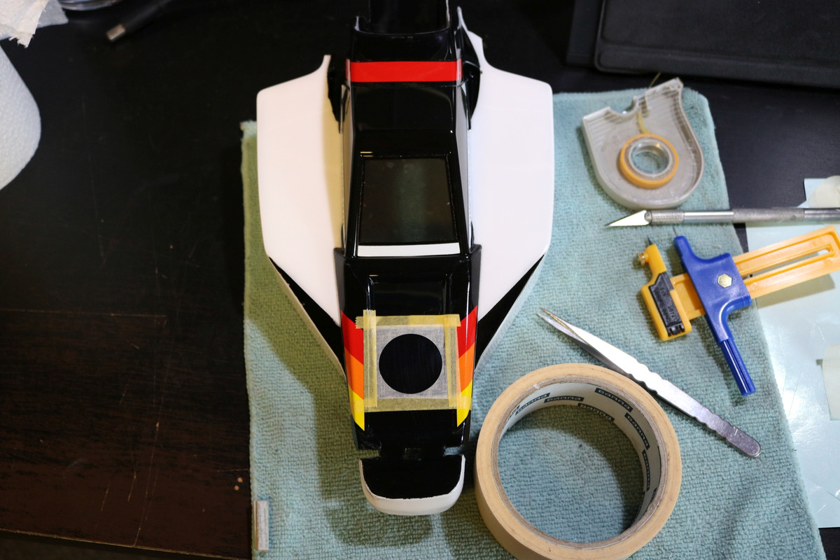

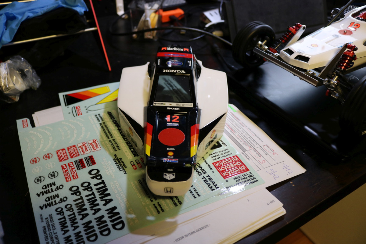

Build progress, only body actually, and new decals
Also tested the new electronics already (identical as used for my Scorpion Turbo)
these new decals really finish the body and give it a scale realistic look imo
I hope it doesnt take long for the ball diffs to arrive, they were postponed again, somewhere in december again...
Of course I wont be ripping with this body, the 'bashody' will have similar body colors, with a lot less decals.

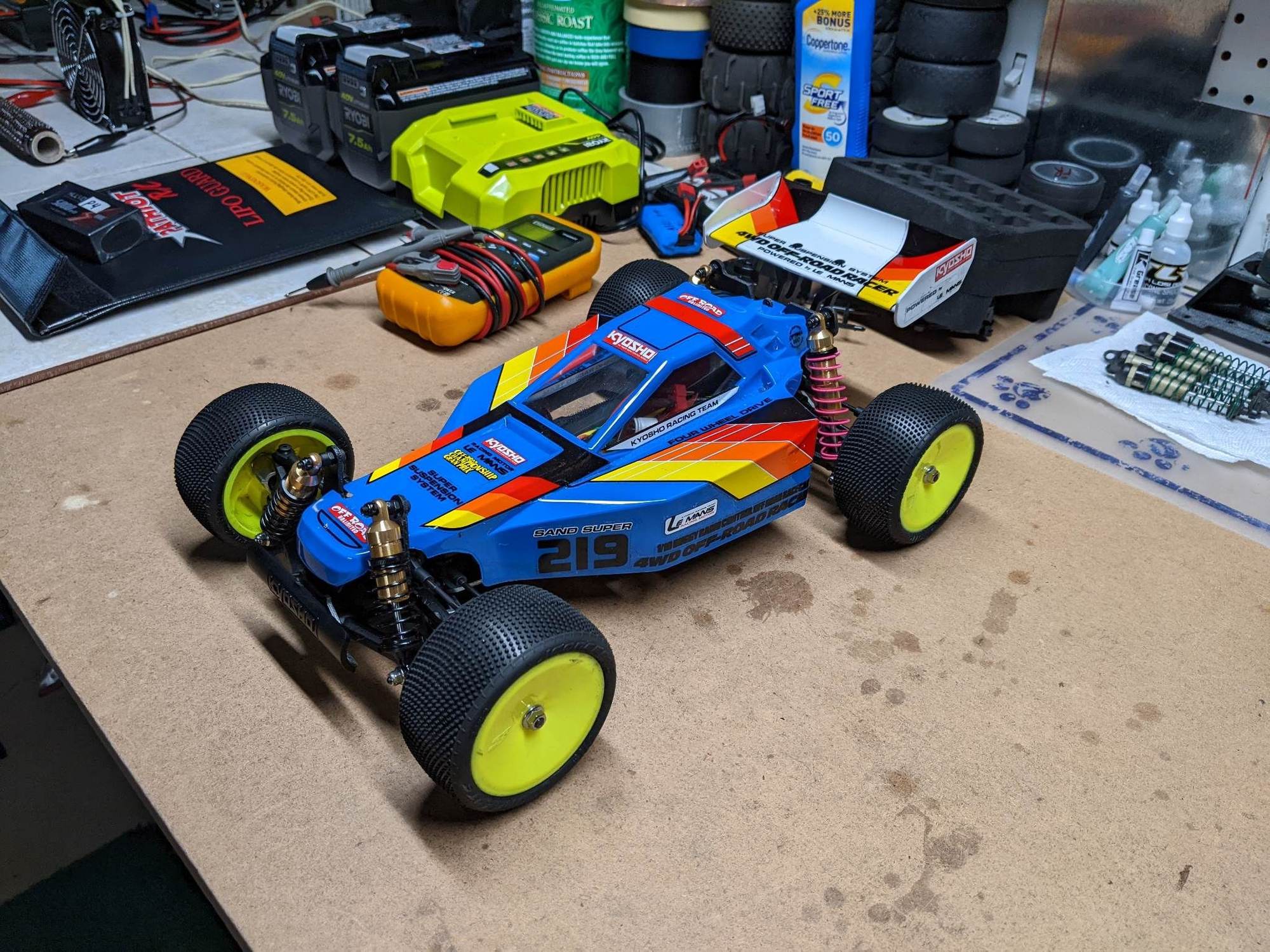

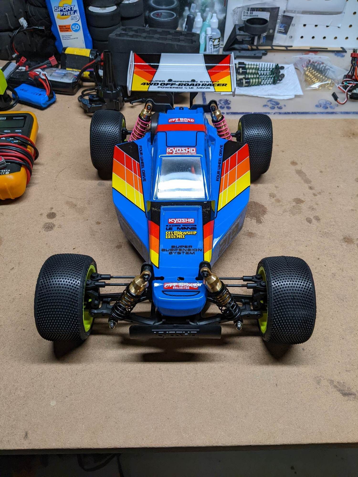

No, the offset for the front and rear of the Optima Mid are the same and are not the same as either the front or the rear of the B74. They are close to the rear wheels for the B74 but not quite. I have fit two sets of rear Fuzzbite premounts to my Mid and it is close the right width (about 6mm skinny). The pics show mine with 2mm of spacers in the hexes per side.
