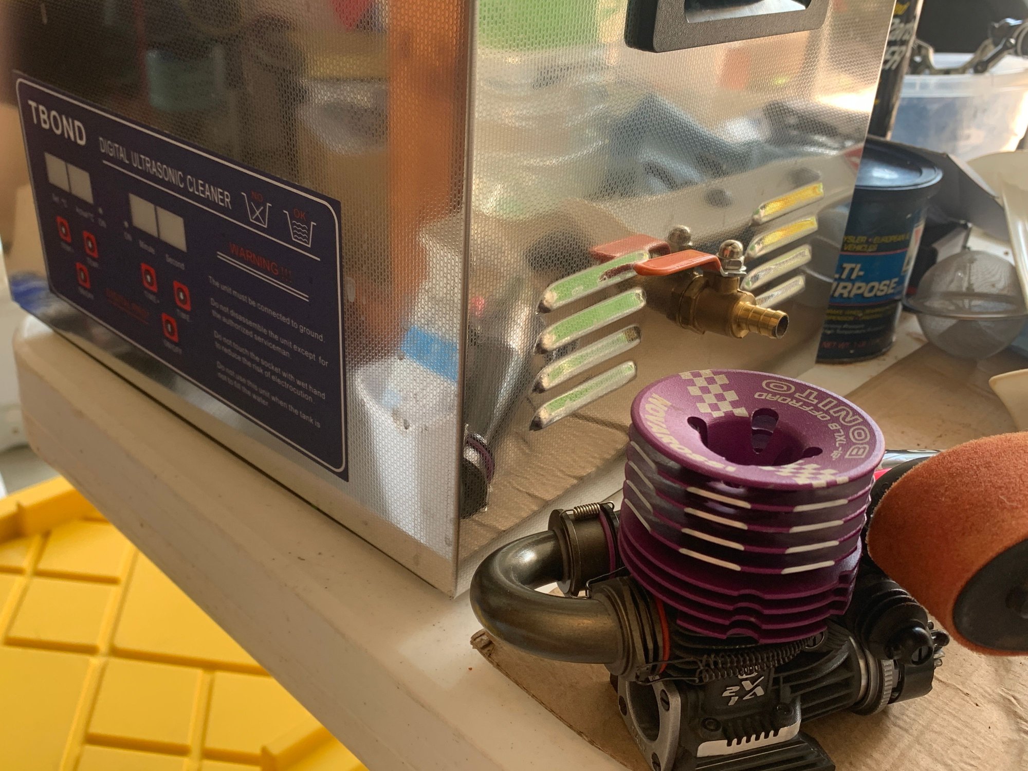

Iíve used simple green in an ultrasonic cleaner on ceramics recently and havenít had any issues. I needed to spend more time spinning them up with an air compressor after treatment to free them up. Or dip them in some acetone after the simple green cleaning and blast them with air until they spin up freely.
this is just what Iíve done recently to clean my ceramic clutch bearings (nitro). Not sure how repeatable this process is going to be over the long term, but it has worked well at least twice on this set of ceramic clutch bearings
Ultrasonic cleaner from Amazon
Serviced ceramic bearings and clutch
