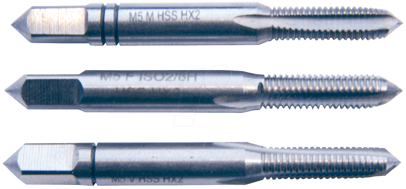

If you have a 3 stage tap set (3 taps) then use stage 1 or 2 but not number 3. With nr 1 or 2 the screw still will be tight. But normally no tap is needed.
What's a 3 stage tap? Link. Quick google look in between work stuff didn't yield much.

This is such a set: The one stripe is stage-1, the 2 stripe is stage-2 and the no stripe is the actual full sized thread. You can see a clear difference of the depth of the thread.....
