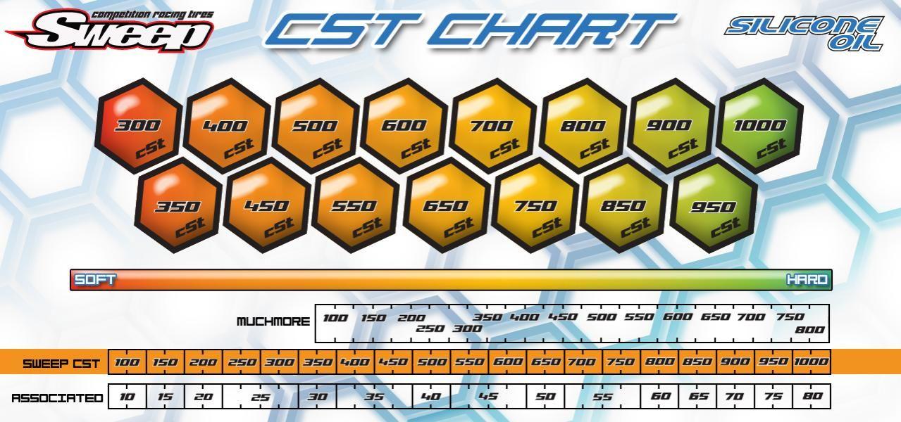

Yes, cSt is a standard measurement regardless of brand and you can use this value for the shock fluid too, I only use cSt on my setup sheets, note that AE 40W = 500cSt:
I don't buy any brand of fluid that doesn't post the cSt value.

Greetings all. I'm new to four-wheel drive if you don't count the yokomo dog fighter I had in 1985. I was going to ask if there is a conversion chart between CST and SAE oil weights but then I decided I would quit being so lazy and go look for one. Found this. I imagine it's as good of a conversion as any other?
RCDaddy2105 and SEAHAWKS3 like this.

There is this one also.
http://site.petitrc.com/reglages/OilChart.pdf
