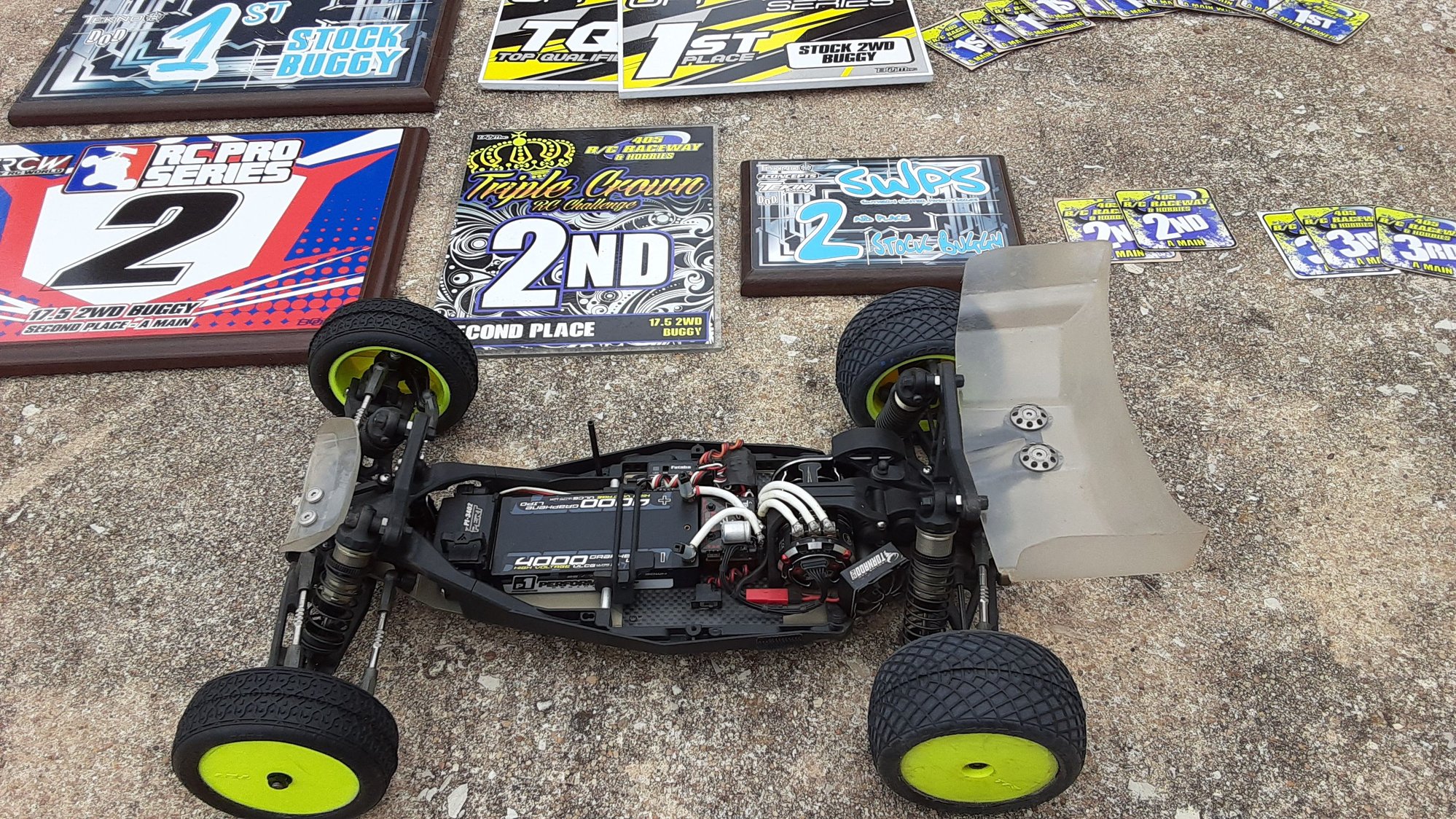

So I'm a little confused. Everyone knows that your vehicle will handle better if the weight is more centered. It is a scientific fact. Now here's my question: why are 1/10 buggies being designed so the battery is mounted perpendicular on the rather than parallel on the chassis? I'm told it is for weight control, but at the same time, everyone is adding weights to their cars.

if it's to centered you don't get any roll and then the handling will suck, also, if the battery goes lengtwise then the speedo has to be raised wich raises the C.O.G.
I think this is where you've gone wrong... there are so many other factors to handling other than how centered the weight is laterally.
The big difference with having the battery across the chassis is that you can move more of the weight around from front to back. As well as allowing more room for 'lay down' style transmission and motor placement. The recent trend towards higher grip surfaces makes it more important to get weight forward for steering, and to keep it low for cornering speed.
Another consideration is manufactures producing a chassis that can be adjusted for dirt/carpet and this requires a wider range of forward/rear adjustment than can be provided with the battery in line with the chassis.
If you want to try it there is plenty of space there, you can use double sided tape to attach a battery in line, or use one of the 'square' packs.
