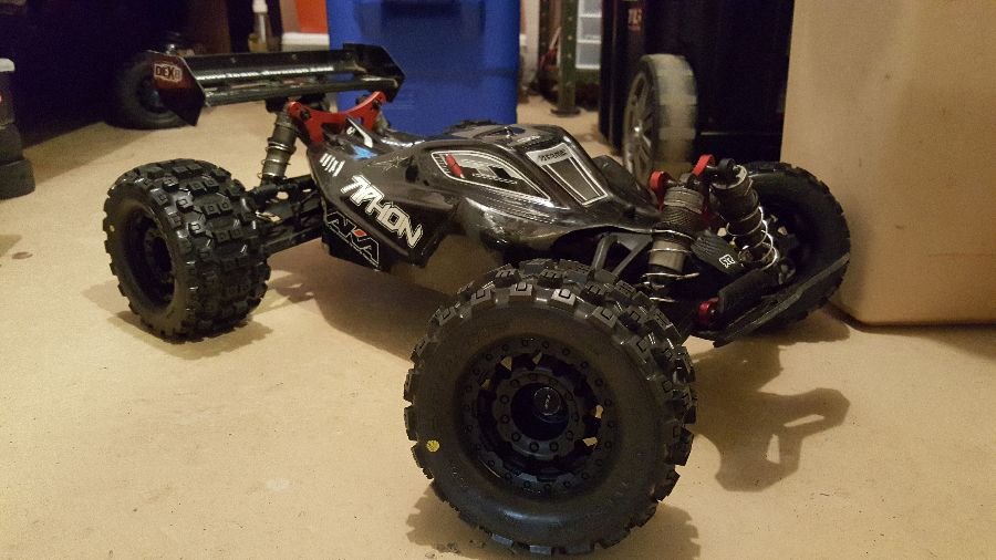

I've done this on my Arrma Typhon. Other than tires rubbing the body at lock, the other thing to watch for is if the chassis can still bottom out. If not, and you jump it, the shock eyelets will take all the landing stress and break.
