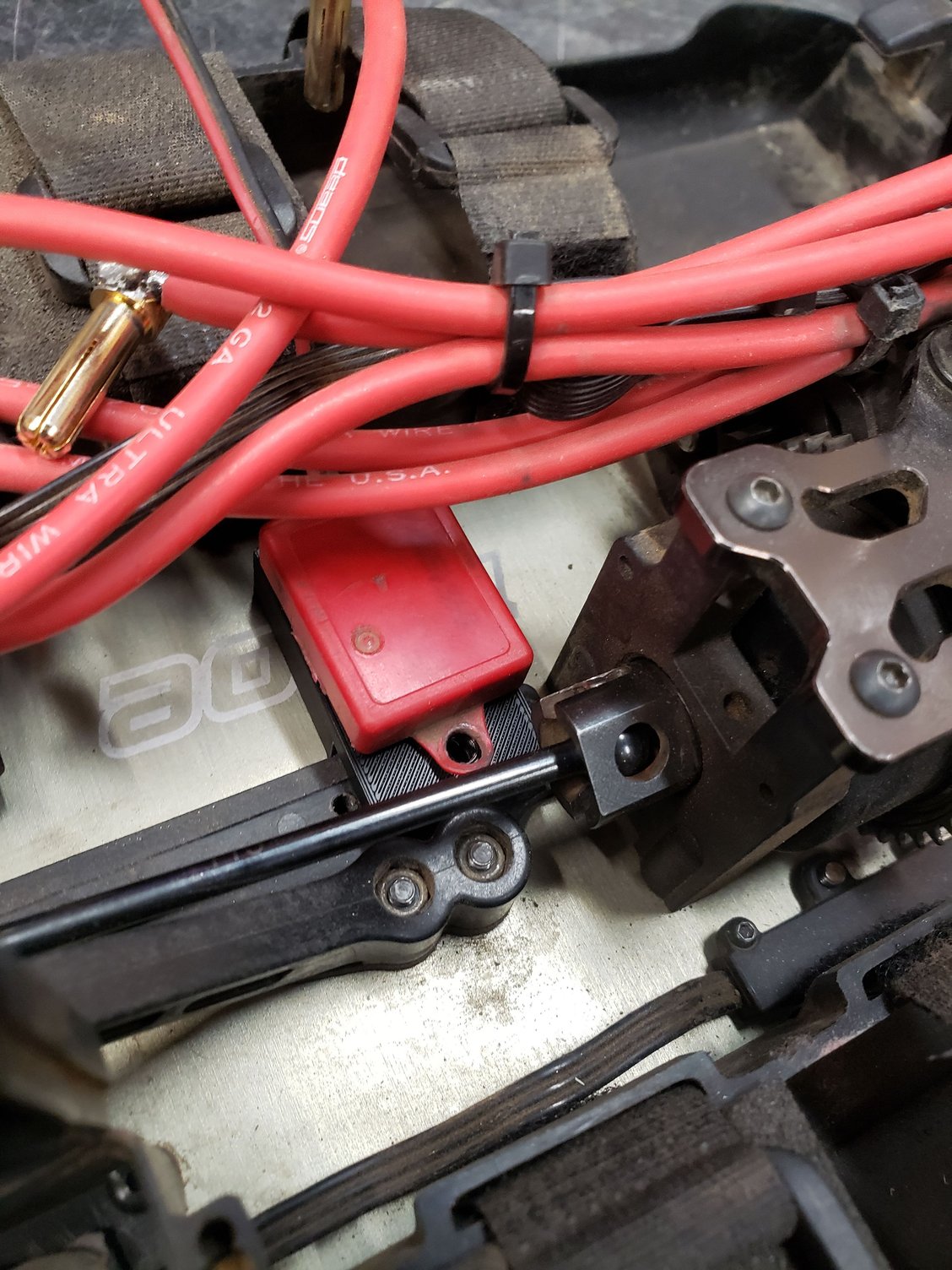

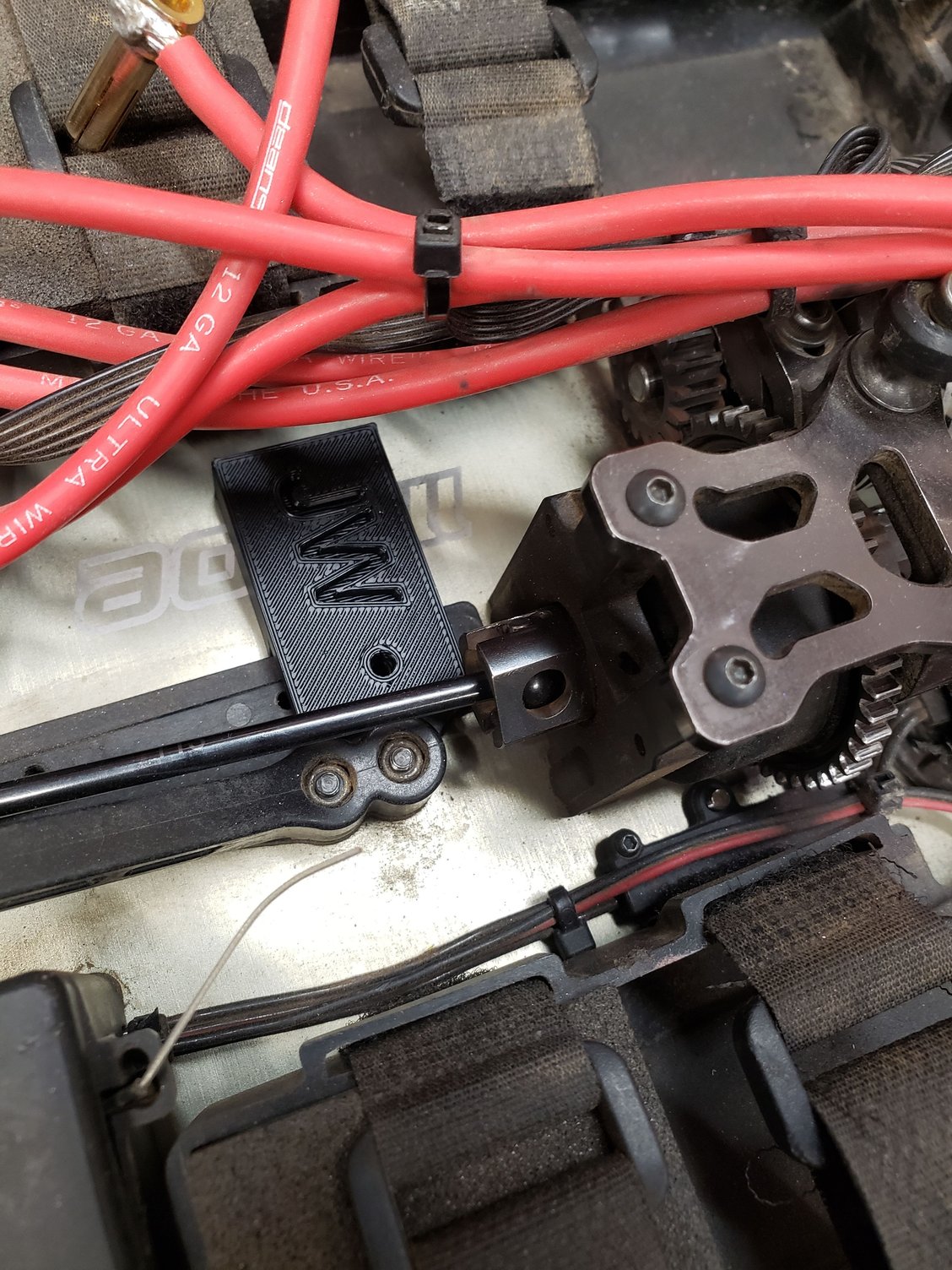

3d printed a transponder mount.. i know most put them in reciever box but i like to see if lamp is on at a quick glance

Got the transponder mounts made in black but can do neon yellow. See thru yellow. Orange. Green. Grey. White. Purple. Also transponder cases if you have bad wires to repair.

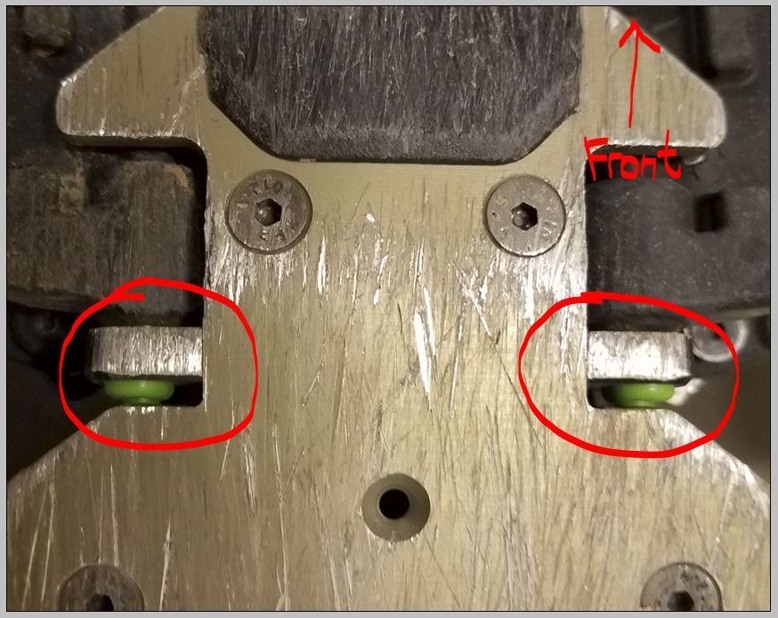

Is this the 'B' Block? Anyone think Kyosho could have designed it better? This is a brand new, replacement block, which is already taking a beating. The photo is after one day of practice.
This is on my MP10e, I have also replaced the chassis, which was long overdue. I needed to also replace the block, a $25 part, because the previous one was worn so thin and sharp that the plastic inserts were being prematurely worn as well. IMHO, Kyosho could have set this block up a little higher for more protection, similarly to the 'C' block on the rear. Sure the angle of the kick-up would be affected and/or not as drastic, but this isn't good. I may just have to learn to drive with harder springs to help minimize this crap, or put some bump-stops/travel limiters on the shock pivots. I don't consider the 'B' Block as a wearable item, but apparently it is. Any tips and tricks to minimize this damage?

B block. front to rear (ABCD)
I find the blocks ok and not that different to the other makes. I don't think you'll see Kyosho raising the block as that will in turn affect kickup.
To minimise bottoming I'd look at:
Thornhill shock cushions
MIP bypass valves
Increase droop and/or go inner hole on arm which gives the same travel as the TKI2 without spending cash
thicker shock oil
increase ride height
