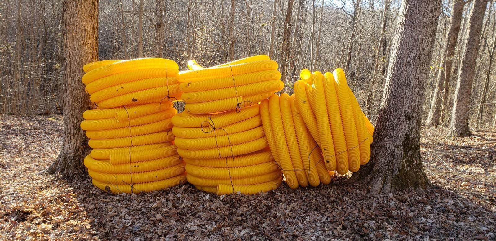

Please do not use corrugated pipe, unless you want to be on par with tracks. Its easy and common sure, but its not great. They catch your tires and throw your car around.
Most of the tracks I race at use it, but if I built a track at home I'd use some sort of 2.5-3in dia smooth tube of some kind. PVC or something, and heat it up and bend it for smooth bends. The smaller diameter makes it easy to drive over and get your buggy out of the infield or back on track.

800' of yellow corrugated pipe

2.5" diameter pipe is too small imo. 3" is the minimum for 1/10 scale offroad if you are interested in going by the Roar rules. Rigid pvc is smooth for the pipe riders but does not give/flex when you impact it like corrugated pipe goes. Corrugated pipe forms easily in any direction, up, down, right and left to fit to any shape track. If you want to ever change the layout of the track it can be done easily. If the day comes to get rid of the track the corrugated pipe is easily repurposed as drainage pipe. Rigid pvc pipe had the benefit of being smooth, you can bend it with heat. But it will be difficult to change the layout. Disposal I see as another issue being it would have limited uses after being bent and damaged over time. I frankly like the slightly larger size of the 4" id corrugated pipe because it also helps prevent accidental (and intentional) lane cutting.

Only use the 4" (10.1cm) corrugated pipe on the outside of my track to prevent impact damage to the truck hitting hard, close-by objects. Gotta really work to pipe ride 4" with a 1/10 ST.
