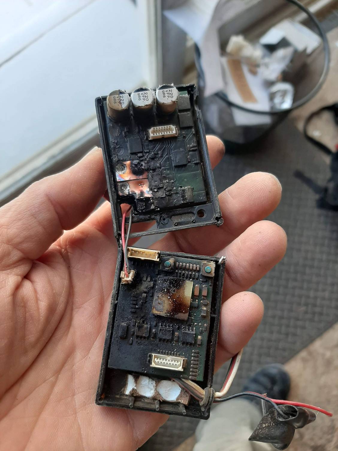

So I decided I wanted to get a real RC car and I shopped around and bought a Losi 8ight truggy RTR including the battery and charger. I knew I got a smokin' deal on it but I didn't realize that it would literally be smoking the first day I tried it out. It ran great for about 10 minutes and then rolled to a stop and went up in smoke. Both battery terminals melted off the ESC and its obviously toast. What did I do wrong? Somewhere I read that driving style could cause this?!?! Are you kidding me? I was not driving it that hard and if you can't abuse a truggy what is the point? I've also read that it could be caused by the motor. Is there some way to test it? I know water was not the issue because everything was frozen solid the day it happened. I'm super bummed and thinking about selling it now because a new ESC is about 2/3rds what I paid for the whole set up but before I go that route any ideas on what might have caused it to fail? I tried to post pics of the car and the ECU but the site would not let me.

Ouch. A couple things to look at. 1. What connectors did you use. 2. What exact model was esc. 3. Remove motor, disassemble and look for obvious damage.
I used to use deans connectors and I melted them. Too much current on high drain systems. Replace with XT90s if not already on there. If you did fry it, you can get a hobbywing much cheaper. Also, if semsorless is an option, the Arrma blx185 works great and can be had for about 65

If frozen snow hits a warm motor or esc, it will melt. Just saying so you don't rule it out completely.

Sorry about your luck, this wouldn't be the first time I've heard about this from a Tekin RX8. For the future, make sure you're not using the deans (T) style plug as they're not that great for 4s. I've had my buggy shut down because the esc got hot, I found out it was the deans plugs I was using. They don't pass enough amperage through them and it makes everything hot, from the battery to the esc to the motor. I second the Arrma blx185 for bashing purposes, it's a great and inexpensive esc that'll run a 6s lipo and it's waterproof. Sadly, tekin just isn't what it used to be. I've heard a lot of issues from their equipment lately, let's not get started on their Gen 2 products.

I did a quick look and it doesn't seem the RX8 is designed to be waterproof. The rx8 is considered a race only esc, you'd typically never race in a wet environment so I assume it was a way Tekin could save that .03 cents of silicon when making the esc.

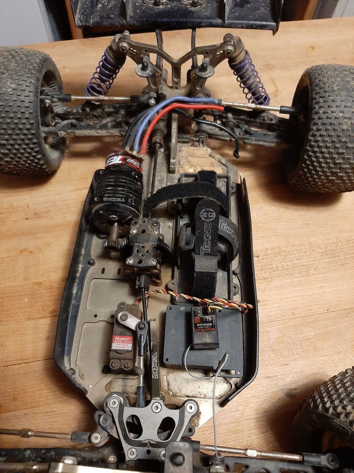

Thanks for the responses. I do have the Deans plugs. The Esc was in the back behind the 4s battery. I think I'll relocate it to the front where that plastic platform is.
