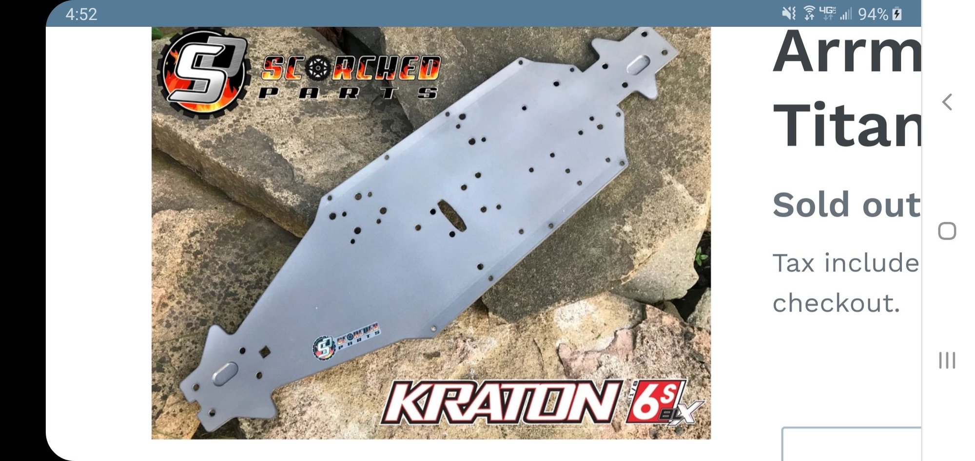

Titanium Chassie facts
The strongest Arrma chassis ever available - the ultimate bashers choice.
Titanium chassis are THREE times the strength of the stock chassis and 25% stronger than the even the very best aftermarket chassis.
Built of 3mm ti 6al-4v, it gives you unparalleled strength to weight, stronger than all other options.
This chassis is around 20% stiffer than the stock chassis.This means the chassis will still flex to absorb impacts but tauten handling and response.
This is a direct replacement. All standard fixings can be re-used.
Additional expensive skid plates or droop screw stops are not required -the titanium is tough and isn’t going to wear thin like aluminium. Taking this into account, the Titanium is the strongest, and also the cheapest choice!
At 590g it is lighter than some other aftermarket chassis (although a little heavier than the lighter options available) and is stronger than all other options.
A really fun thing also happens - the titanium will give a shower of sparks when it catches hard surfaces!

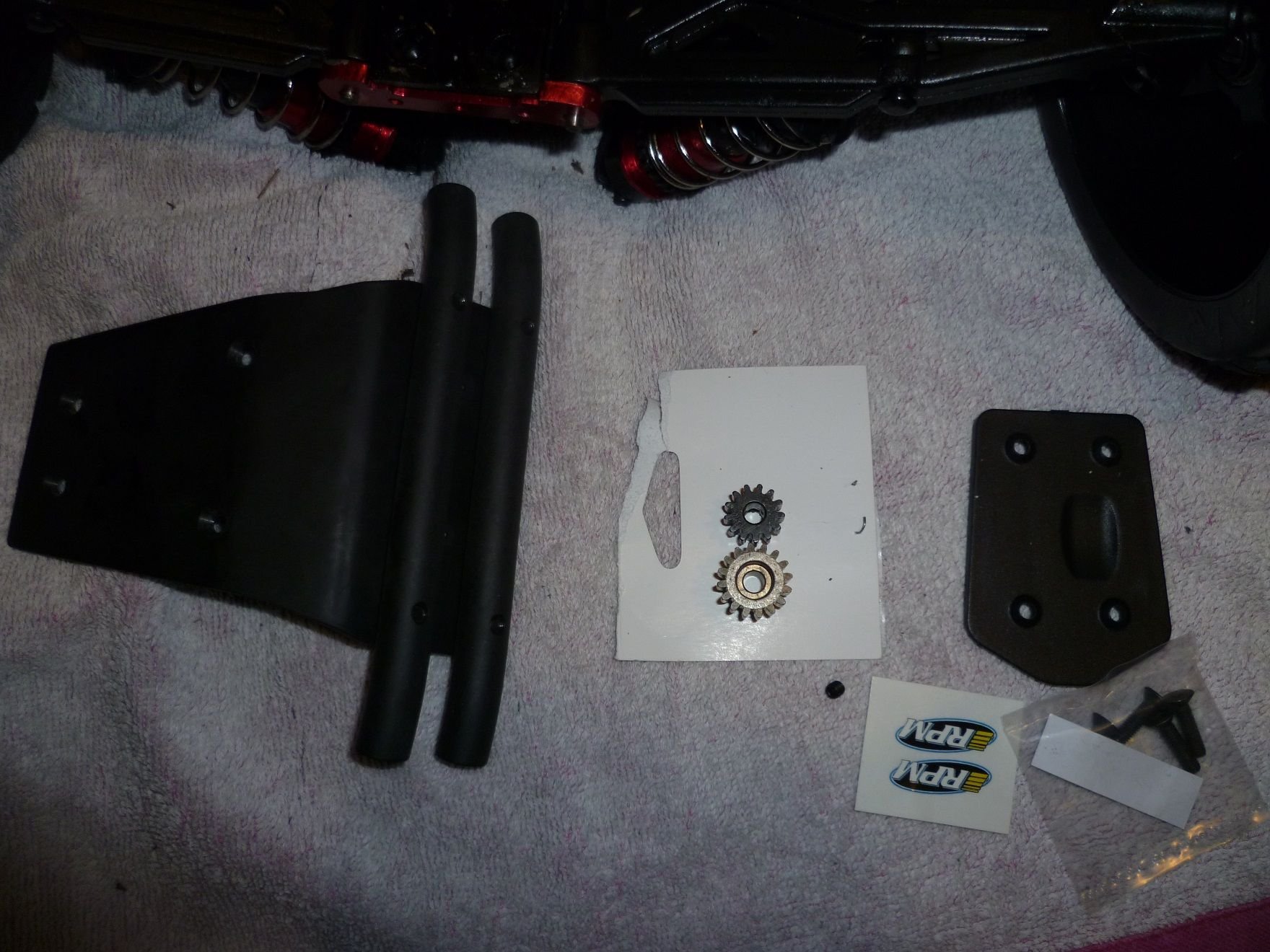

My build have start now.
Today:

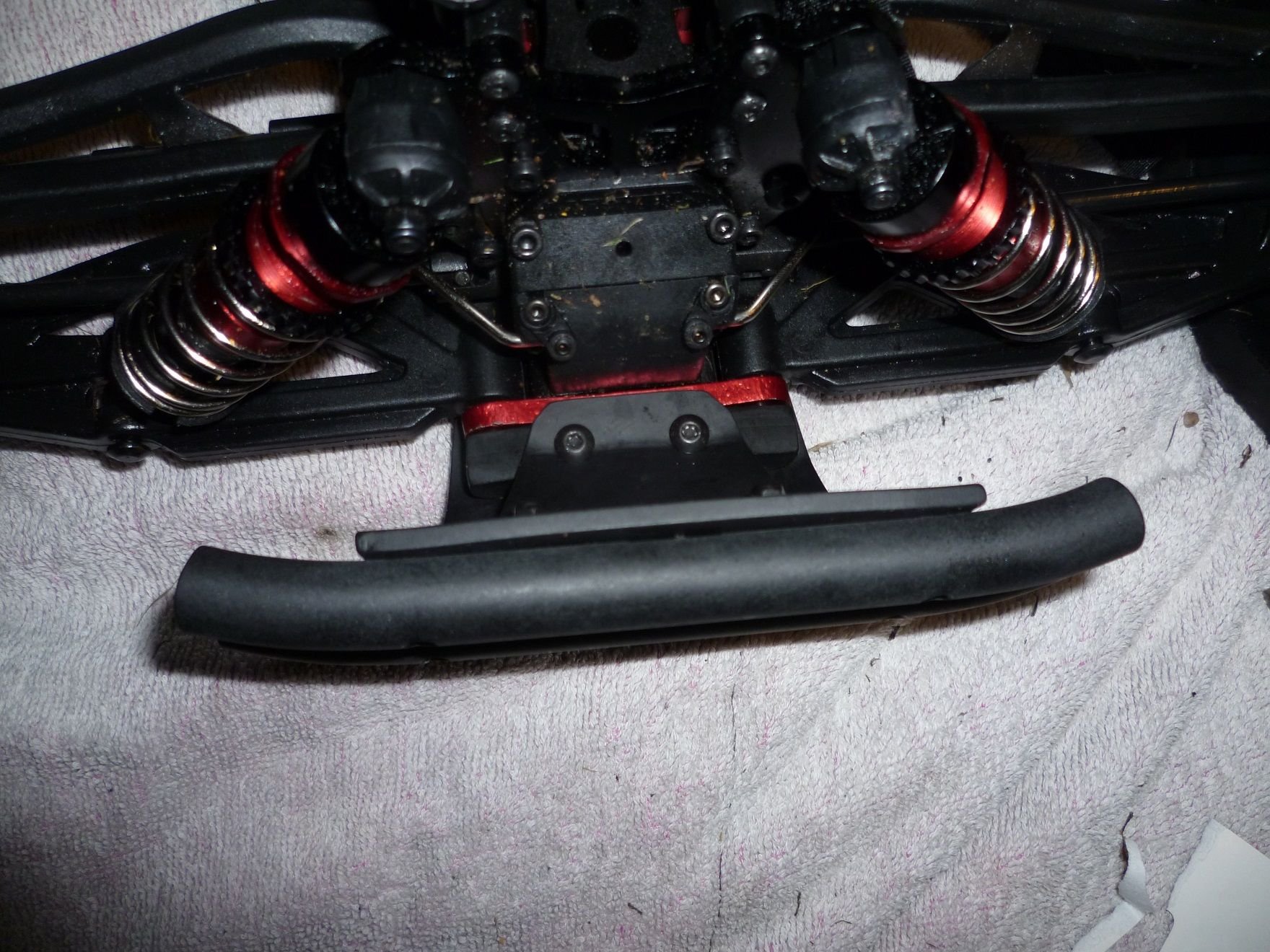

Tbone front Bumber

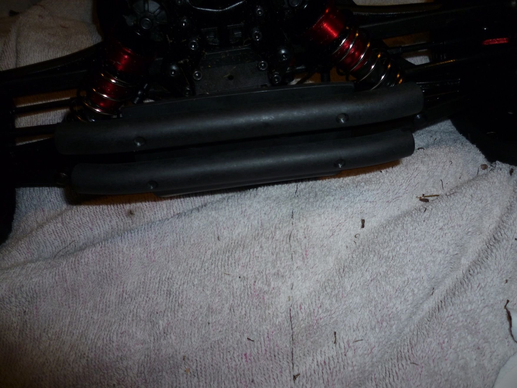

RPM rear plate cover
New 16t M1 Pinion also. Stock is 13t Speedpinion that included this car from factory is 20t. .i believe that 16t can be good choise, Something bethween Small and the Big Stock pinion.
if i want use 170mm RPM tyres i need go back to 13t . Like paddle tyres and Trenchers belted
I will do speedrunning with 20t pinion and 1/5 scale GRP supersoft street wheels
Random bash with 16t

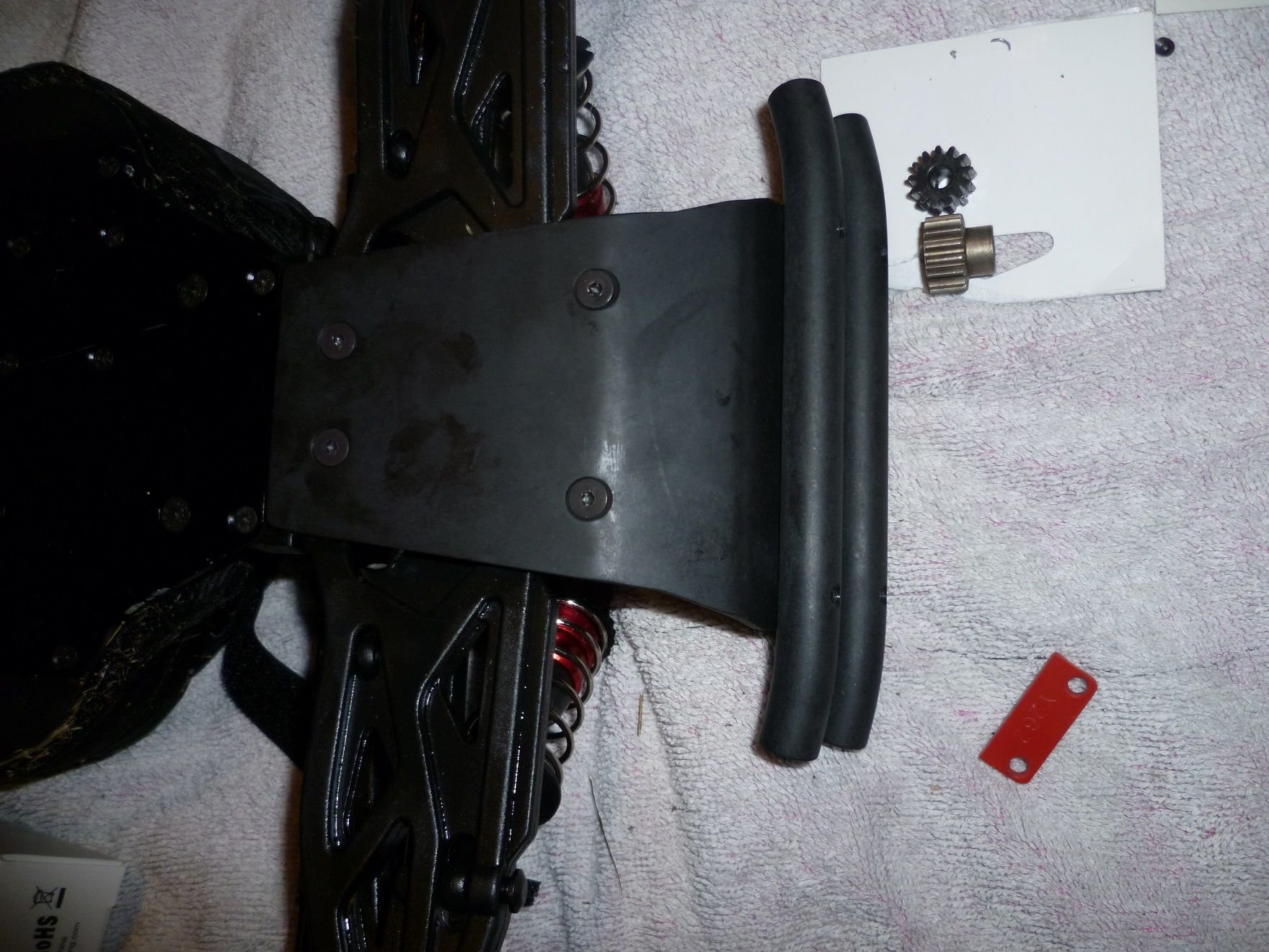

Now the T-BONE Racing front bumber sits there
I can feel this is Brutal Bumber.
This must be very durble i believe.

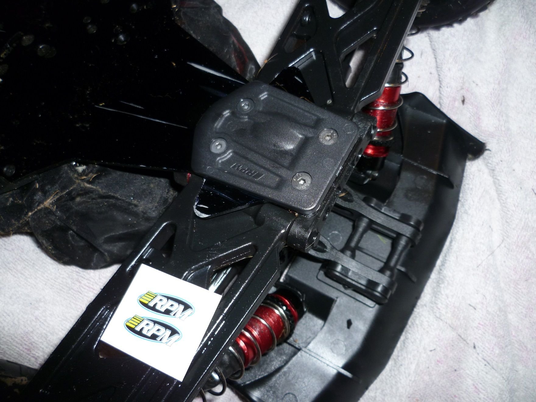

Then last
The RPM cover plate sitts there now also in rear

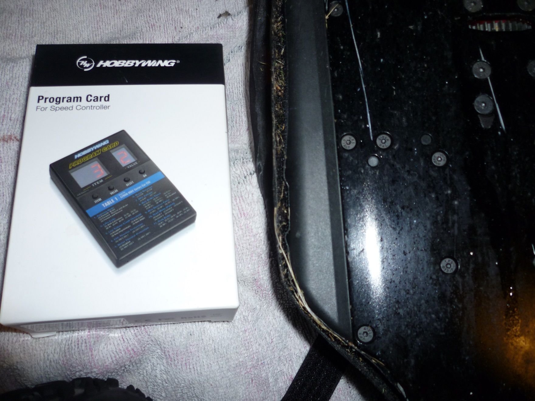

I use this programcard.- Very easy adjust the Stock BLX 185 ESC
Take loose fan cable. Whach where minus is, put the plug in the fan connector, black/minus must be same. Mount battery. Turn on the car and start program.
You have Five things you can program. Read the manual

Tbone racing front bumber 10084 - TBR XV4 Front Bumper - ARRMA Talion 6S BLX
https://tboneracing.net/collections/...talion-v3-2018
RPM Rear plate Cover
https://www.rpmrcproducts.com/shop/c...cale-vehicles/
Programbox
Hobbywing
https://www.hobbywingdirect.com/coll...rd-version-2-0
You can only adjust what you can program by set buttom.
Anyway it is alot more easy with this program box. I like it better.

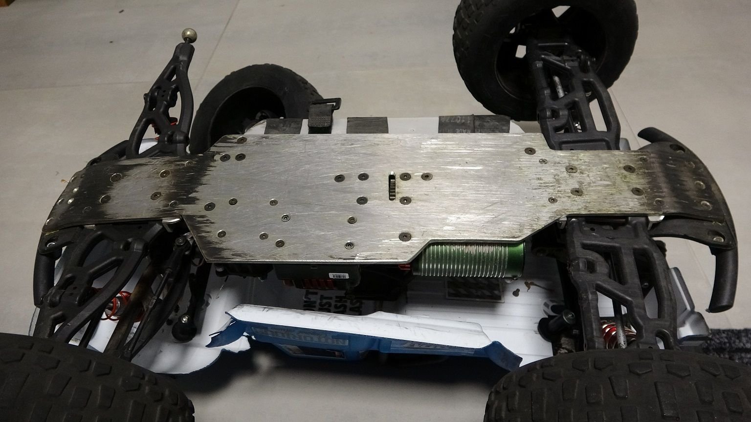

Again Titanium is not bendy or “springy” it shatters, I broke tie rods before on plastic hubs breaking the axles. I am not saying it’s undoable, Titanium is not the unobtanium it once was thought of, It has its place. I would opt to make structural pieces out of titanium like braces, etc. Aluminum flexes and gives protecting interconnected plastic or graphite parts. Titanium will only stress plastic parts out more especially bulkheads. Also over repeatedly stressing Titanium it gains metal fatigue faster than 7075.
Sure I can get a sheet of grade 5 no problem and copy a chassis, and set up a mill for accurate drill points with expensive tooling countersinks however to do front and rear kick up bend will have to be hot and the brake press needs to be set just right before attempting.
I also am not doubting that you can do what you have set out to do, however to prove that the actual work has been done on a media path such as this can prove difficult plus great manufacturers have engineered the products to actually make money and still win races, titles, and what not. Stiffness does not win races off road, on road maybe. Titanium plate is expensive and unnecessary for the most part.

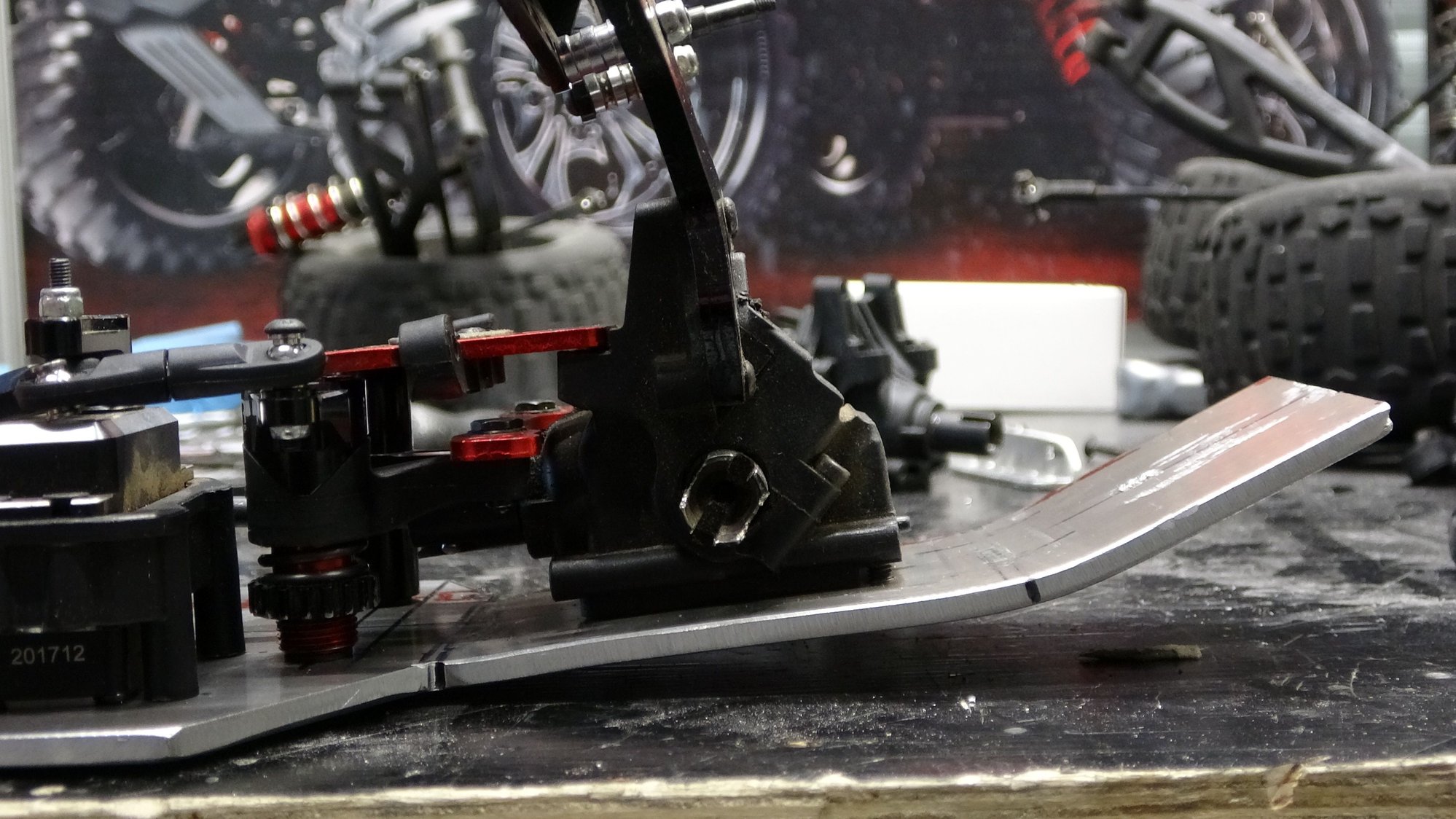

Most aftermarket arrma chassis I've seen don't have any kick up. Kind of unspoken joke on arrma section in Facebook.
About the titanium bending part, i use some titanium screws for the look and corrosion resistance. They certainly bend, but obviously they are tiny part compared to chassis/, braces, towers. I've also bent TiNi hinge pins. (I can confirm they aren't springy at all. ��
even my homemade chassis has a kick up
werner sline homemade notorious 7075 chassis. unbreakable ! but spindles still fail !
kick up + bumper
