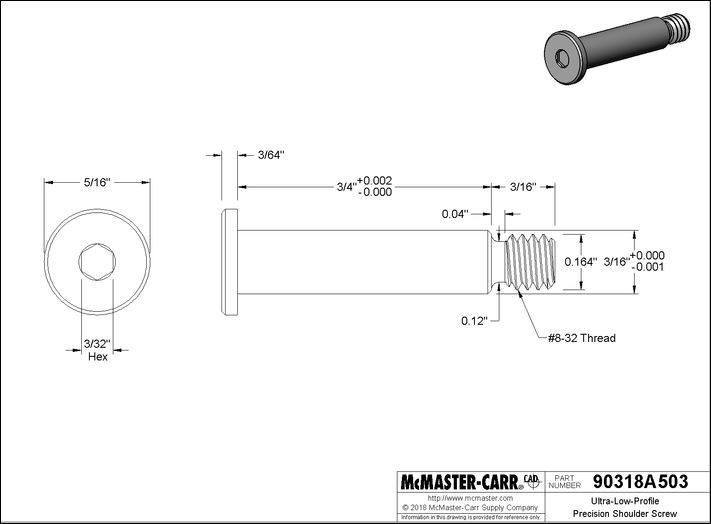

Here's a hint for you (depending on how industrious you want to be):
Try using 3/16" diameter shoulder screws and a clamping hex. You can get the shoulder screws from McMaster-Carr. Lengths that might be useful (in alloy steel) for this application range from $2 to $4 each.
I haven't done this for an SC10 but I did this (using the shoulder screws, in my case 5MM diameter) for front axles for a Slash. I built the car for Figure 8 racing and twice (not once, but twice) I got hit at the front wheel and the stock Traxxas axle broke right at the drive pin hole. By using the shoulder screw and a clamp hub I eliminated the drive pin hole and thus that vulnerability. So I know the idea works in concept. Whether it will work for an SC10 is something you will have to work out for yourself.

Interesting enough. A person would have to remove area (extra plastic where kingpin slides through) inside of of steering block, and find/make correct length crush tubes to go between the bearings. Correct?
The only 3/4" long (length needed for SC10 w/hexes) shoulder screw, that I seen, with ultra low profile....https://www.mcmaster.com/90318a503
Will have to keep this in mind.
I learned something today. Thanks!
As I said, I did this on a Slash, not an SC10, so I don't know about extra plastic where the king pin goes. I have an idea what you mean because all the axles I've seen do have a reduced section in between the bearings. You could do the same do the shoulder screw - put it in a drill and grind down the area where a kingpin might interfere.
As far as a crush sleeve - I didn't use one on the slash conversion. I just used a clamping hub and feel no need to torque the wheel nut past the point where the wheel doesn't move any more. With locking wheel nuts and no power through the axle, the front doesn't really need a lot of torque to hold it in place.
What I did need to do was grind down the head of the screw for clearance when the steering block is turned full lock. But again - a drill and a dremel cut-off wheel made that easy.
