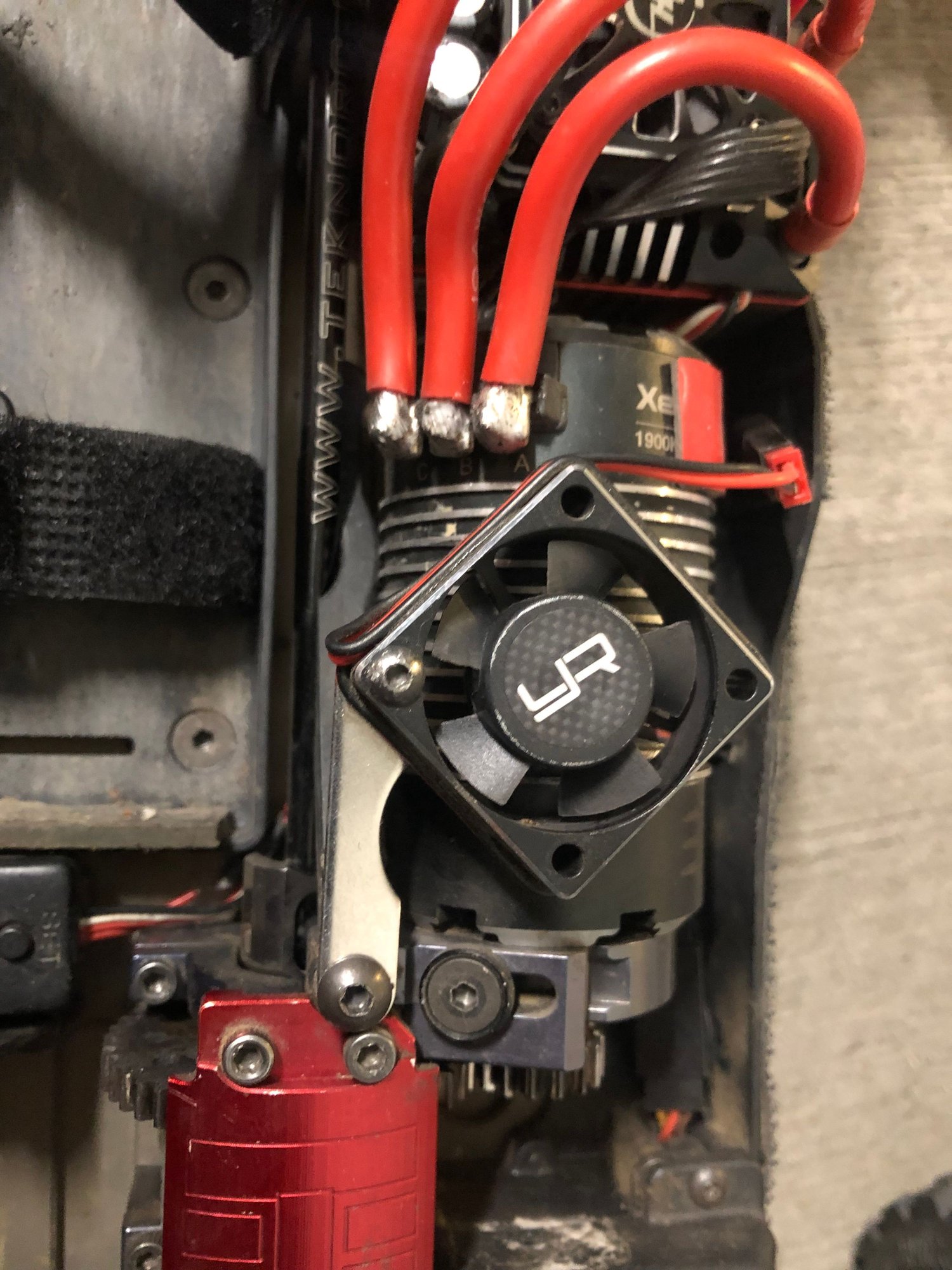

Adding a fan to keep things cooler wont hurt either. Options are pretty limited on the TEKNO 1/8th scale buggies so I used a HPI brake pad and installed an aluminum fan like this.
bmxracer39x likes this.
