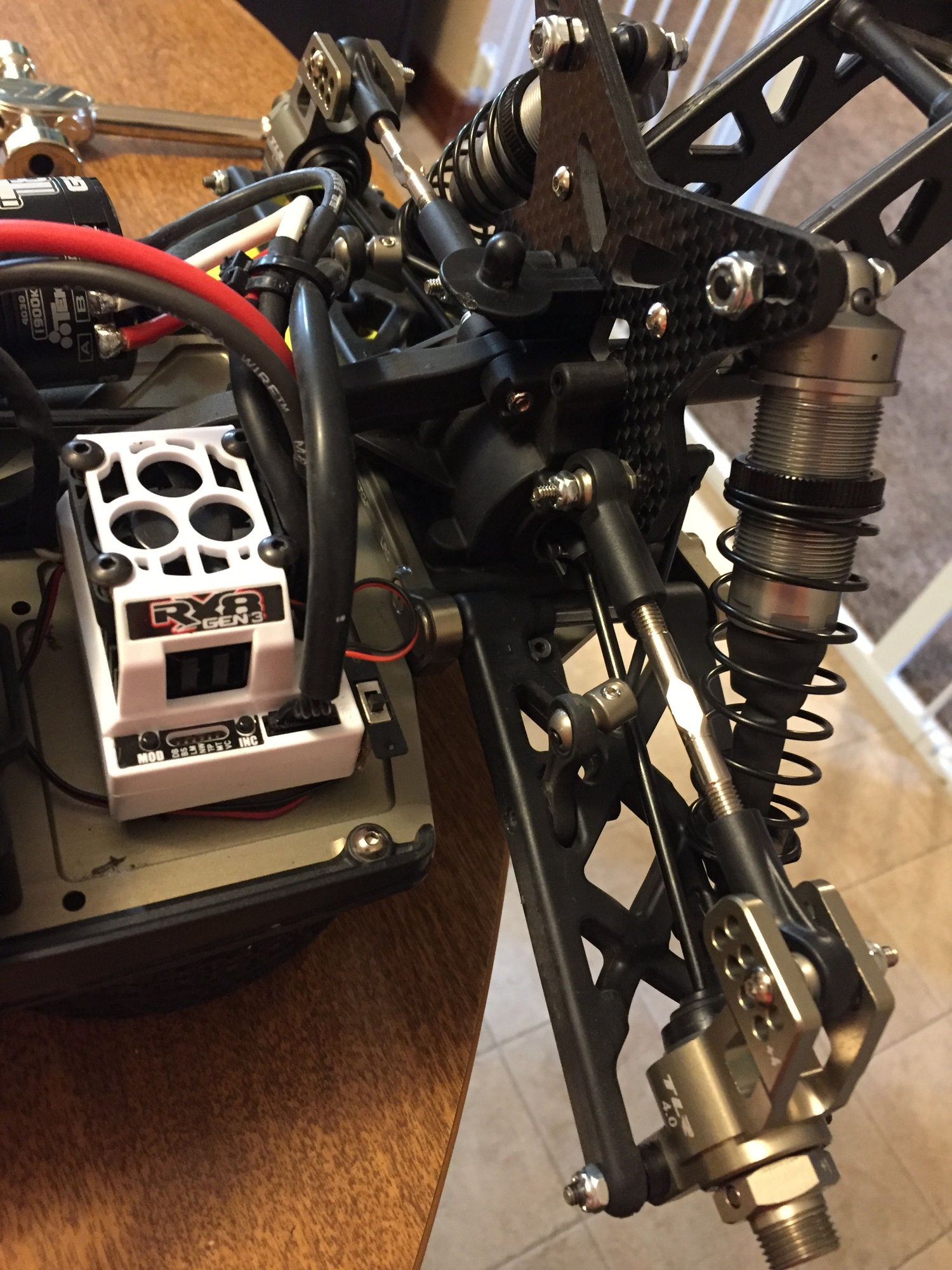

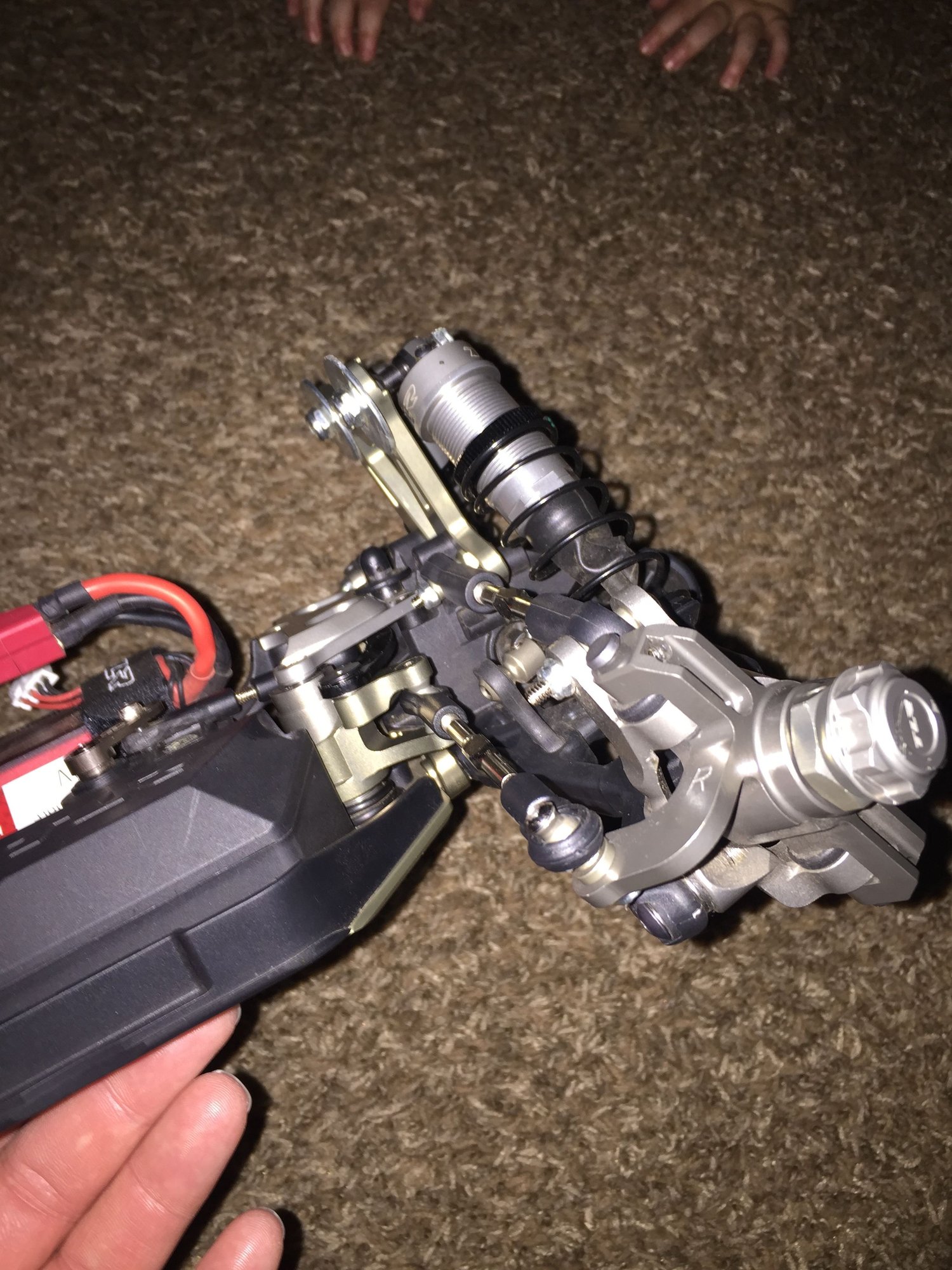

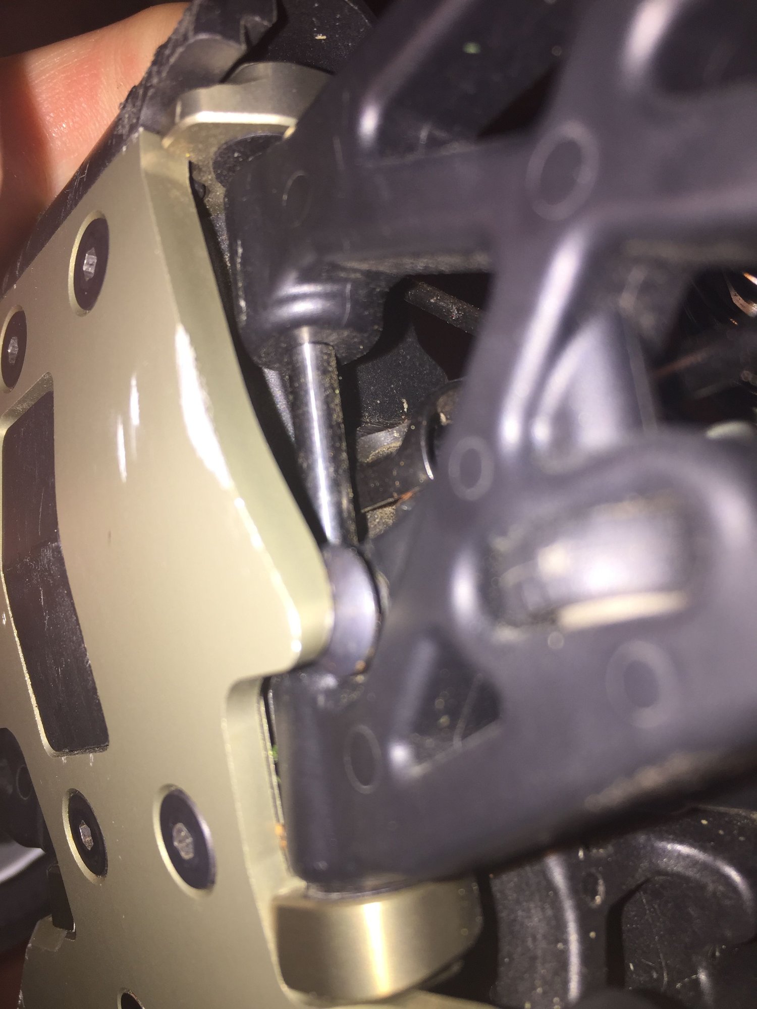

Overall state of upgrade for durability, before custom shimming. After I built it I had to disassemble the front as the hinge pin rubbed on the diff output. I setup the inserts wrong, shown in second pic after I corrected it. I also checked the rear and reduced anti squat.
