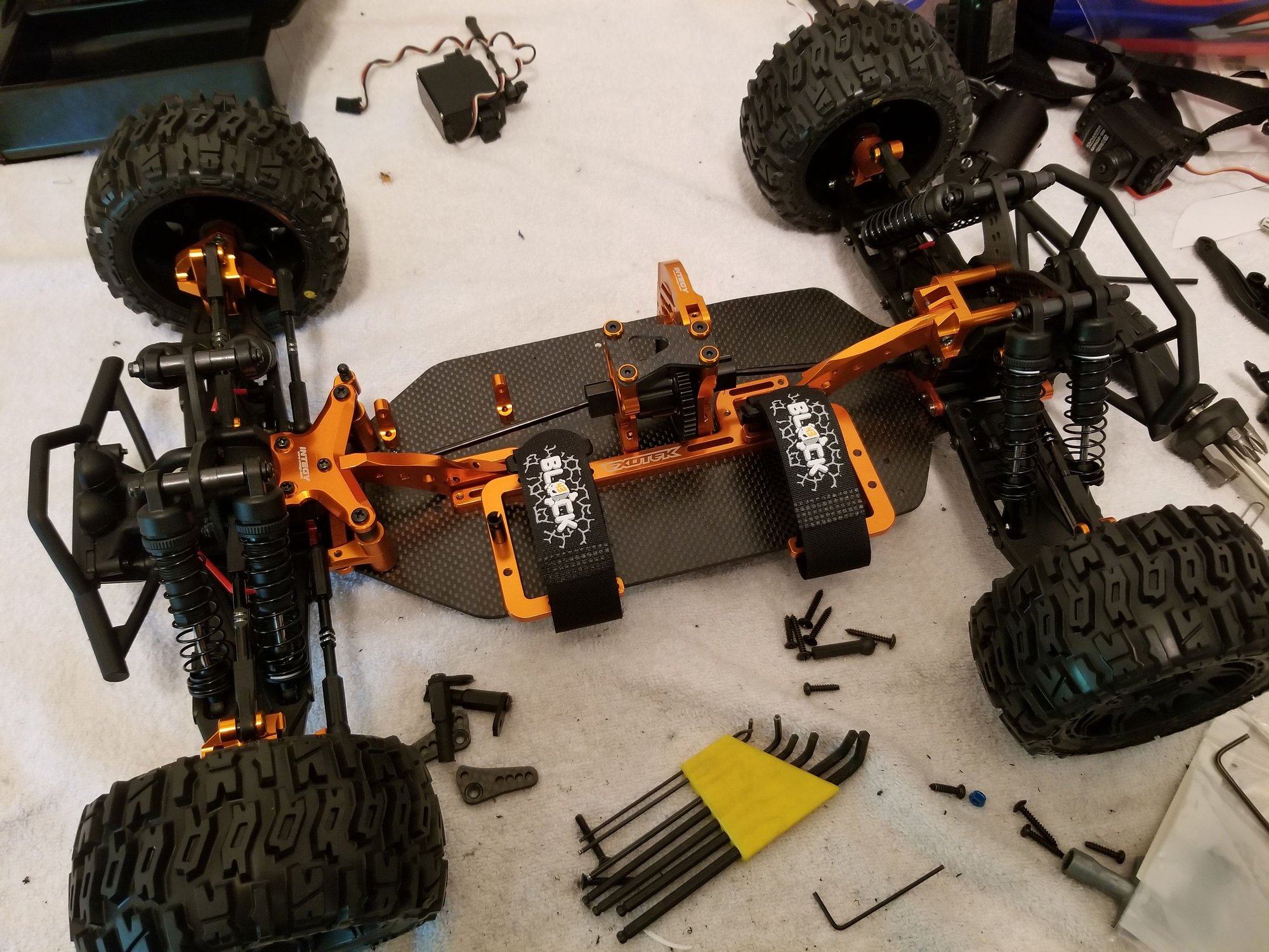

Finishing it up now. Turnbuckles are done. I'm not satisfied with the shock situation, though. I'd imagine that those plastic spacers are gonna flex under load, so I'm looking at different options. Also, those tires aren't exactly track-spec, but they're what I had on hand at the time, LOL. Better suspension mounting and wheel/tire combo to come...

The plastic shock-tower spacers won't flex under load because they aren't load-bearing. The long screws are. Your best bet is to get the hardest hardened-steel screws you can, and use those instead of the stock screws. I also used Axial Wraith rubber eyelet bushings in the upper eyelets of my shocks, to pad the screws from a tiny bit of the impact force when landing jumps.
You will want to upgrade to the chrome-plated HD drive cups for the 3 diffs. The stock black ones wear-out pretty fast. Also, make sure you oil them; even if it accumulates a little dirt, the oil will still be better than no lubrication at all. A couple drops of oil will make the drive cups last for months of hard driving instead of weeks.
2.8" wheels are the perfect size for this chassis. They "look right", if you know what I mean. The trick, I suppose, would be finding 2.8" tires that have track-specific compounds and tread patterns, but aren't super-low-profile like buggy tires tend to be.

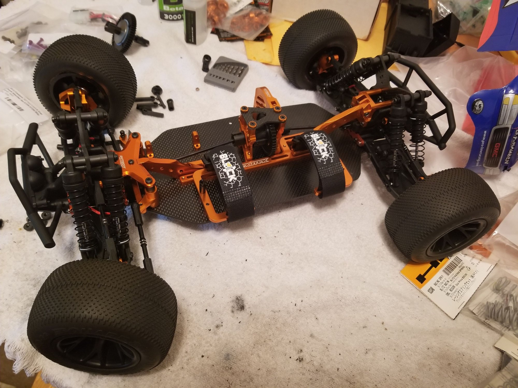

Those stadium-truck wheels and tires do look pretty good. The question is whether you can find a good stadium-truck body to put on it, though. The HPI Bullet bodies (even the Bullet ST body) just don't look quite right with stadium-truck wheels and tires.

Now that I've seen it, I actually like the look of the 2.2 sized tires. Definitely gets it a lot lower to the ground which will help tremendously with handling at the track.
