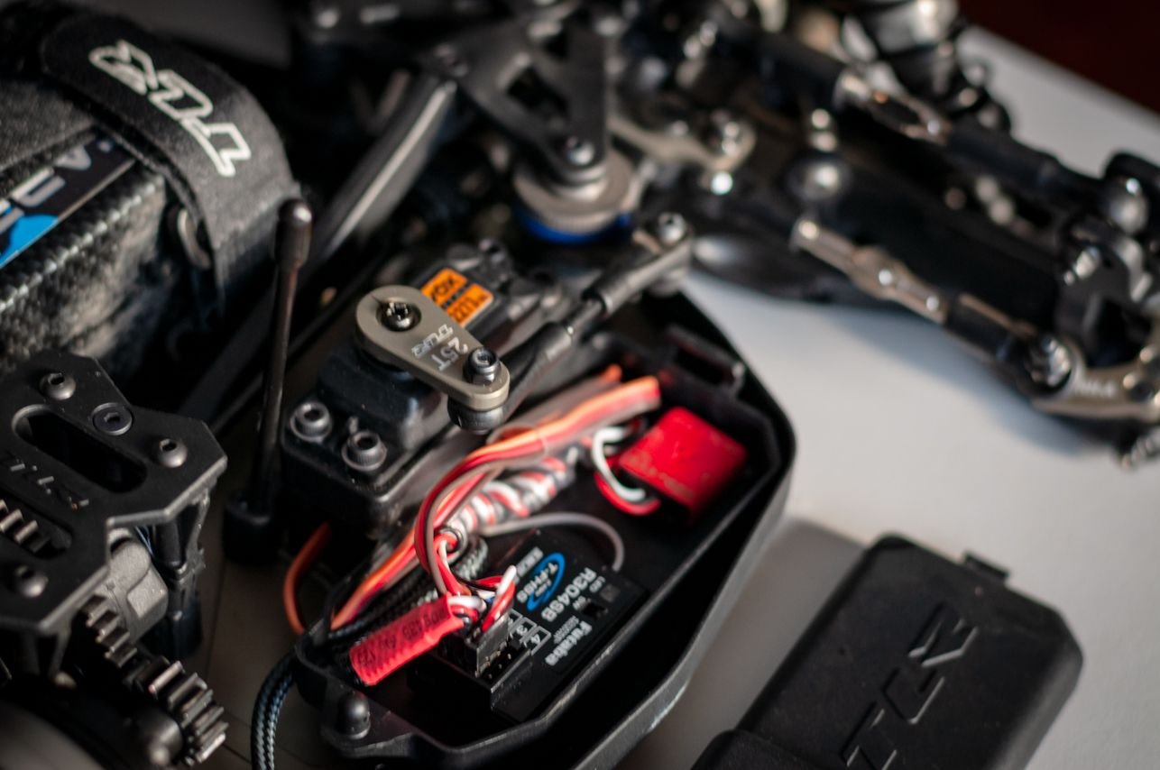

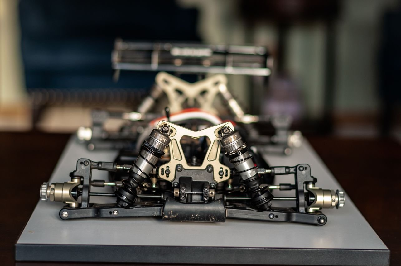

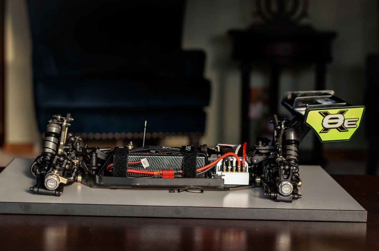

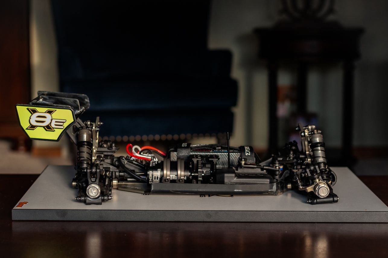

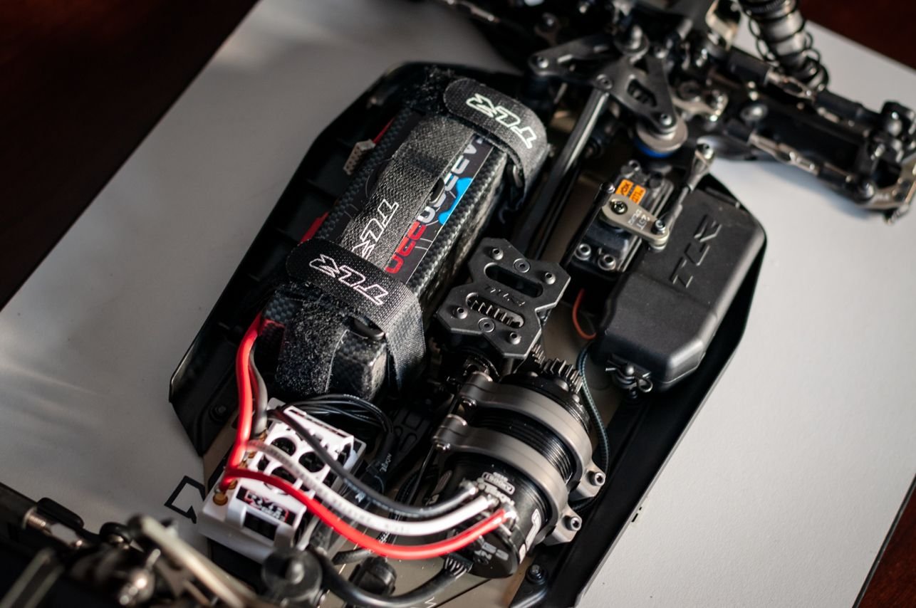

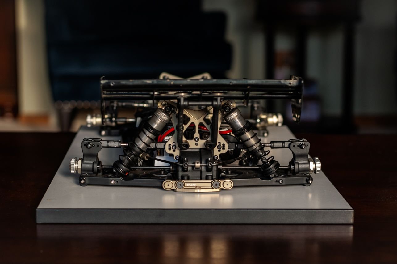

A few glamour shots before I inevitably break it and/or wreck the body at the Chi Town Shootout this month. I took a photo of the receiver box because it's really roomy in there, nice touch(yeah, I know, it came out blurry). After a couple days of use, the stock TLR pinion is starting to wear quite a bit... I ordered a 16t Robinson Racing pinion to replace it. I'm not that mad because the kit containing a 15t pinion in the first place was a pleasant surprise, and it seems like at my local track that's a bit short anyways. With a 12k throttle frequency and torque limited to 2 I still have more than enough giddyup to clear our large triple, and all the short run-ups to other jumps as well.
Fun fact: I bought this battery off a local here. Supposedly it was lent to Dakotah at a ROAR race some time ago. Maybe some skill will rub off on me.
Looking at the photos, a couple questions came to mind. First, how are the plastic carriers, steering knuckles & C-hubs holding up? And, is there any reason to consider getting the aluminum parts? On my Rustler 4x4, I swapped those plastic parts for aluminum ones, and am planning on doing the same for my other two project vehicles.
Second...and this is a bit more complicated...I'm currently running an RX8 & Pro4 3300kV (both Gen3) in my Rustler 4x4 (considering the same for my BackSlash project), and was initially considering doing the same with the 8ight-XE. However, another racer I know suggested the HW XR8 Plus & 3660 4300kV (I should mention that the local (indoor) track ONLY allows 2S, for ALL vehicles, so I can't go with the usual 1900kV & 4S configuration). In considering the XR8 Plus, the only difference I notice between the XR8 Plus, and XR8 SCT, is the first can handle up to 6S, and the latter handles up to 4S. Other than these two differences, are you aware of any other differences between the XR8 Plus & XR8 SCT? Getting back to the Tekin vs HW, what led you to go with Tekin? I don't mind the higher cost of Tekin...but, at the same time, I'd prefer to save some money, which might be put to other use on the 8ight-XE. Whichever I go with, I will be installing 5mm bullets between the ESC & motor, making it easy to switch between 4300kv & 2S, and 1900kV & 4S.

Thanks for the pics! Been waiting for someone to post decent pics of this thing.
