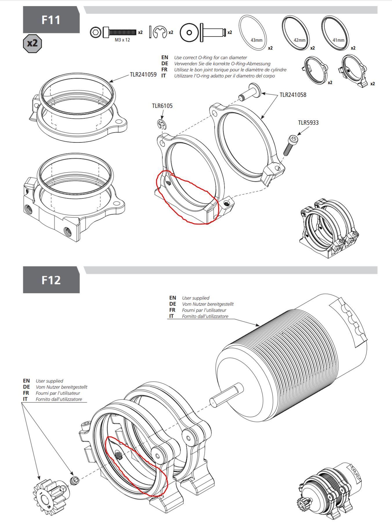

Actually, taking a look at it, it seems like there may be direct metal contact between the motor and lower half o the mount. You can see in the red circled potions that there is bare metal present on the mount behind the two clamping rings. The clamp design also pushes the motor can downward as pressure is applied. I wonder if the motor mount is designed in such a way that the can is pressed into the bare metal lower halves, with the o-rings on the two clamping rings being used for support and protection of the can at the mount is tightened? I suppose it depends on how "squishy" these o-rings are, and how much they insulate the can.
