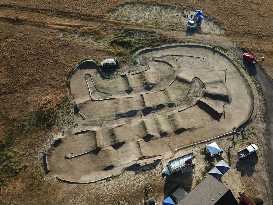

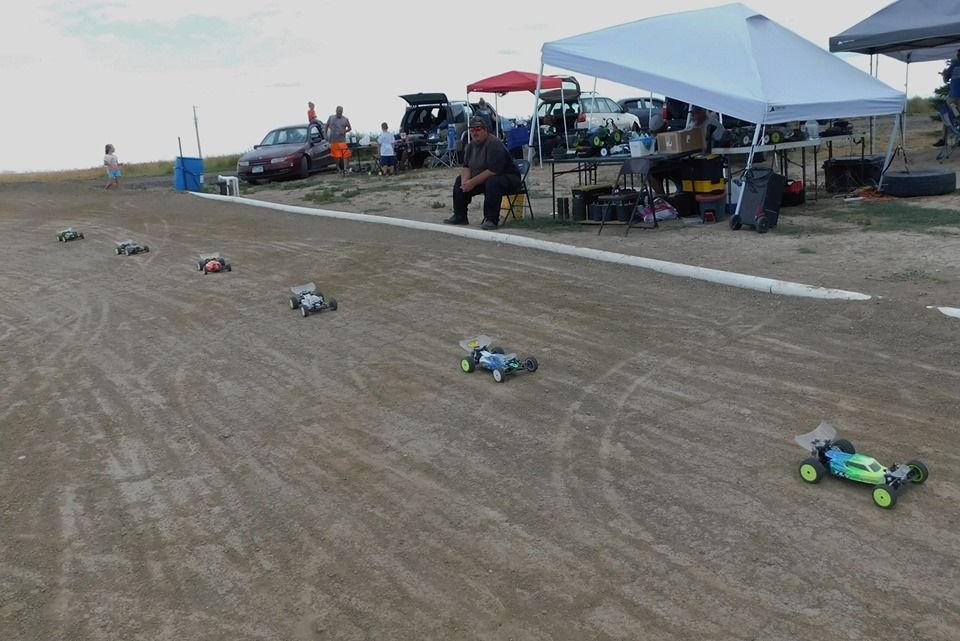

who races here on real dirt...outdoor?

Outdoor, real dirt, real roost, real fun!
