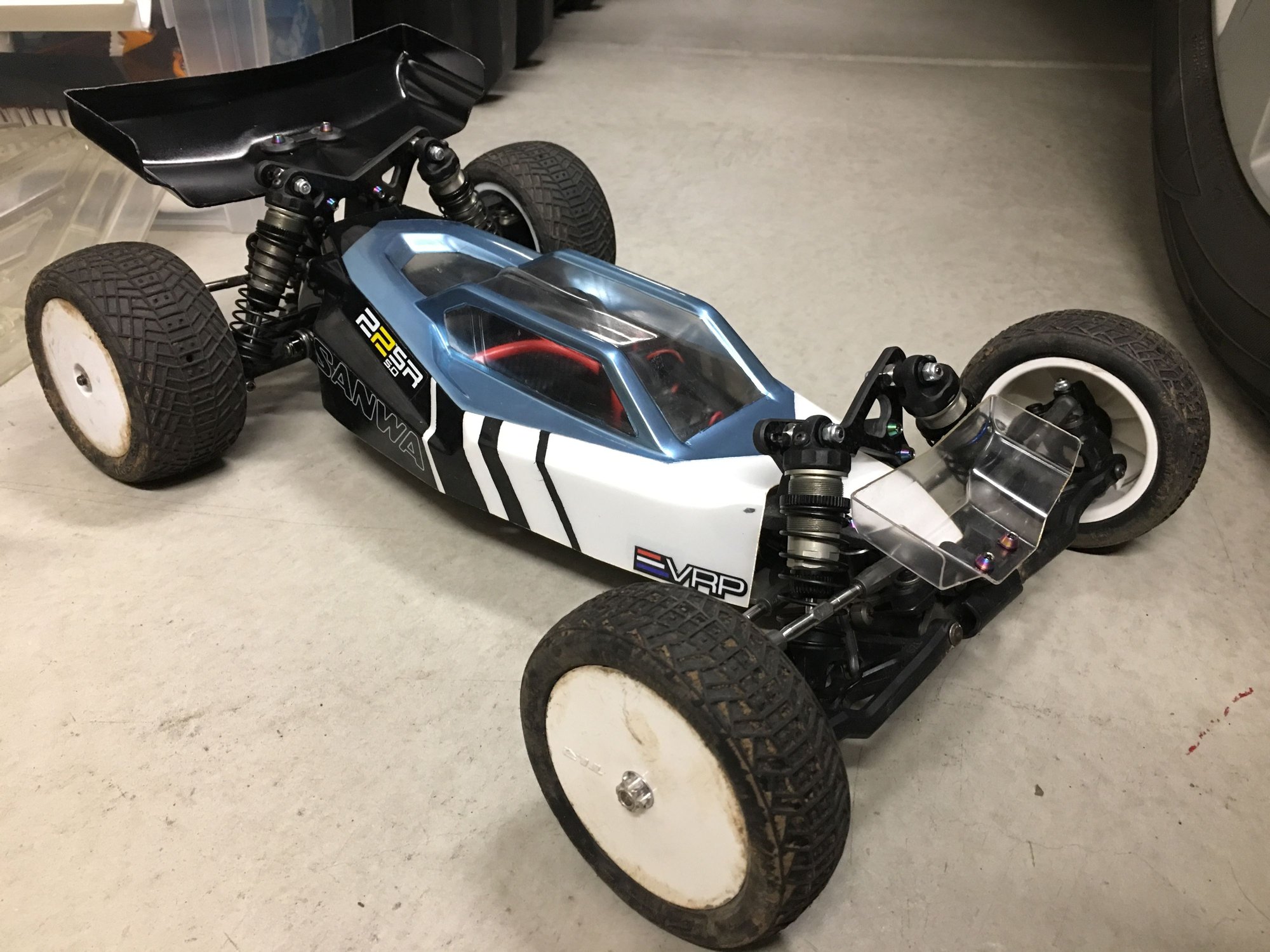

Don't have any issues with rod ends either. I decided to change things up. Switched the direct drive for a slipper, added +2mm towers, low front wing, new bearings, some titanium motor screws, and swaybars to see how they affect handling. I know buying option parts is unnecessary, but I love testing stuff out and tinkering at my desk

Just curious, but, have you had the chance to compare how the buggy handles, comparing the stock front wing vs no front wing vs low front wing, especially on dirt/clay? I've seen a couple people running the stock front wing (as I have), and some running without any front wing, but I haven't seen anyone (yet) running a low front wing.

Just installed the parts yesterday, so no chance to test yet
I figured Iíd try it out because I have a feeling the high front wing disrupts enough air flow to the rear wing to make a noticeable difference. Iíll see how it handles the fastest turns on the track. Another reason I got it is because it less of an eye sore and hopefully will last longer in the lower position.

Have you tried cutting the wings down some? Might have the most effect of all.

Going between the three I would say the lower front wing option is more aggressive overall in the low speed sections of the track, whereas, running the wing up high tends to give the car more predictability in high speed sections (i.e. sweepers, etc...). For the most part I always run a front wing indoors, but there has been circumstances outdoors on lower bite tracks that running neither has been better as it actually made the buggy easier to drive.
