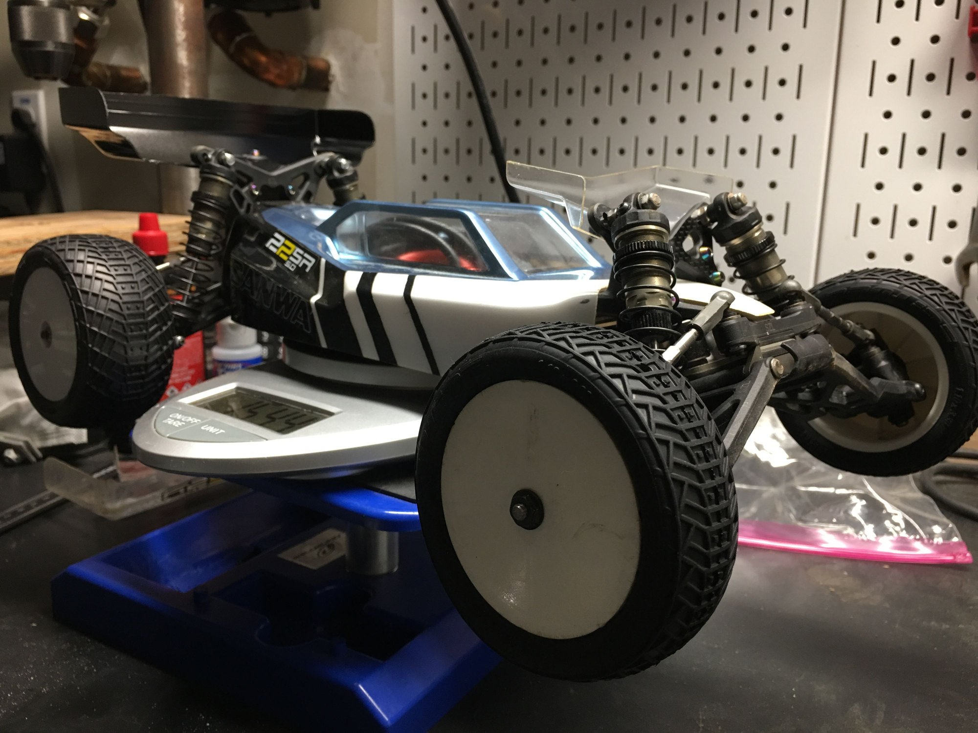

So now I can pretty much confirm that switching the outdrive to the DC outdrives fixed my problems with the thrust bearing losing lubrication. Also, I increased the stroke on the shocks all around, put the +2mm shock ends on the front for extra droop, and taller spring cups to compensate. Car feels perfect now and I can drive it a lot more aggressively.
