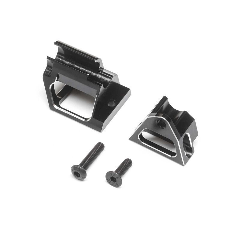

Any one know where this part is supposed to go on the car it just showed up on horizon hobby?

Im sure there will be an explanation for all the new parts on the 22 and 22X-4 very soon.
