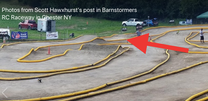

Speaking of shock oils... I'm running at a track that is rough man... rough. Not bashing rough, but it's got some ruts, it's very hard clay and there's a large double in the back people (and myself) were landing hard from. (Large as in - distance. If you aren't lined up, you're F-ed). I'm really considering thickening up the shock oil to 60/45, what do you all think and do you have any advice on set up for rough tracks? I don't want the center of gravity too high or I'll be traction rolling like crazy, but I also don't want to chassis slap the snot out of it either on that large double in the back stretch.
pretty cool, hopefully someone who knows will chime in. I was thinking of taking a ride to the Barn to check it out. Iím in CT.

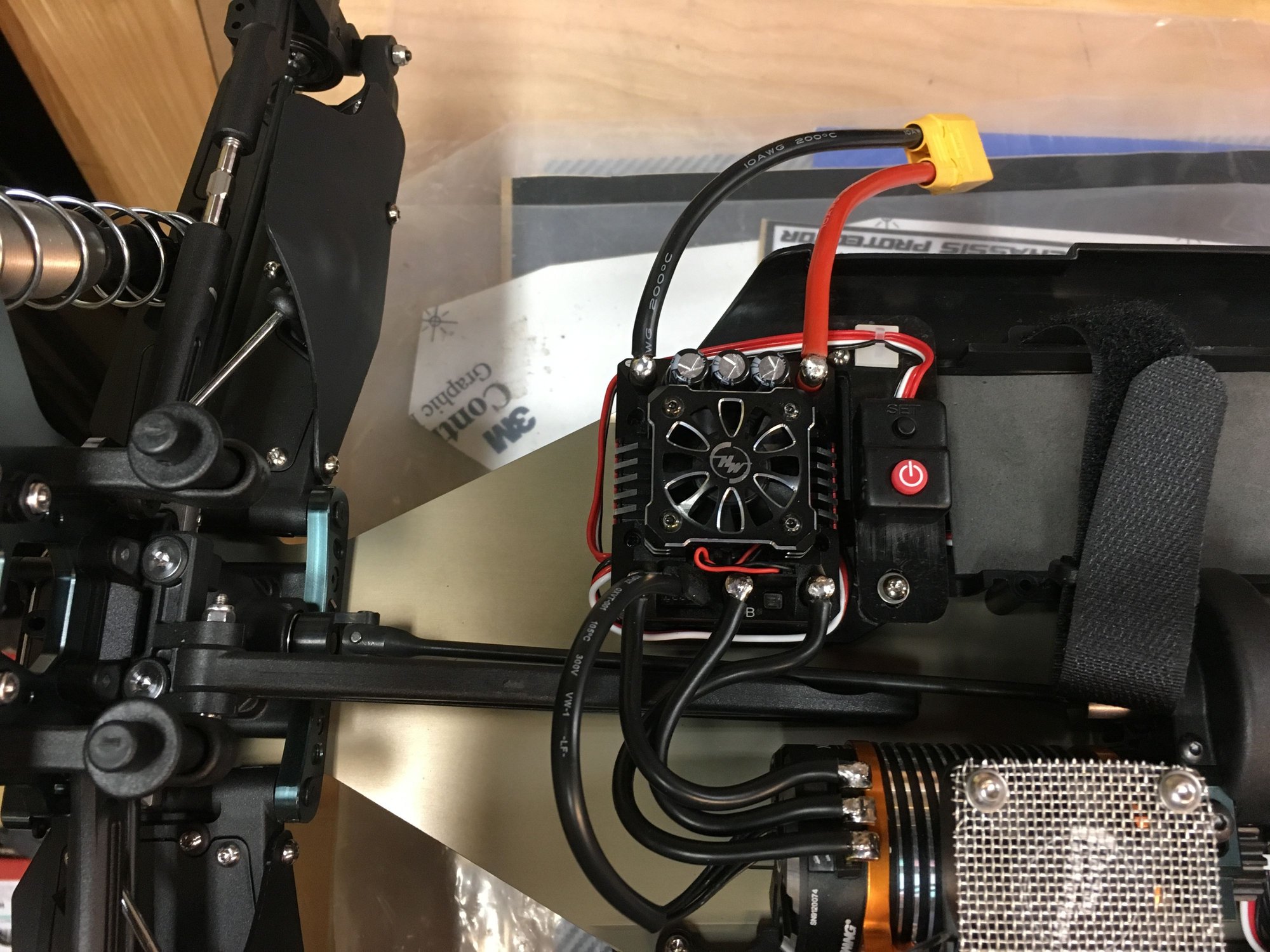

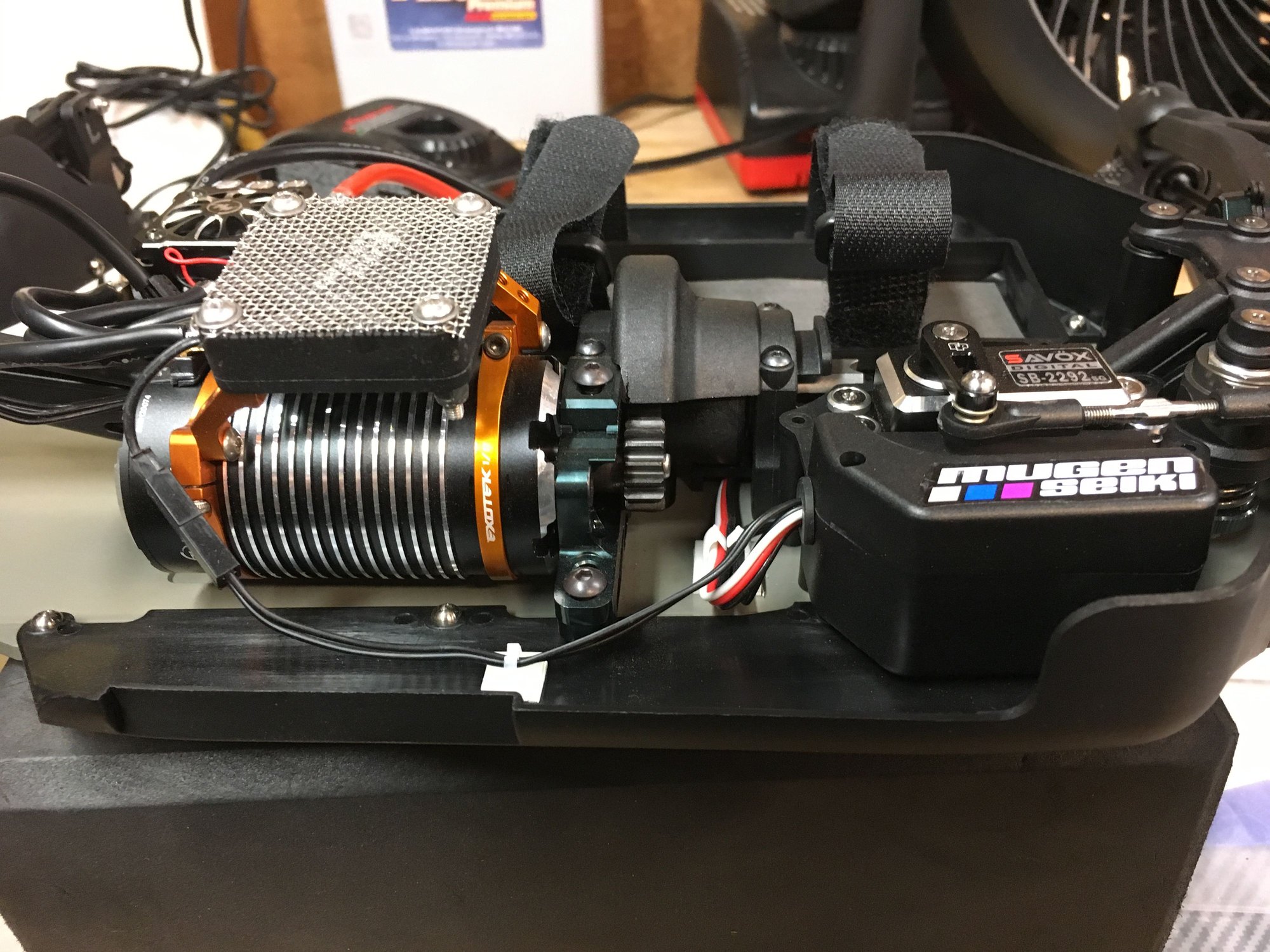

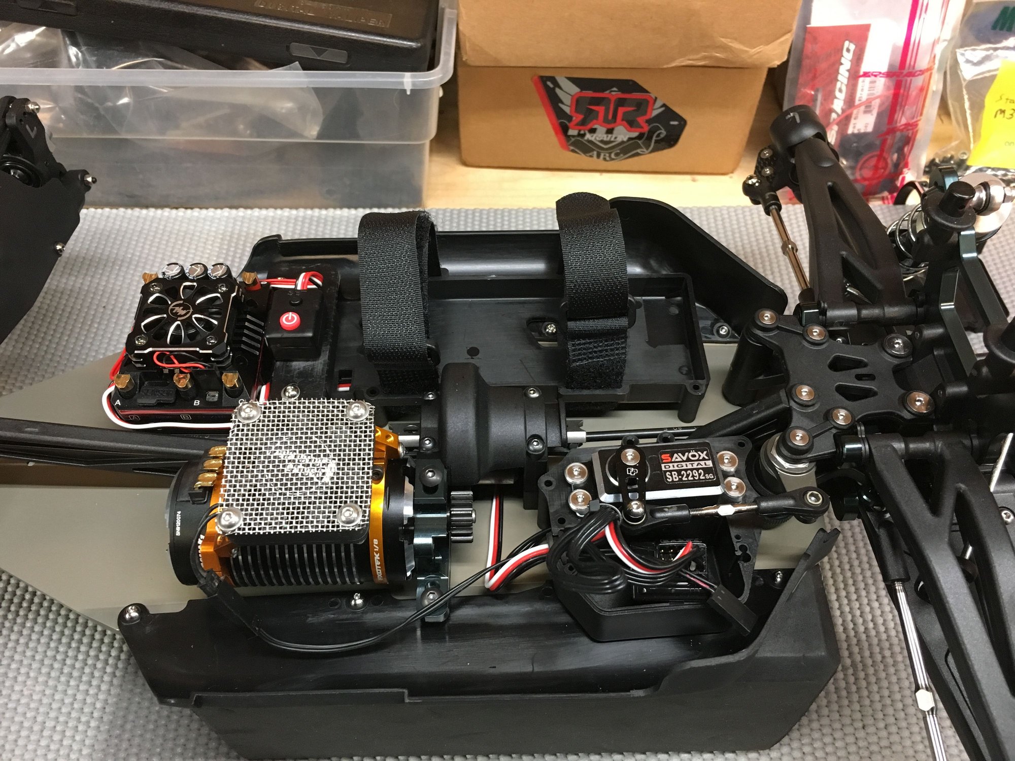

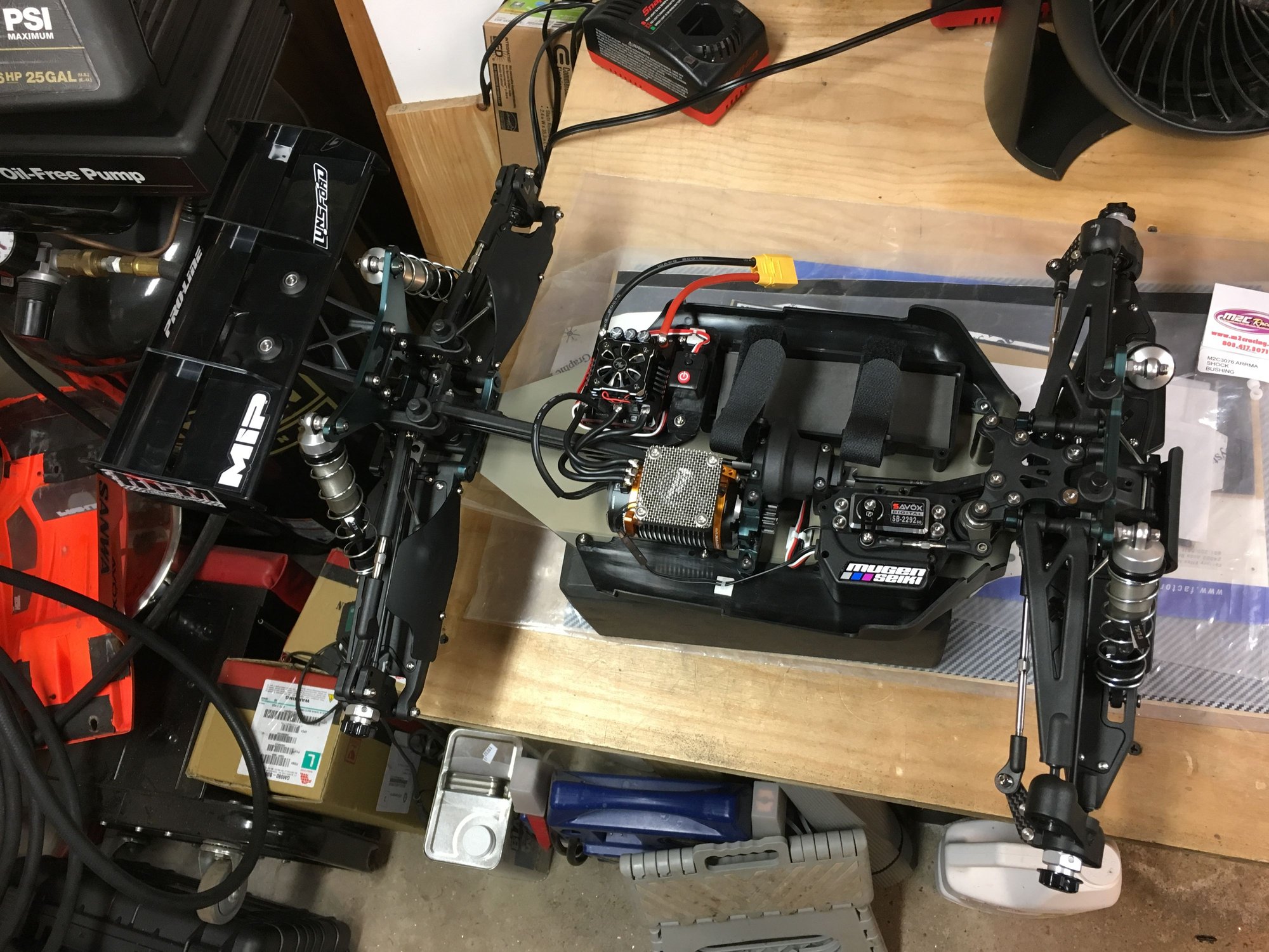

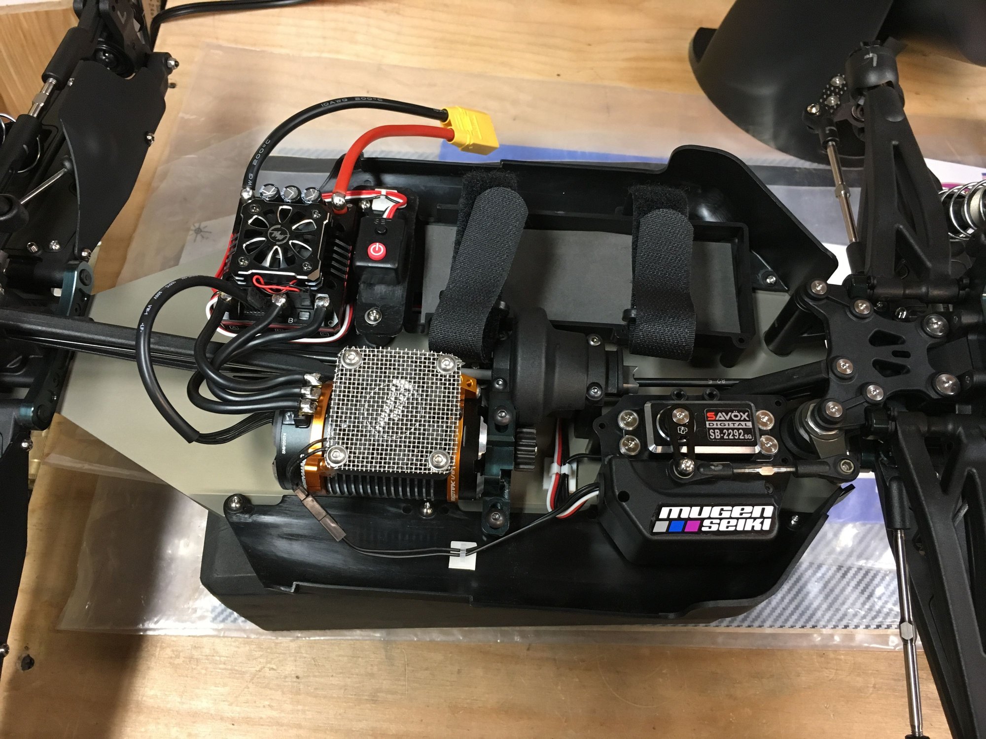

It went very well. Truly a well engineered kit. Got some good build and set up info from Adam Drake. Only a couple small issues. Broke a rear hub hinge pin, just snapped clean off as soon as it bottomed out. Luckily lhs had a set in stock, and then got a replacement set from Mugen. I tore a couple shock boots trying to stretch over the shock end, obviously my fault. Should have put on before the shock end, or taken back off to put on boots. Again lhs had a set in stock. Made a small plate to hold my esc switch. Just waiting to get the body painted.
dms70 is offline

what fan is that?
Cain is offline
Old 10-04-2019, 07:12 PM
  #88
dms70's Avatar
Join Date: Dec 2018
Location: CT
Posts: 58
The fan is a 40mm Yokomo, 2 exotek mount clamps, and some stainless mesh.
