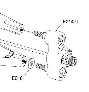

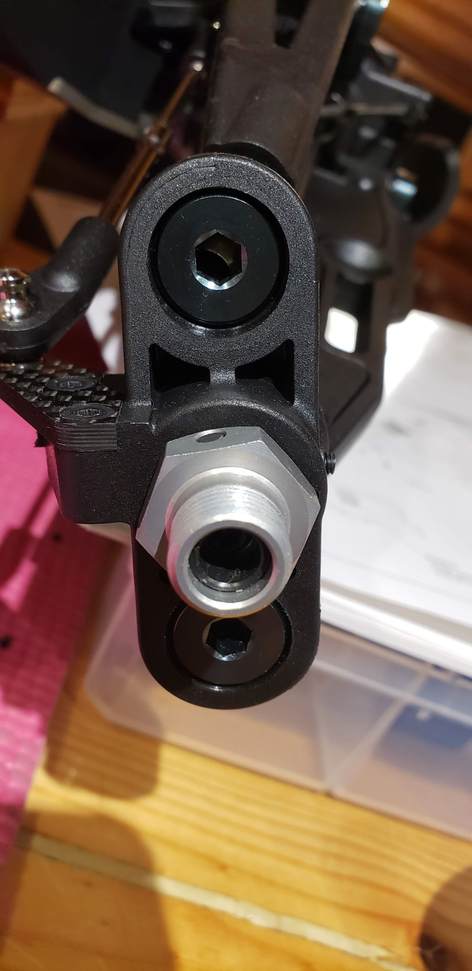

I'm curious, can you confirm the front uprights are the non-trailing E2146 Front Upright​​​​​​s? The manual says different, but I'm reading otherwise.
i will have a look tonight but my manual list the part as E2146 which is the non-trailing.. E2147 is trailing option part..
That's good to know. They must have made a change in the manual they include with the shipping truggy's. This is what I found in the manual online.
I prefer the non-trailing, just wanted to make sure I didn't need to buy another set before my build.
Unfortunately Fed-Ex is delayed, was supposed to get it today, now delivery time is tomorrow. boo
heh, i just noticed the online version and printed show both 2146 and 2147 on the same page (page 8), must have been missed in proofreading..
at any rate, if the non trailing are horizontally centered on the pillow ball holes then that's what they are shipping in the kit
t
