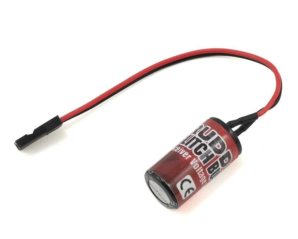

Does the car do the same thing if the car is on a stand? Under hard acceleration the BEC from the speed control might not provide enough current to the receiver, which could cause a lot of issues like you describe. You can try adding a glitch buster capacitor to an open channel on the receiver.
Or you can add a stand alone BEC like this or get a new esc with a stronger BEC.
