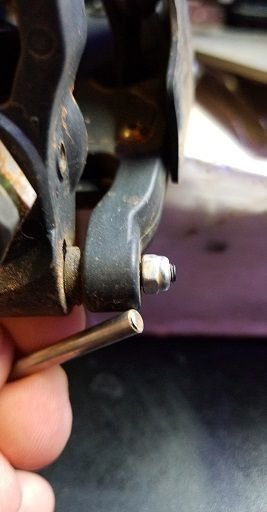

A better driving car this race. But, upon tearing the car down, I can see there is still room for improvement on friction and bind.
1.) I broke the rear hub pin, the threaded part. A sponsored Mugen guy, Jody, said he has been chatting with Drake about it. Apparently it is an issue they are working on. For now, tighten and then back it off a quarter turn. This seems to help as per Adam Drake.
2.) I noticed was my arms got tight again! I did not ream them out enough and just a bit of dirt can cause binding. I re-reamed, and polished the pins. (chuck into drill and used a rag with polish paste.) Hopefully this will also help with binding. Polishing them really made them slick. Another tip I got was to get the pins to basically fall through the arms. That's a good way to judge how much to ream.
3.) Seeing has how much polishing the front arm pins helped. I am going to polish all the pins on the car and also the shock shafts.
