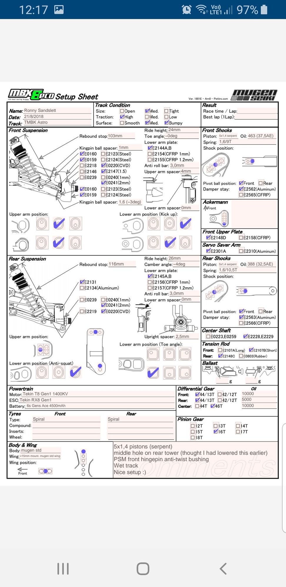

Old Today, 03:44 AM
  #246
ronsand's Avatar
Join Date: May 2009
Location: Tromso, Norway
Posts: 431
Here is my current set up that works really well on our astro track. I have also received the VRP 6x1.3 game changer pistons and plan to test them in the near future. 😀
