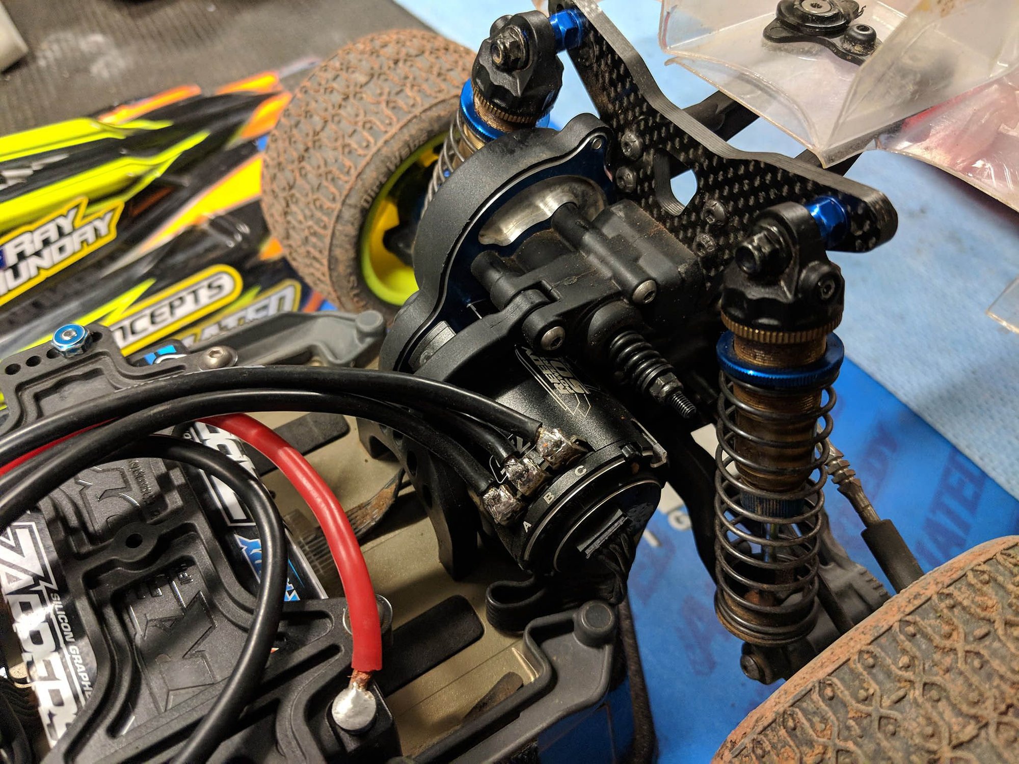

im in the process of putting in the three gear stand up - the case comes with a spacer which I assume I need to fit as the tower wonít align other wise as it fouls on the gearbox housing but are you still able to run shocks on the front as the tower is now overhanging the rear mount position.
Anyone have any pictures with front mounted shocks on stand up?
I would assume so because the b6.1 guys have been doing it like that. Here's a picture of how it is on Ray Munday's car. It should work the same for the sc6.1.

id already seen that but itís the sc6.1 tower is a different shape so wonít clear the motor plate properly. Donít want to dremmel the tower as it will weaken it to near the mount hole so Iíll have to use spacers and longer bolts when I can grab some to run shocks on the front.

I was able to mount the tower with just a little filing on the tower for both the 3 gear and 4 dear stand ups. I have my T and SC since last june and never broke the tower.

I did this to my SC6.1. To make the stand up tranny work you ether have to cut the shock tower of motor mount. I cut the motor mount.

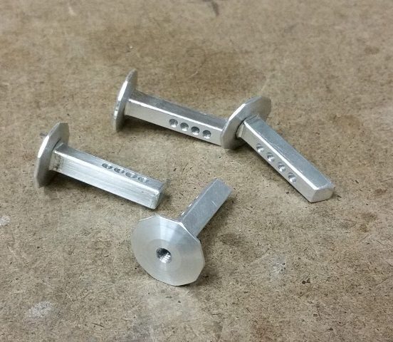

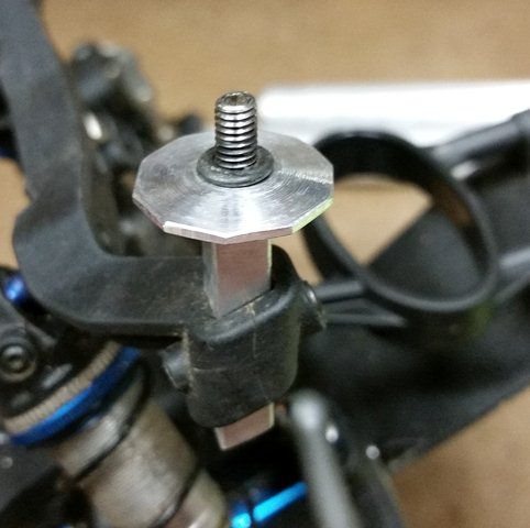

These are front and rear body post for a RC10SC6.1 made from bullet aluminum 6061 machine to fit in your rig. They are setup to be use with the Proline thumb screws. They do not come with the thumb screws but will have the proper set screw Loctite in place.
I’m selling for $25.00 a pair, front or rear or $45.00 for set (front and rear) These prices include shipping to US only
Message me for payment info.
I will be working on a set of stock posts for the pin style.

those look great. How much test time do you have on these? Just wondering if you have bent them?

My son and I have had them on for a few weeks now with no issues. I have had a few bad crashes to and no signs of being bent.
