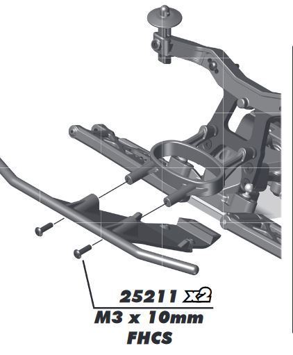

FYI - The front bumper holds up incredibly better if you utilize two longer screws in the front loading position. 10mm screws leave way too much flex in that piece and it ultimately crushes downward and sags, which in turn causes the lower part of the front bumper to bow. I had some 16mm screws around and they are about the perfect length; you could maybe even go 18mm... a 20mm screw might be too long but I haven't tried that size. The longer screws leave just a touch of give but the piece won't crush in and down any longer.
I'm pretty new to SC still and with little tweaking, I've got my SC6.1 in a great starting point that is easy to drive, turns and jumps well. Box setup with gray front springs, white rear springs, and front sway bar.
Very nice find...
Yeah those connecting points do buckle right where the short screw ends it's support.
