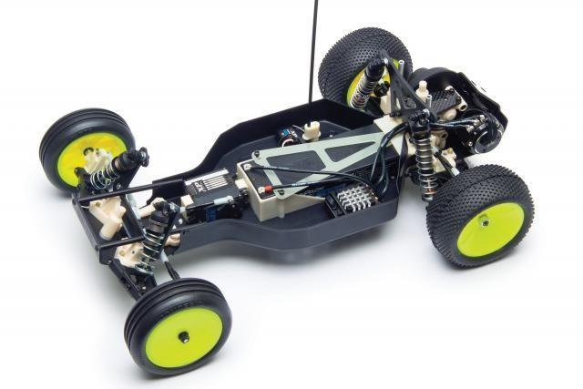

Is it the front or rear your having trouble with? AE has both in stock and the battery strap for the re-release car. They maybe wider as the PR shots show a LiPo in the car. (Don't run a LiPo with the MSC!)
Give them a ring or drop them a email to ask.
https://www.teamassociated.com/contact/
Here are the parts I found:
https://www.teamassociated.com/parts...rear_bulkhead/ In stock
https://www.teamassociated.com/parts...0_battery_cup/ In stock
https://www.teamassociated.com/parts...battery_strap/ Low Inventory!
Full parts page:
https://www.teamassociated.com/cars_...s_accessories/
Hope this helps. And don't pay attention to the those saying go brush less right now, worry about that after the MSC dies. *And do some updating to the trans before putting anything to wild in it.*
From AE's Site.
https://www.teamassociated.com/cars_...WC/Worlds_Car/
The RC10 World's Car buggy is the pinnacle of vintage RC10 buggy performance. The replica features modern-era upgrades while retaining the spirit of the original RC10 World's car that crowned Brian Kinwald as 2WD I.F.M.A.R. World Champion in 1993.
The new World's Car is equipped with updated V2 hard-anodized threaded shock bodies and aluminum adjustment collars to provide improved performance and adjustability.
*The drivetrain now features the famous Stealth 3-gear transmission with a ball differential, CVA axles and V2 slipper to harness the power of modern brushless motors. A new durable plastic gear cover was added to protect the V2 slipper and gears.* The included 2.2" wheels fit current 2WD buggy tires so racers can select the right tire for their track.
The RC10 World's Car kit updates make the buggy easier to build and service without altering the authentic look of the original car. The black hard-anodized machined chassis, trimmed front kick-up plate, black motor mount, and nose brace tubes look like the original parts.
Some plastic parts have been updated to improve durability, accept modern batteries and components, or increase performance. Color matched with the original World's car kits, these parts are backwards compatible with original cars.
Take a journey through time and drive a Team Associated RC10 World's Car -- it's worlds better now than it was back then!
