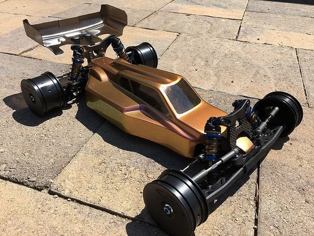

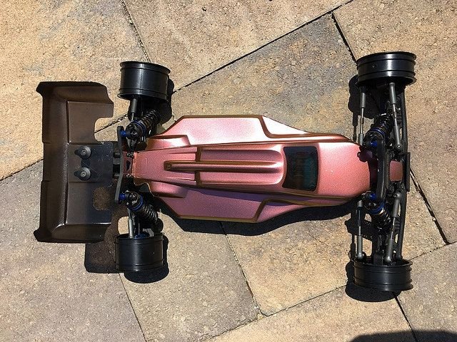

My build is finally coming to an end. This is my first experience building a kit, and I thoroughly enjoyed the process. Instructions were clear, everything went together seamlessly, and it looks like a pretty easy vehicle to service.
My last issue/question is, how do you guys that run indoor clay vent your wheels? Do you make holes in the rim, the tire, or both? I really want to get it right on the first try, thanks! Here's pics of how it turned out:

It comes with this helpful sheet. The holes are all on the same horizontal plane, they simply change how close or far the ballstud is from the wheel, affecting camber gain. If you want to raise the link you need to use spacers like ballstud washers. Note that if you want to mount the ballstud low then you need a 4mm ballstud which doesn't come in the kit. I use 8mm ballstuds with the battery thumbscrews as spacers (and put the 10mm ballstuds on the aluminum piece of the chassis). I'm still learning what setup is most desirable, but I know these adjustments affect the roll center and camber gain.
