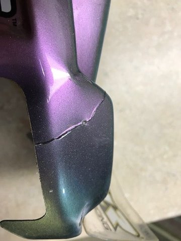

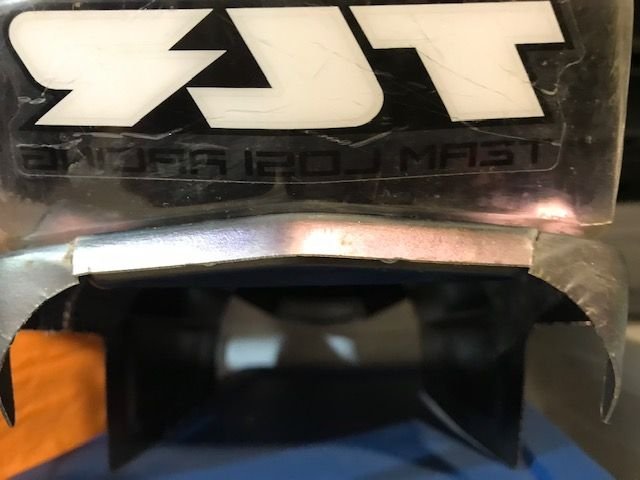

Default 22T 4.0 Body Cracking
I received the body with this truck I purchased. Is this pretty normal for it to crack in the rear end like this (both sides cracked the same)? I know, don't crash, but that's not going to stop happening. Is reinforcing that area the only choice to help prevent it from cracking? Does someone make a better body?
Thanks for any help.

“Better” is too subjective to answer but I’ve had most of my 3.0/4.0 T bodies eventually crack in that area. Yes, you can reinforce (fiber mesh with shoe goo, gorilla tape, zipties and others) to get more use out of the body before you have to trash it but of course it will add weight, higher up and in the rear. Using without the wing might cause less damage but just will have to make sure it doesn’t negatively affect setup/driving for your track. Alternatively, can always cut off the back and go truggy style with a buggy wing and mount (re-purposed one of my broken 22T 4.0 bodies to use on my 1/10 truggy).
