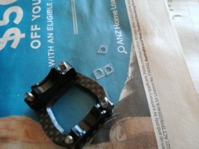

I tried tape and then decided to cut out some small plastic shims out of a takeaway food container lid. It's probably no more than .50mm in thickness. Used a body reamer to make a bunch of holes in the plastic lid, and then cut out the little shims. Seems to work a treat. Noticeably helped the dragging on the center diff. Thanks for the tip! Now I can fully snug down the top screws on the carbon plate over the spur gear without much drag on the center diff. Sounds like not everyone has this issue, but this might be helpful for some who do.
Cheers!
sounds good!!! I like it
