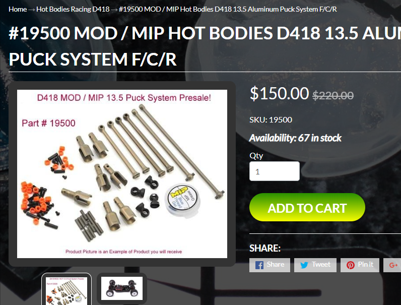

Looks like a few more of us have commited to this - would love to see it happen - MIP Puck system for the D418! Why let all the B64 and Tekno owners have the fun with their hop-ups? The # in stock for the pre-sale needs to get down to 0 for the puck system to go into production.

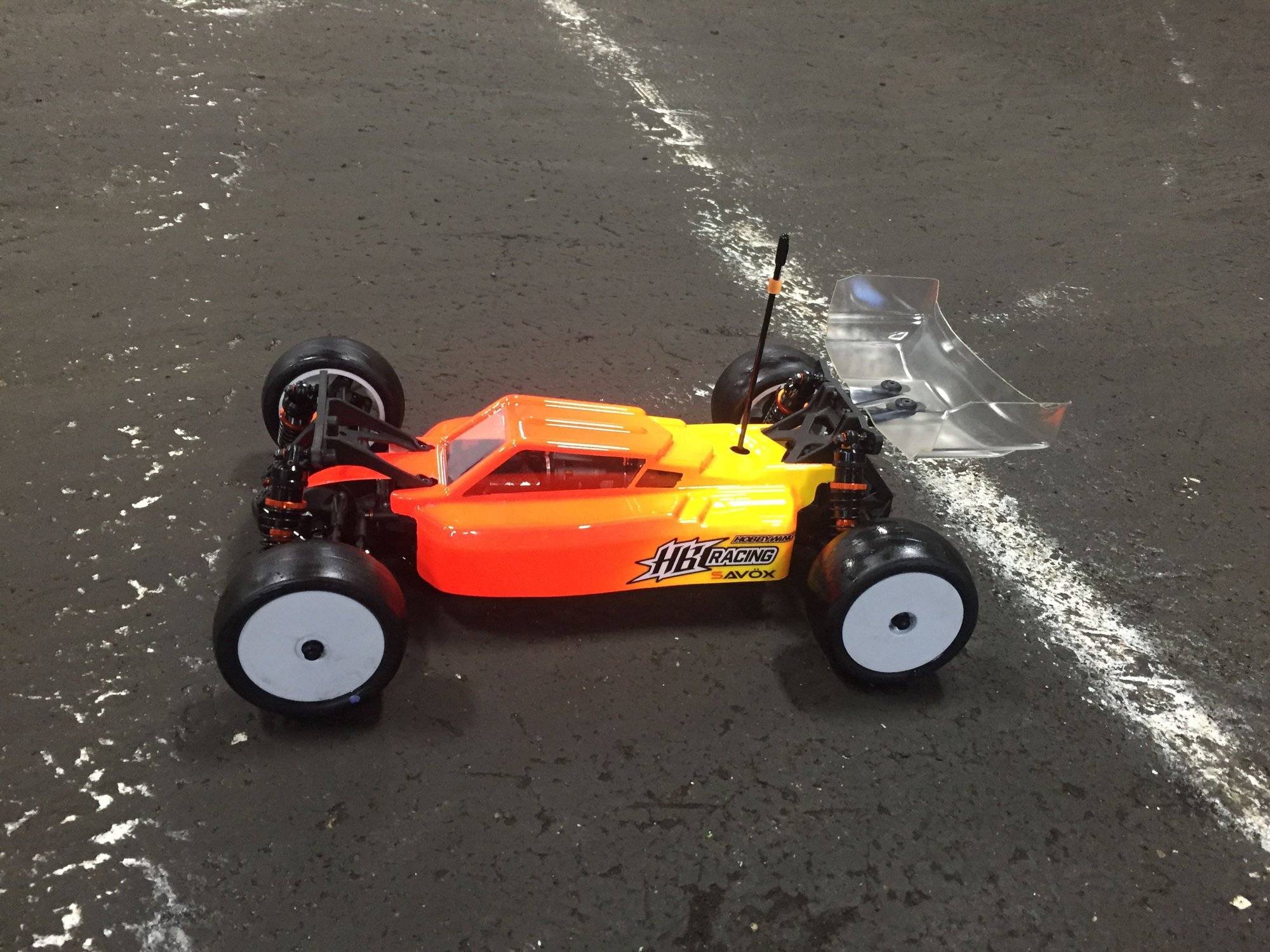

Hereís mine on the first run

Is there a link for this? It wont come up in the seach on the MIP website. Or google.

https://modspeedshop.com/collections...k-system-f-c-r
It's being sold under MOD (Matt Olson Designs) - a spin-off business from the main MIP brand. Matt Olson is a MIP racer/employee who's putting out his own brand of MIP products (got this info from the website and the Facebook page for MOD. Its still authentic MIP gear.
