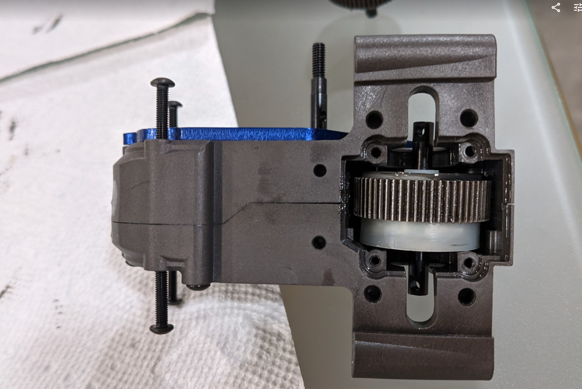

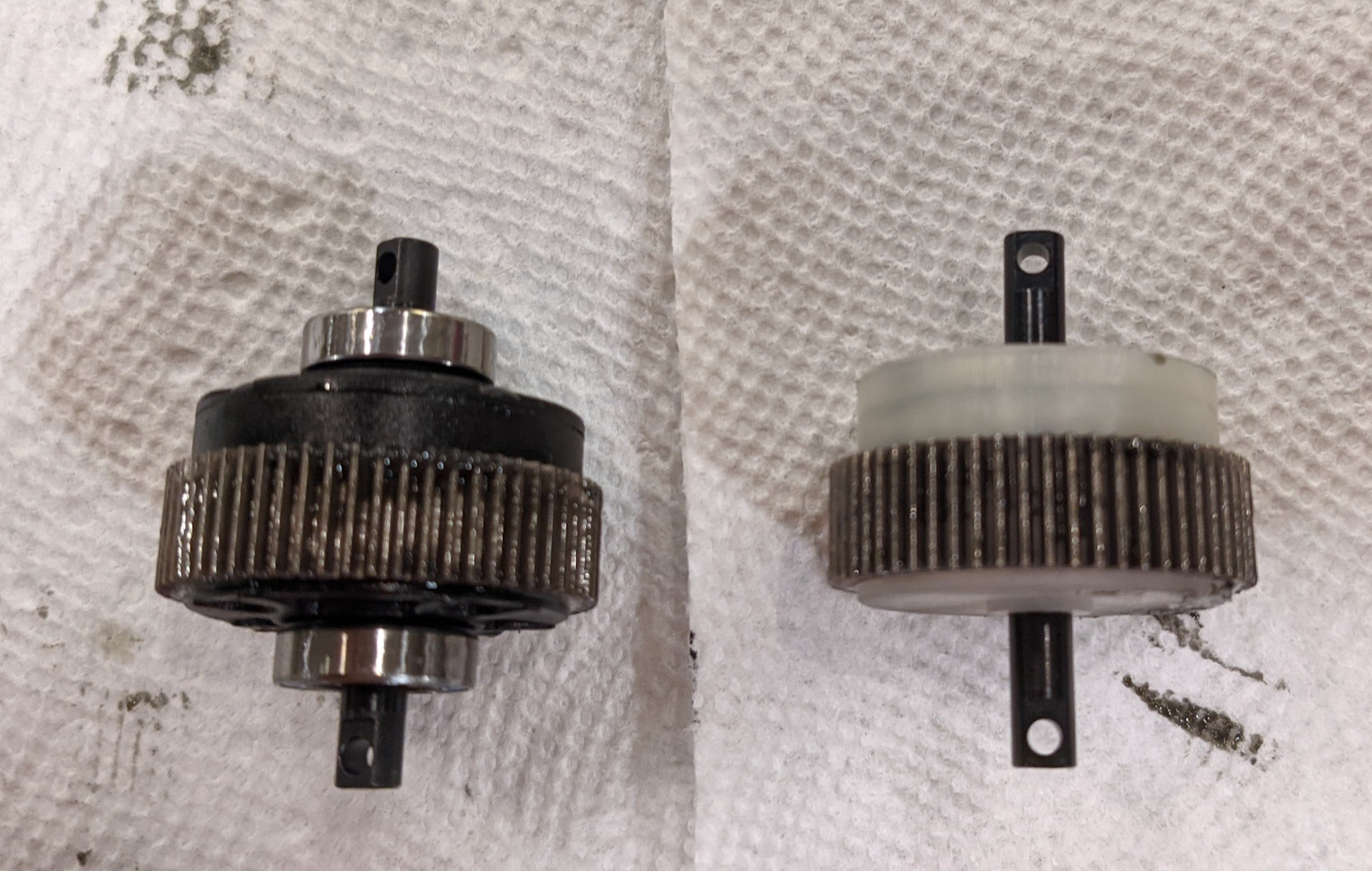

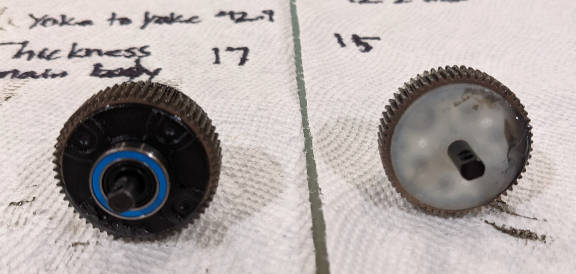

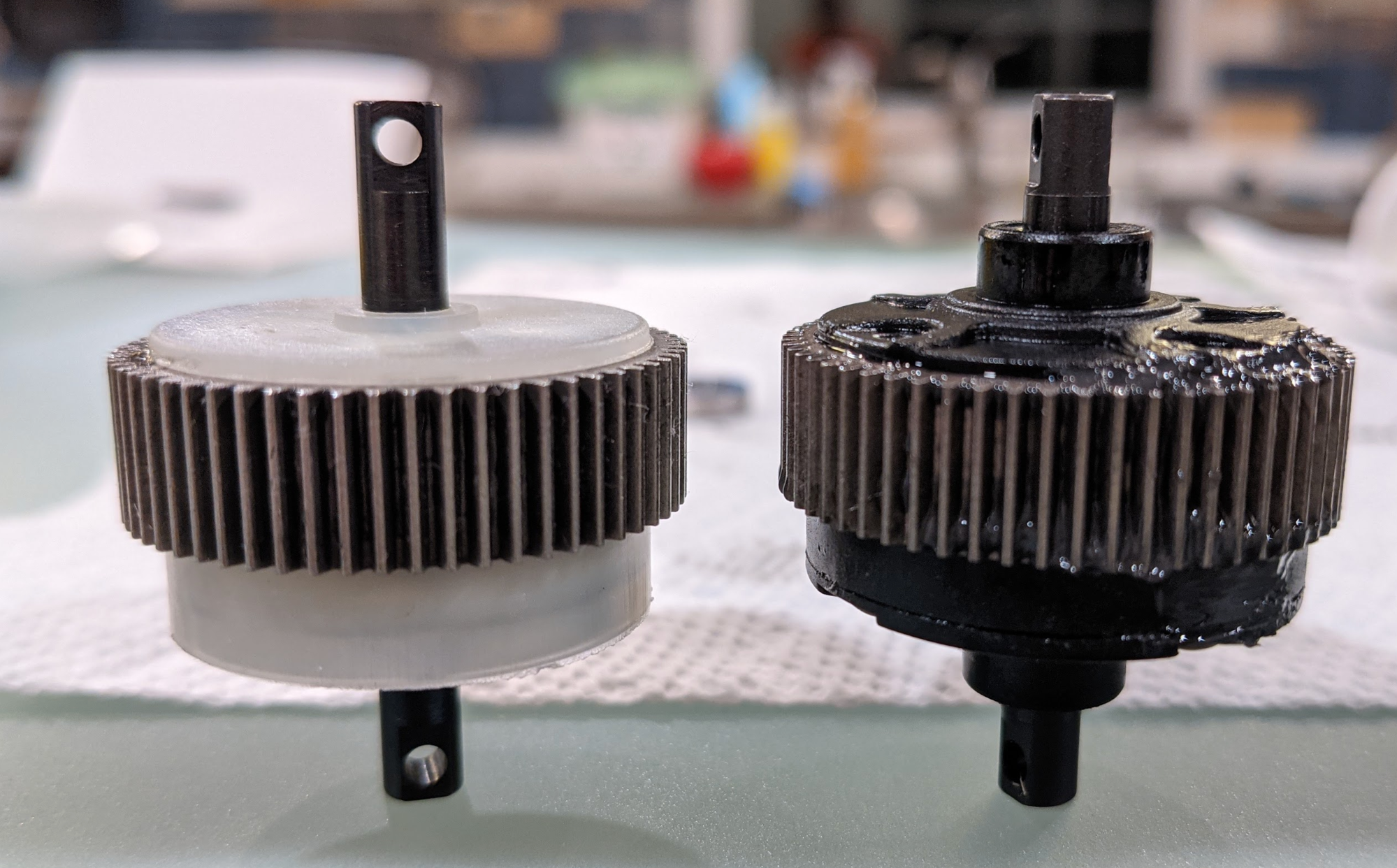

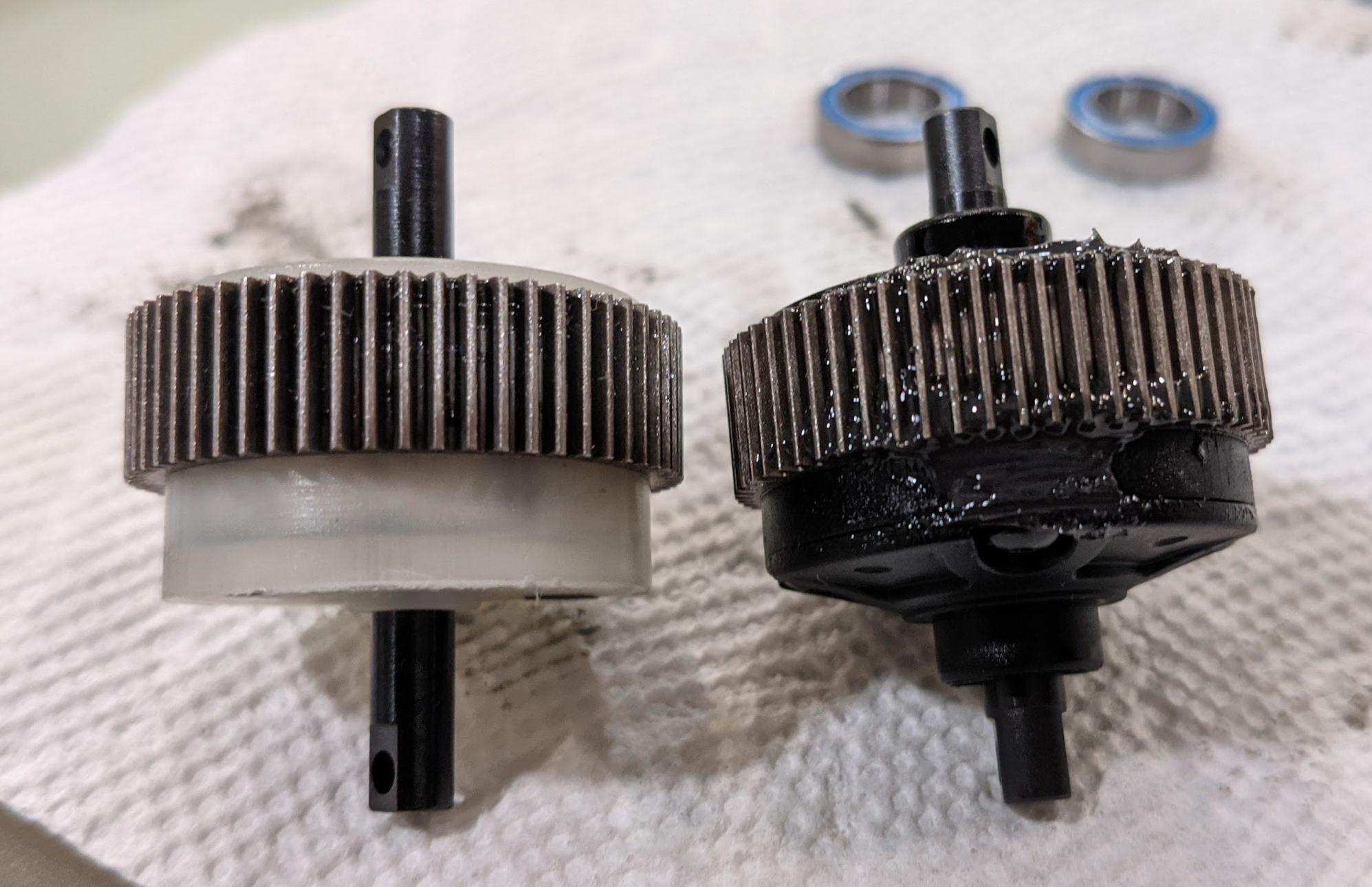

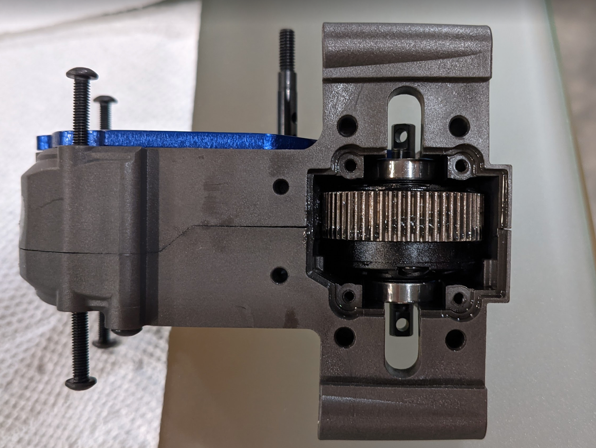

Here are some pics which might help you assess the situation (the black diff is the new one, the white diff is the old one).
The measurements I took were:
diameter: old 32.75mm, new 32.7
yoke to yoke: old 42.4mm, new 42.9
Thickness from top cover to bottom cover: old 15mm, new 17mm
Note that my measurements definitely had inaccuracy, probably upwards of 1mm.
I also tested the old and the new diffs in the new case. The old diff rotates smoothly but of course has the wrong bearings on the output yoke and doesn't get locked into place in the new gearbox. The new diff has 15mm outside diameter bearings vs 11mm for the old diff, so there's a major issue there in terms of fitting into gearboxes designed for the old diff.
