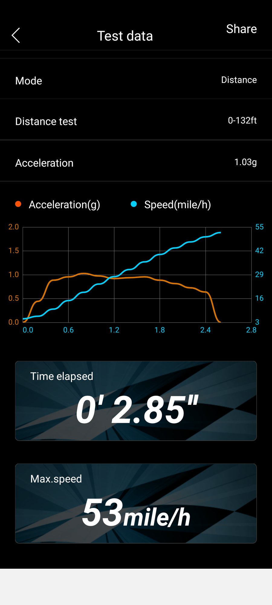

Lastest GPS Data for Demon.
DR10
Timmahh likes this.

Test and tuning Demon.
Timmahh likes this.
