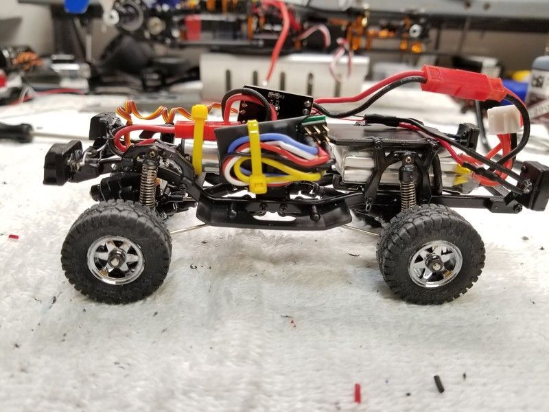

My battery is much smaller than the one you have, mine's a lipo. I can't take the case off my rx it has a built in antenna and it's on a little pcb board that in the top half of the case. Wasn't real happy with my radio so today I bought a Tactic TXX300. On mine I did remove the normal rx plugs and covered the pins with color coded heat shrink to safe some room. My motor/gearbox actually has little tabs on it that will hold the rx on 1 side and the rx on the other. Would just need to insulate the back so that there wouldn't be a chance to short against the motor.
Mine works the way it is but the wiring for the rx touches the roof. Like you said by putting the boards standing upright by the motor will also help lower the CG.

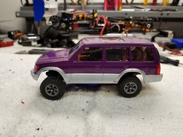

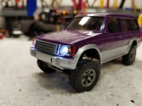

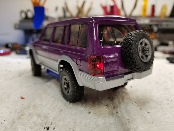

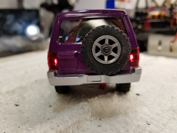

Had a warm spell so I was able to put some paint on the bottom of the body. While the paint was dry
ing I installed the lights. Didn't even try using the small SMD LEDs that came with the Pajero. I got some 3mm red LEDs off eBay and they worked well. Wired the lights to a 1s lipo to test them out. Waiting for a new rx so I can relocate the electronics to a lower position. Currently the plugs for the rx hit the roof with the body on. Works but I want to lower the CG too.

I used to have problem soldering those tiny microscopic SMD Led supplied in orlandoo took me huge leap of faith to solder those. Nice silver paint on the lower Pajero body.

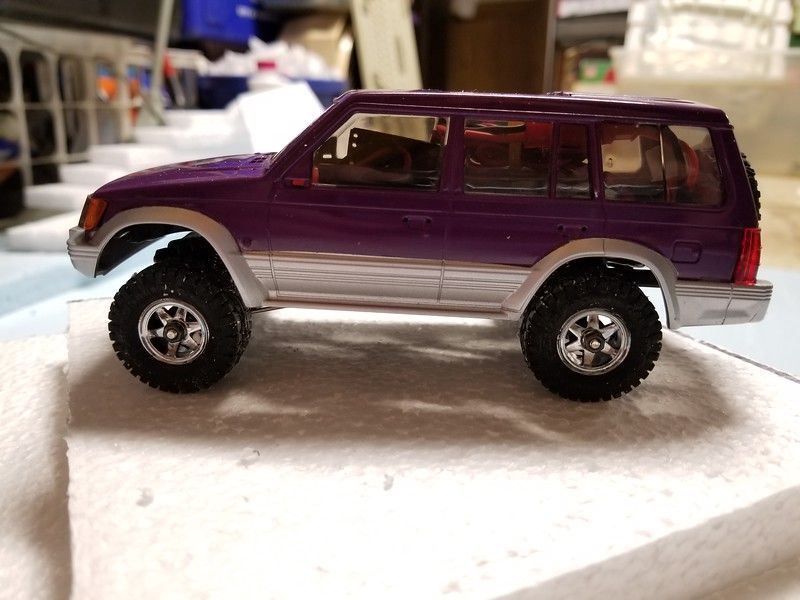

Ordered some new tires and wheels. The tires are what Orlandoo calls Big Blocks and you and see they are wider than the stock tire.
Also got some chrome wheels, look much better than the stock wheels.
The Big Block tires are much wider than stock.

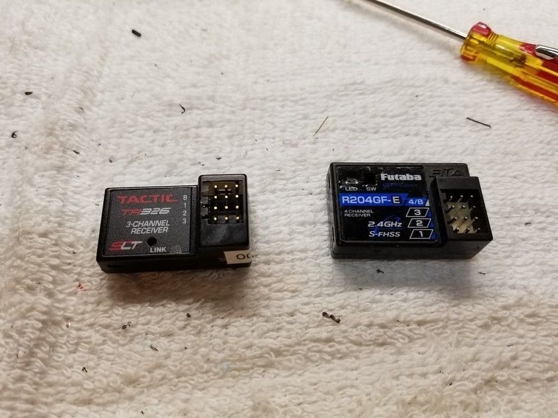

Wanted a separate controller so I ordered a Tatic TXX300 which has a nice small 3 channel rx plus I save around of 3g of weight. I removed the case to save even more weight and make it easier to mount.
Mounted the rx & esc on edge next to motor to help lower the cg.
Wired the lights too while I was working on it.
Now I have to get to work on the crawling track. Gets pretty boring crawling over the keyboard.
Gramps50 is offline

Hmm.., your new tires do look big and knobby. Wonder if you could published a video how does the tyres perform vs stock. Btw it should have enough room to put some anchor weight around the radials (wheel weight ring) to get more weight pushing down the tyre for extra grip and CG. I haven't done that but i might try to wrap heavy wire around the rims within tire wall this weekend.
Yes, its about time you should start do that, once done you'll i'm sure you'll ended up whole collection of orlandoos. Have track, have trucks.
