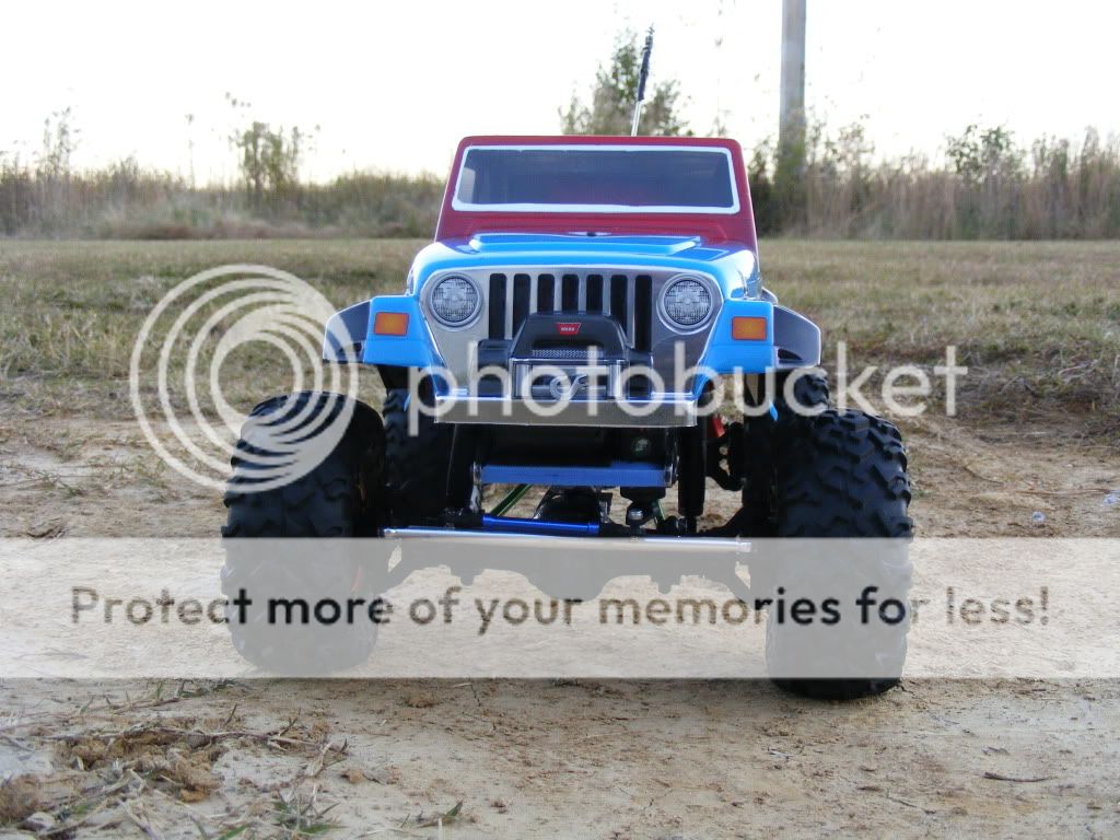

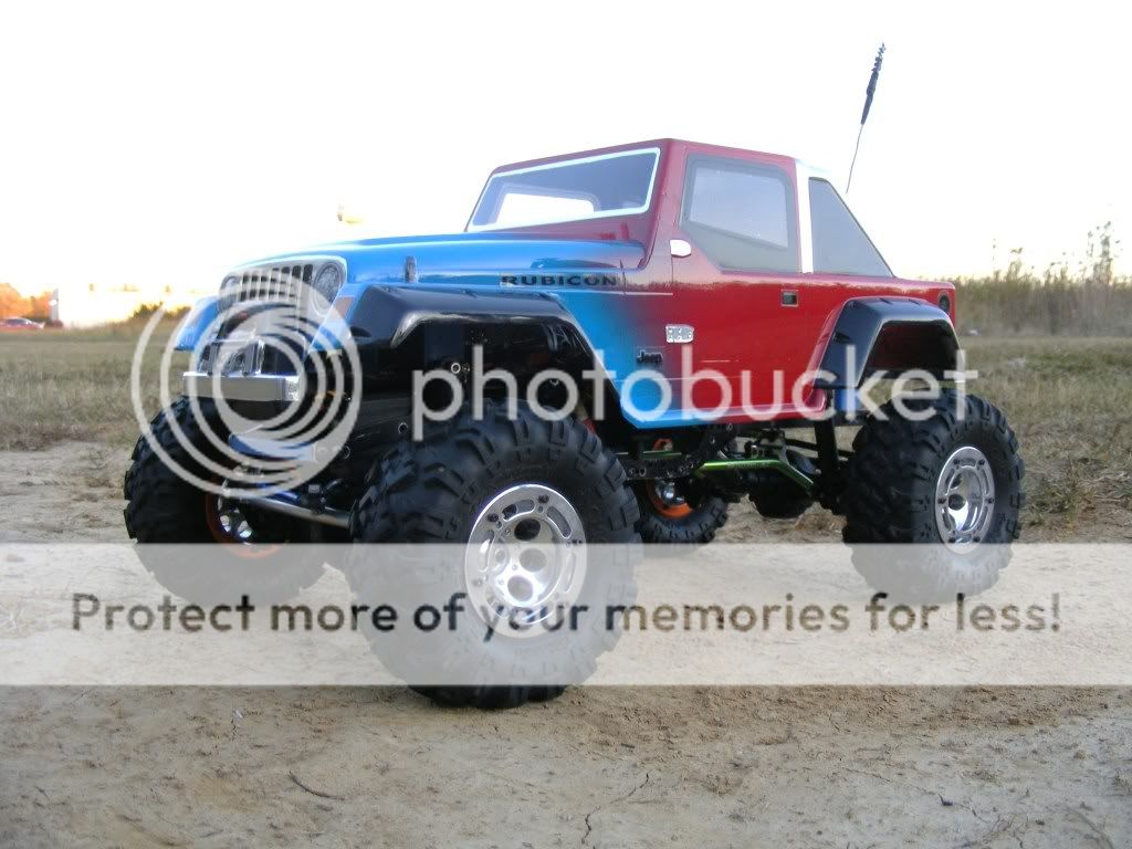

I have a WK with the TCS crawlers X trail chassis. I used the stock axial links. I did have to make a new skid. I mounted the tranny sideways with a clocked motor plate. Running shocks in droop. Chassis mounted servo.
You can basically build one however you want. I built this chassis out of delrin to fit this body on.
