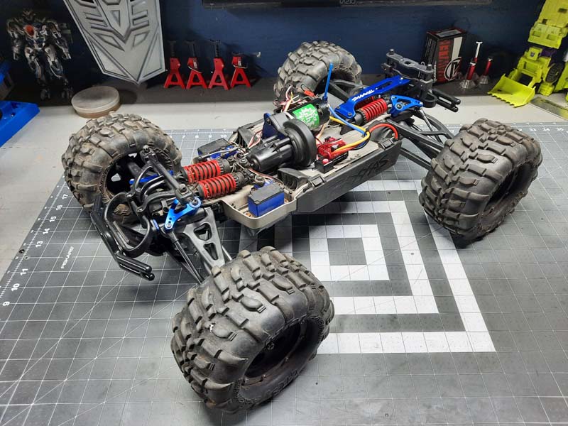

It was listed as complete, but not working. Wouldn't bind to the transmitter... hence the price. However, it bound right up to my radio and everything was working as it should. All the diff lock/2 speed mini servos seem to be working fine, steering was still plenty strong, and I drove it around a bit in the backyard using an odd 2S/3S combo just trying it out. The 775 is tired, or maybe it doesn't like 3S, I don't know - looks like it's seen a lot of water. Not to mention the extra pounds of mud caked everywhere. It lumbered around, and clearly needs quite a bit of work.

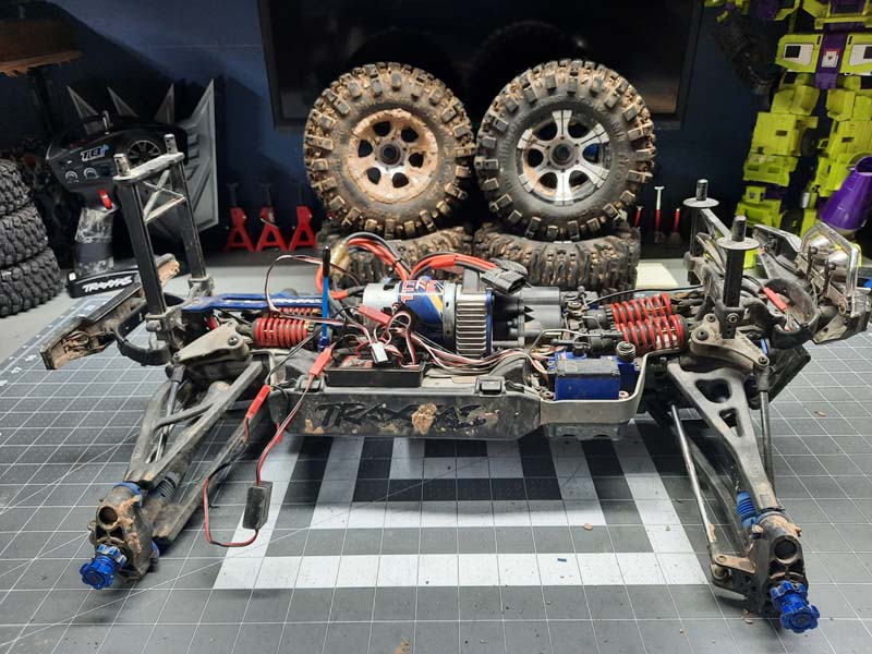

As it came.. a bit of a basket case, but complete other than the radio box cover. Had some huge 40 series RC4WD wheels and tires, rear chassis brace, and to my surprise it has the hard anodized shocks. Nice!

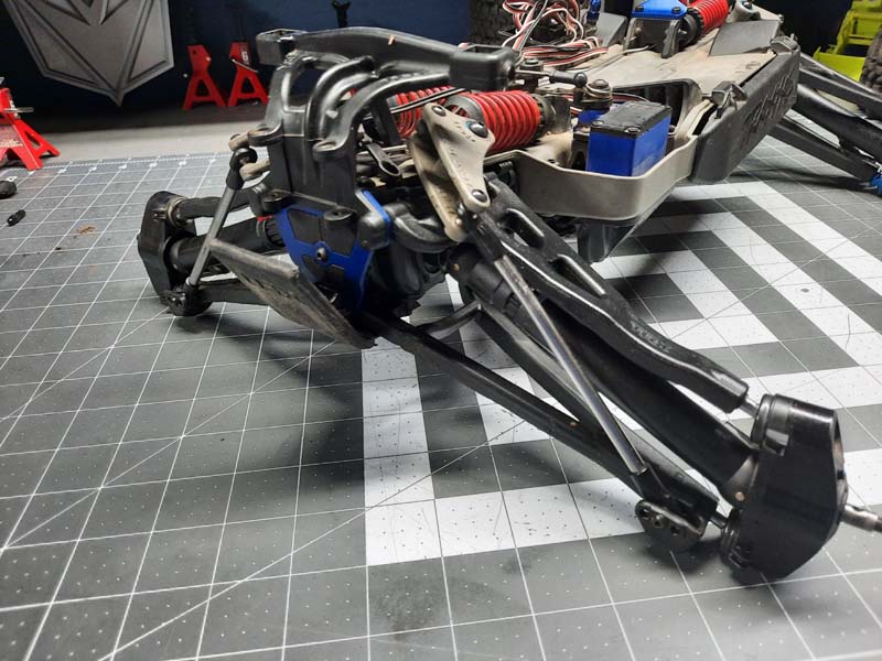

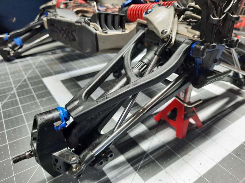

Front suspension took a shot. Pushrod link is bent and the knuckle has pulled out of the pivot balls somewhat so the front wheel wobbles all over. I tightened everything back up for now though I think I'll need a knuckle as the threads for the pivot ball retainers looks like they've stripped a bit.

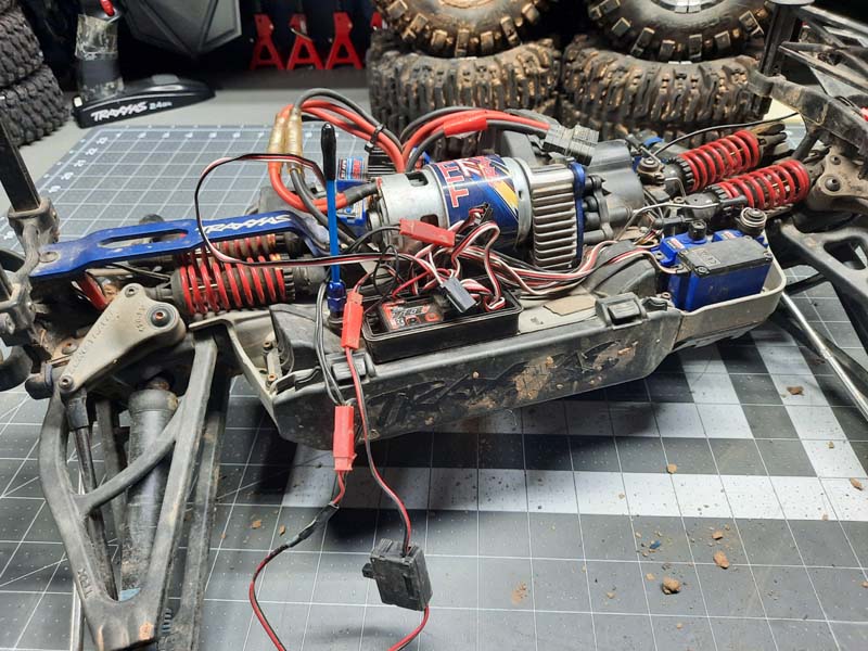

First thing's first - I hate a muddy truck. Cleaned it up a bit, and swapped out the EVX/775 combo for a simple Trailmaster 21t for now. The driveline is a bit crunchy, I'll have to get in there and do some cleaning/regreasing.

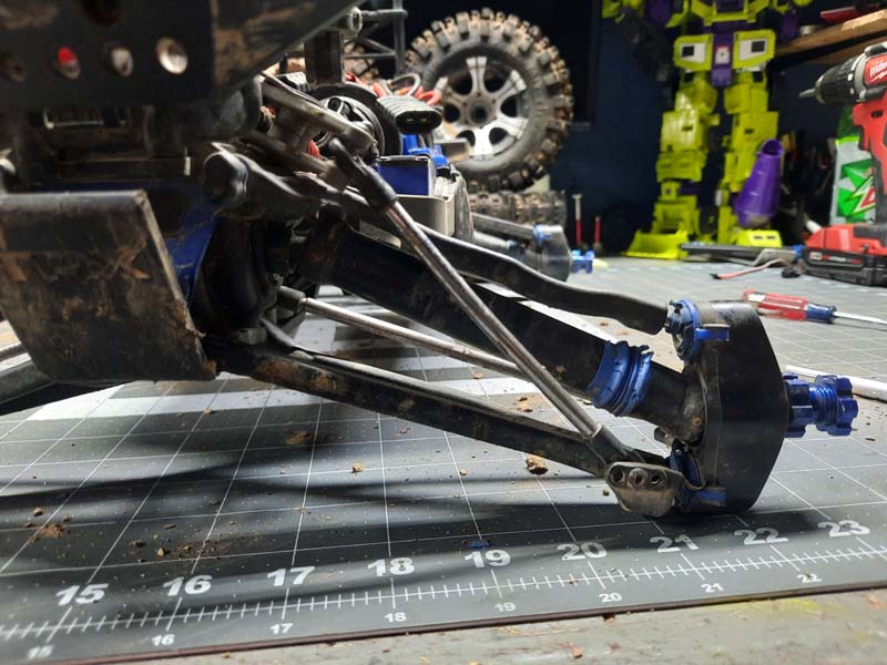

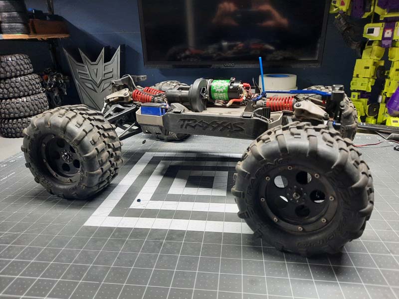

Took off the 17mm hubs, swapped over to standard Maxx 14mm hexes I had left over from the Maxx money pits, and added my crawling tires off the C-Maxx. Also shortened the WB a bit using the secondary mounts in the rear arms for better steering and breakover, such as it is. Liking the stance, thinking it's definitely worthy of being built up for trail duty. I'm loving the locking diffs, I like messing with them on the trail with my TRX's, so it should be interesting putting them to use on this beast.

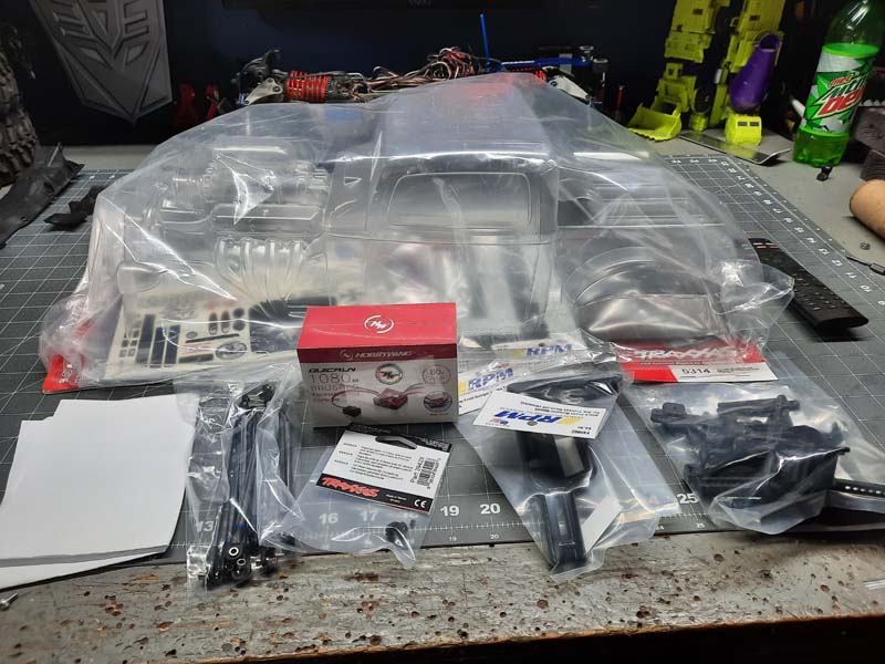

So of course, I ordered some new goodies:

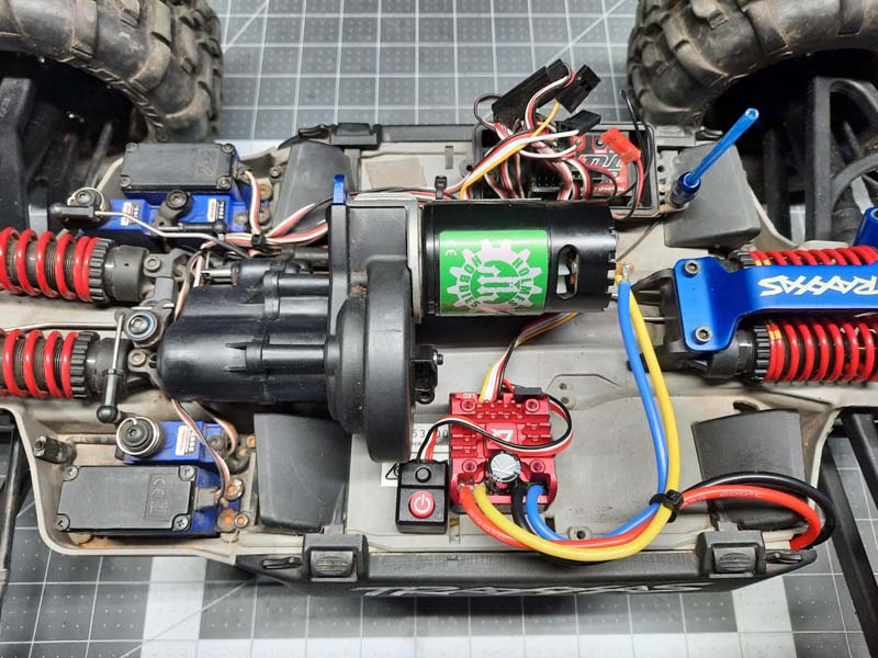

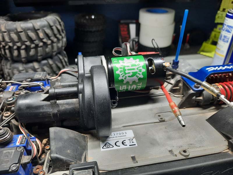

- WP1080G2, I'll configure the drag brake to shut off in high gear. Pretty nifty.
- LEM transmission dog: it's supposed to help the slop in the transmission, of which there is a ton. Might look into an E-revo single gear setup if I can't tighten up the trans.
- Replacement front knuckles and a full set of takeoff links and pushrods to replace the bent ones.
- New body - no way I'm running that Summit POS body. It's in good shape, it's just fairly ugly and heavy. Something lighter and more sleek is en-route.
- Couple of odds and ends to play with - new pinion, bumpers, etc.

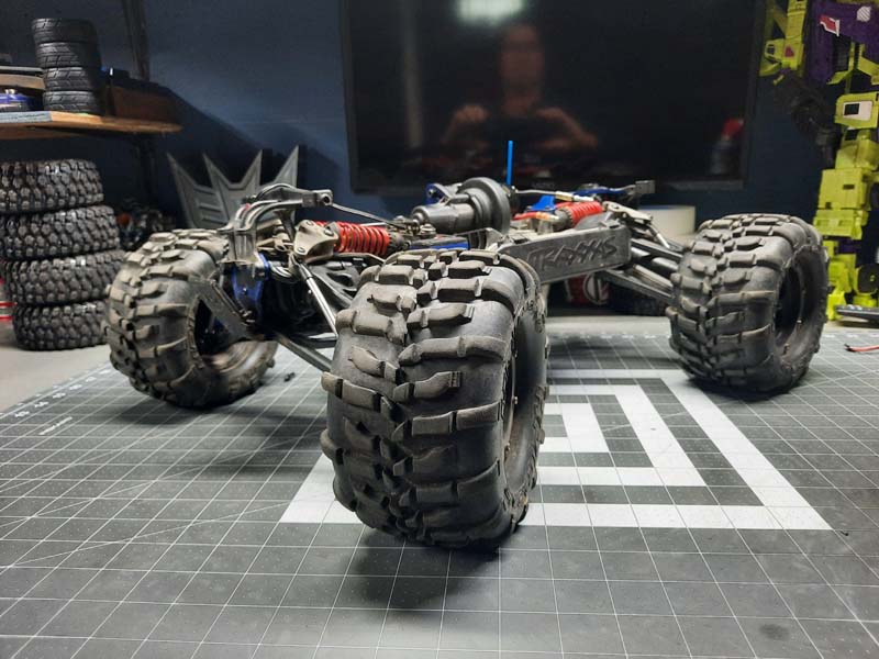

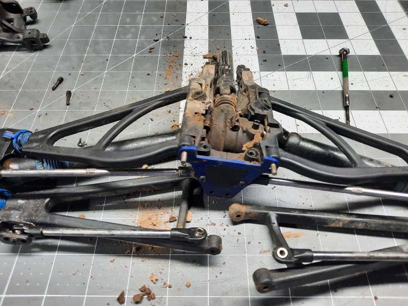

Let the teardown begin! Definitely have some binding in the drivetrain, so I started out back which is where I figured it was most likely. Tore it all down..
Holy mud! I hate mud, and never drive through it. I'm that wuss who carries his trucks across anything deeper than wheel nuts. This is why...it was in every nook and cranny, and there's lots of crannies. Not as many nooks though, so I got that going for me which is nice.
Lost a few ounces...

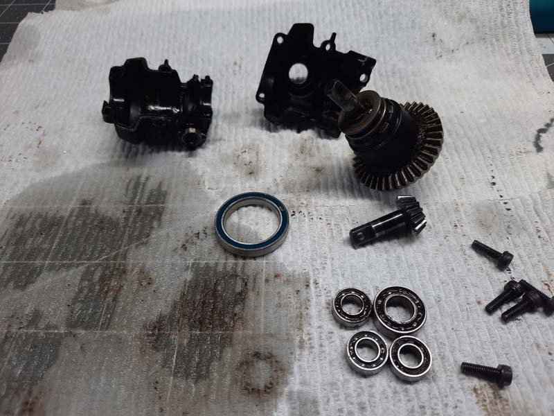

Everything looked to be in good shape. I took all the plastic parts and gave them a bath, and all screws, pins, bearings, and metal parts get an overnight bath in WD40. I don't have an ultrasonic cleaner, so I just put them in a watertight container, cover them with WD and give them a vigourous shake. Done!
Gears look ok, but it was turning a bit stiff. Pulled the seals on all the bearings and gave them a good cleaning. I only leave the seals on the outer faces on any bearing that sees dirt. TRX bearings have a lot of drag, and leaving the faces off frees things up a ton. Re-oiled the bearings, gleaned off the much and gave a light coat of red and tacky and the rear diff spins 100% better.

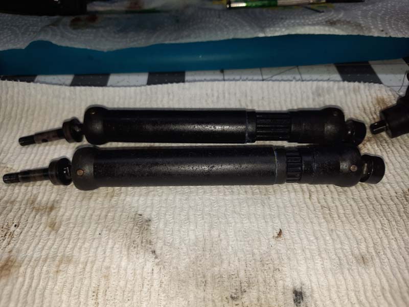

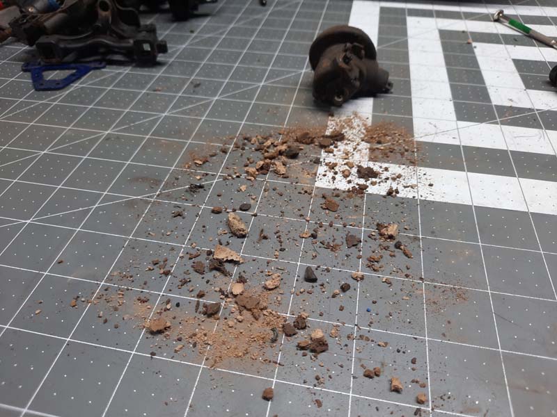

Tore down the CVD's while I was at it. They were a mess, not really moving free at all. Cleaned off any surface rust I found on everything, and found 2 of the CVD joints were flared a bit from contact with the pin, which is why they weren't spinning smooth. Ground them down flat again, a light coat of moly, and reassembled. Spinning nice and smooth again. I flipped the shafts so the sliding point is closer to the chassis. Hopefully it stays cleaner that way. I ditched the blue seals, they were rotted away.
Just waiting for the plastics to dry and I'll reassemble and move to the front. Won't be pretty, but it'll be mud free and spinning smooth. Glad I tore it down, it needed it.

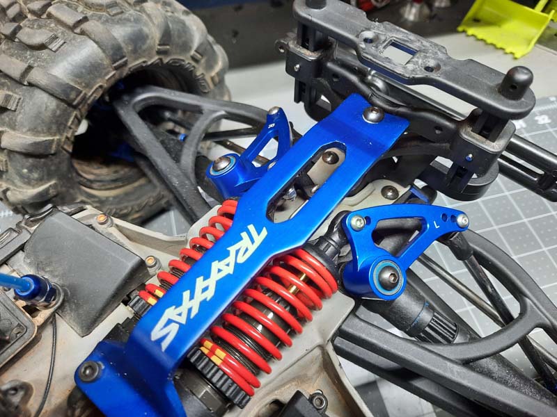

Got the Summit pretty much buttoned up. Mini parts haul - didn't need much, just a couple of things.
Ran through and cleaned/greased/rebuilt the front the same way as the back and everything is nice and smooth again - suspension, gears, driveline - all like butter.
Started throwing the new parts on it quick - bumpers, pushrods, etc. and got it back on 4 tires. Definitely digging it!

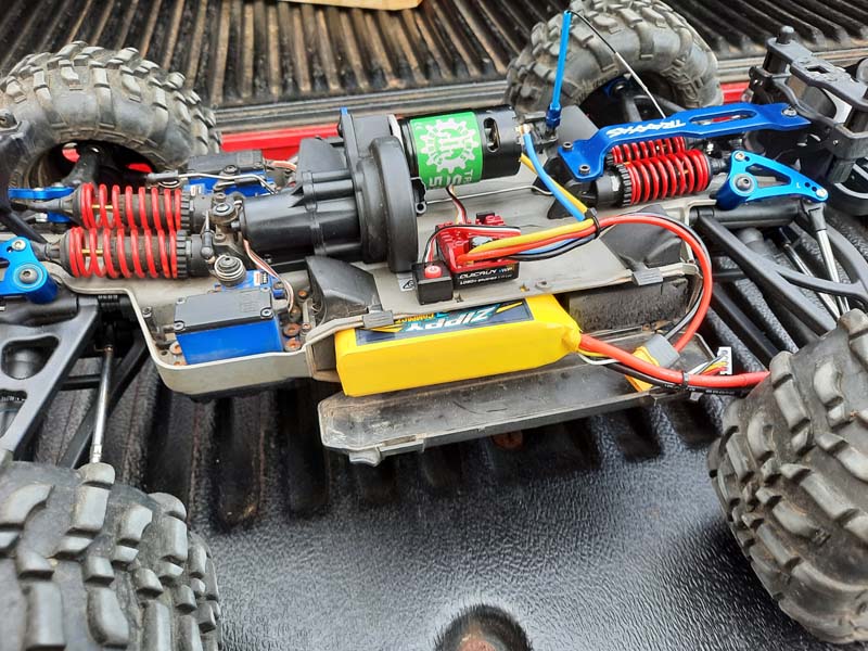

Holmes 21t with a 1080 and a 12t pinion. First gear is a fairly low crawler gear, and second is a bit more zippy. I have more room to gear down, but this felt like a good start just tooling around the basement. Might even look into a Crawlmaster, it works great on the C-maxx. The LEM shift dog really does take a lot of slop out of the transmission, it makes a huge difference. I haven't looked into disabling the drag brake in 2nd gear yet, but I think I can do it with the G2, I just need a splitter. The only part I missed was the top of the receiver box, I'll have to order one.
Picked up some cheap Amazon rockers, I just like the look. They match the brace perfectly! Personally, I think the suspension is the star of the show for me on this truck, it's such a cool design. I'd like to work it into the body somehow.
RPM bumpers with the front bracket flipped, Savage tires on beadlocks donated from the CMaxx and went with the Revo Rat Rod body. I had to mod the front mounts a bit, but I got it to sit pretty low. I think it'll look decent when its painted. I have a Yeti bug body here too which fits perfect if I change my mind.

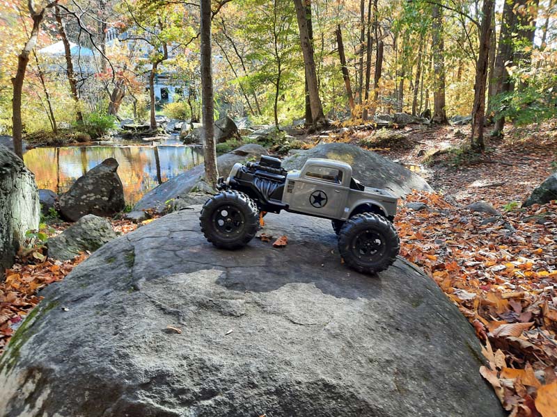

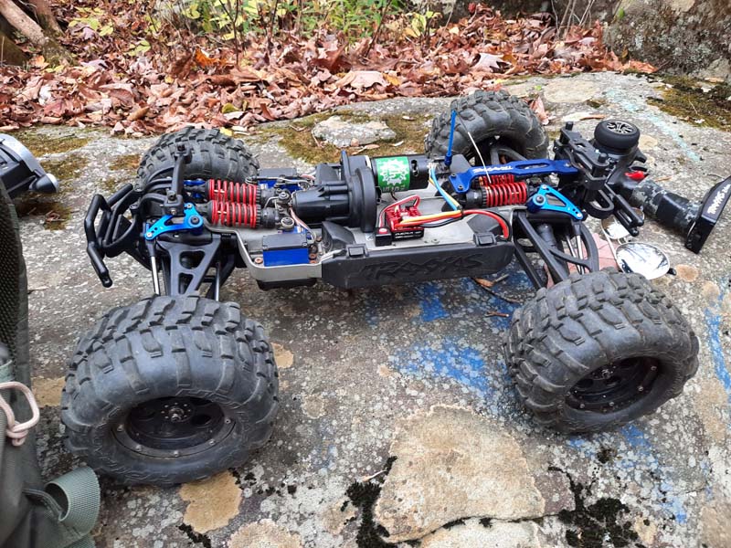

Charged up a few packs and brought my 6x6's out to play, but the leaves were so thick I left them in the truck. Summit time! Since I brought this along for a test run, figured I'd go stretch its legs a little bit.

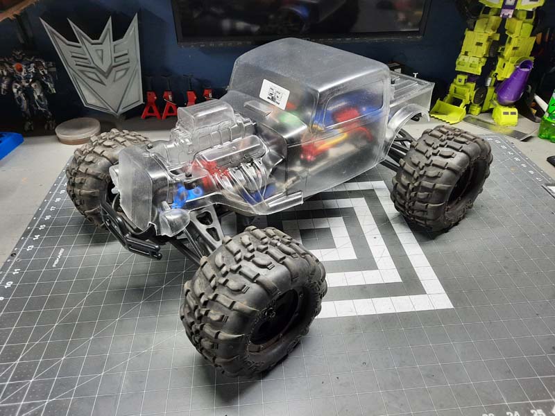

Got the body painted up - nothing too fancy, just a simple scheme. I ghosted the engine parts with gunmetal so they pop out a bit and hopefully add some 3D effect.

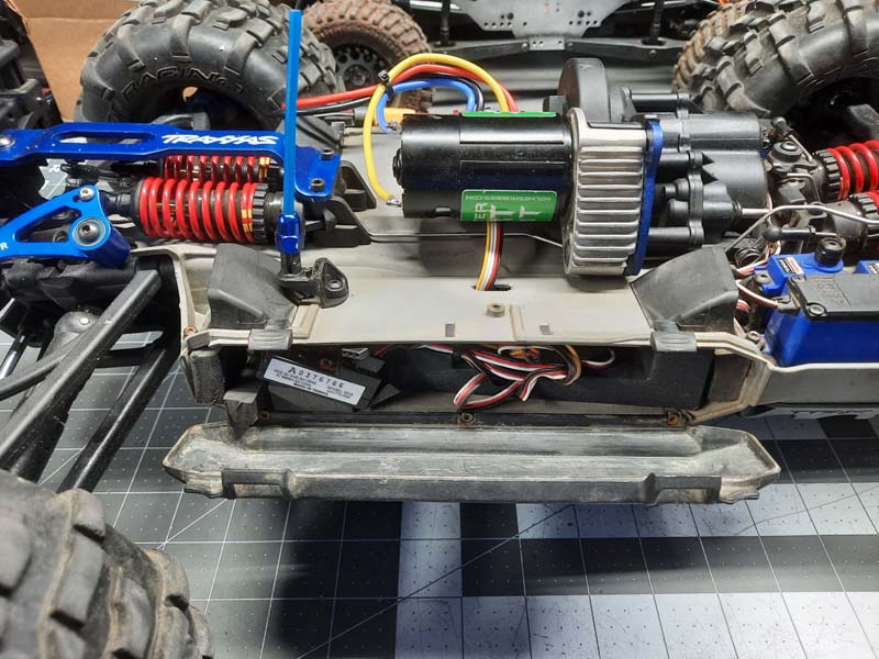

Received the channel reverser and got it all wired up so now I have drag brake in low gear, and none in second gear. Pretty slick. I couldn't fit all the extra wiring in the radio box, so I cut up some foam and made a nest for it in the battery tray. Works perfect and well protected in there - makes for a nice clean chassis too. Made some foam spacers so I could run my normal 2200 3S packs on the other side....and away we go!

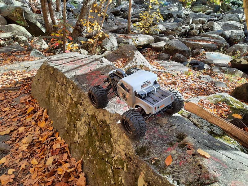

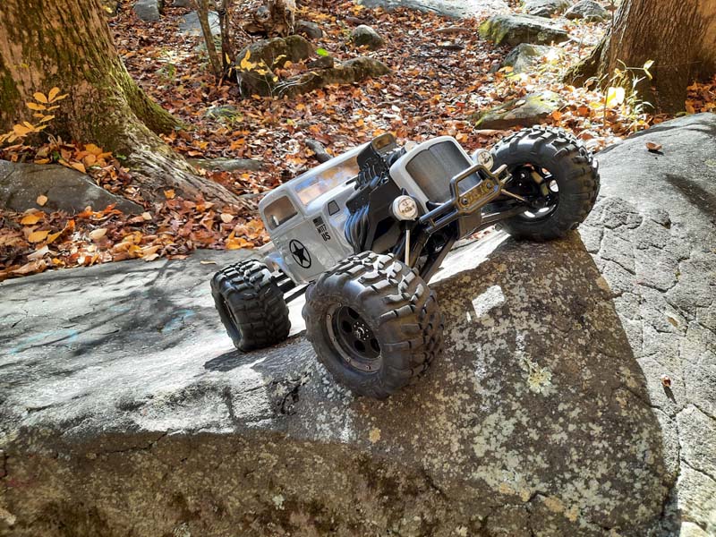

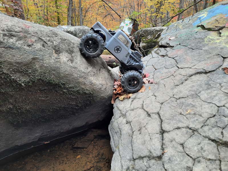

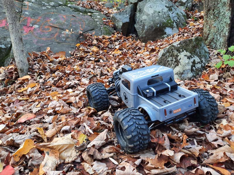

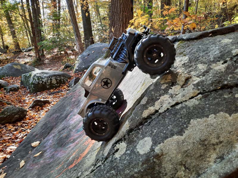

Could not have picked a better rig to go out and play with today. The leaves are coming down fast and furious and have created a thick carpet on the trail. 1.9 trucks are buried up over their wheels in most spots, so until these leaves pack down a bit, it's 2.2 size and up. The Summit handled it no problem.

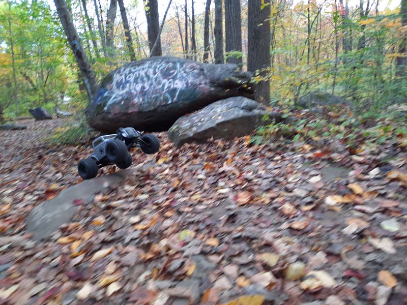

Testing the lack of drag brake in second...worked perfectly! I got pretty good air here, but unfortunately this is the best pic I got.

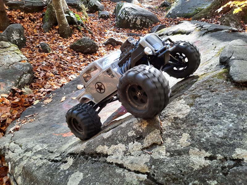

Dropping down into first, locking up the diffs and onto the test rock. The Summit handled it just fine - in fact, it crawled very well - way better than I expected. Getting rid of the heavy (ugly) body, that huge 775 motor and running a single pack really lowers the weight up top. It climbs pretty decent, and just like the C-maxx it sidehills amazing.
A few more random rock pics. The steering is...well, awful. I switchbacked my way down a few lines as it was easier than trying to turn. Chassis has good balance thankfully - it's not front heavy so it's very capable in reverse which helped. As long as you plan your lines with the steering in mind, it's not too bad once you get used to it.
Love this pic...

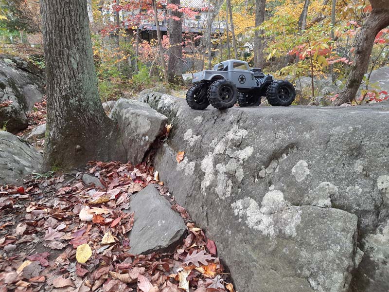

Since this was the only rig I was driving today, I meandered around to a few locations I don't normally get to. This is down by the swimming hole, there are some excellent rocks to play on down there, and the scenery was amazing yesterday. Powerwise, the 1080/Trailmaster did fine. Plenty of tractable torque in low gear and just enough speed to throw up some good roost in high gear. Power-wise, it was fine - I don't miss the 775 at all.

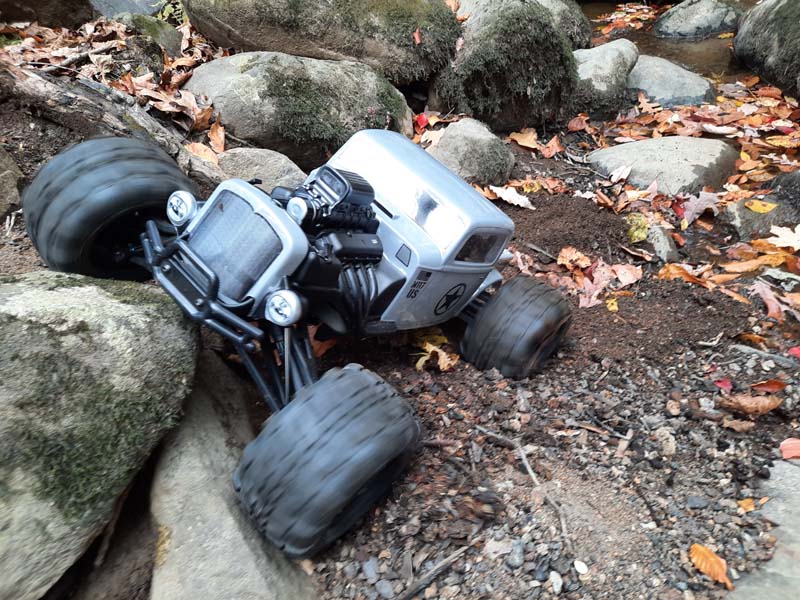

Finding the limits...they were a lot higher than expected
Proof that I do...once in a while...every blue moon... tackle water. It was maybe 2" deep at the deepest spot, I figured I could chance it.
And it left cool tire tracks on the way out.
Crossing the creek again...only a handful of rigs make this line, the Summit had enough approach angle to make it work. Very impressive!
A nice silty exit from the creek bed. Left the diffs locked, put it in 2nd gear and U4'd it up out of there. It was way more rock bouncer than finesse, but no problem for the Summit.
This truck is geared very similar to my TRX4's, and with the locking diffs it drove like one too. Well, a really big, wide one that kind of steers like a boat. Locking the diffs make a huge difference in turning - it just wants to push forward when locked...so I was unlocking diffs quite a bit to make turnd, and just locking up as I needed them - just like with the TRX's. It made for a very satisfying drive I have to say. I got the hang of unlocking the rear to re-place it on a tough climb, letting it shift left or right as needed and then re-locking when it's in the right position and watching it grab and go up and over. Nice little party trick, and made up for the craptastic steering in a lot of ways.
I didn't go easy on this truck, by the end I was beating on it pretty good, and trying some harder lines.... I found that with the width, I could straddle all kinds of stuff and all of a sudden new lines were everywhere.
Battery check - I thought this big beast would chew up the batteries, but it's pretty frugal. Averaging about 900mah per hour, which isn't bad at all. Motor and esc were nice and cool.
Only one of two trucks to make this climb. Pretty impressive!
