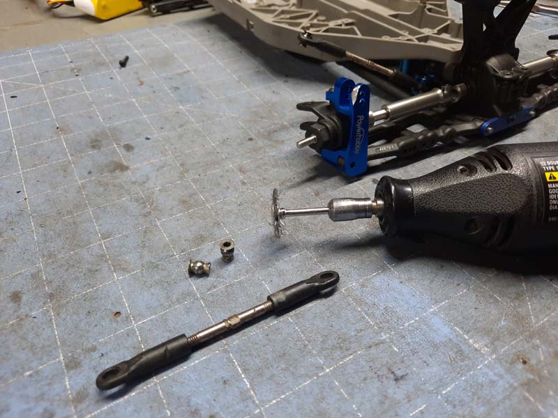

I've never gotten a used roller that was so stiff. Everything was stuck, not sure of the PO dipped it in a vat of CA glue or what. Driveline was super stiff, and the suspension was so stuck I could pick up the chassis by one axle and get no flex at all, even without shocks. Never seen anything like it. I cleaned everything up, reamed the holes for the hingepins, and went turnbuckle by turnbuckle and got the surface rust off and freed up the pivot balls. Driveline was fine after a deep clean and soaking the bearings in some oil. They weren't gritty, just stiff. Everything moves nice and smooth now.

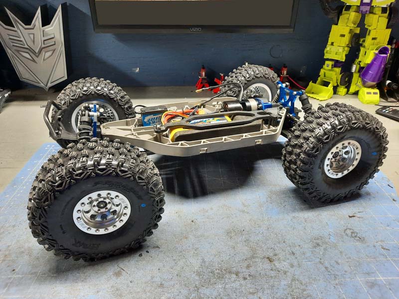

Chassis as it sits. Basically the same setup as the Crawler telly, just longer and wider, and with a bigger outrunner. I had planned to use some big 2.2's, but I needed so much offset up front they were in the next zip code compared to the steering kingpins... that's never good for steering or durability, so I took the tires off the 2.2/3.0's I used before and got them mounted up. Plus, I love the look! Just waiting on some taller tires which are en-route. I totally forgot to dye the chassis black, I got in the zone and started building. I have to tear it back down and get busy dying.

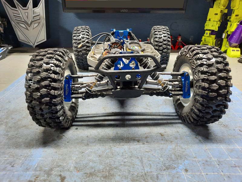

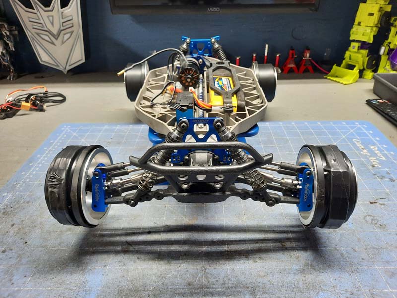

Picked up the Proline U4 2.2/3.0 tires in Predator flavor, and they are pretty nice and sticky. Should crawl very well! They come with PL's standard 2.2 foams for some reason and had zero chance of fitting over the wheels.. I opened them up with an Xacto just to get them mounted. They are a bit uneven though, and the tires came out a bit lumpy. Not sure if they'll wear in or what. Kinda pissed, for $40 a set, the foams should at least fit the intended wheels. I do like the size, I wanted a bigger platform then the Telluride/Pede chassis, and I think I got it.

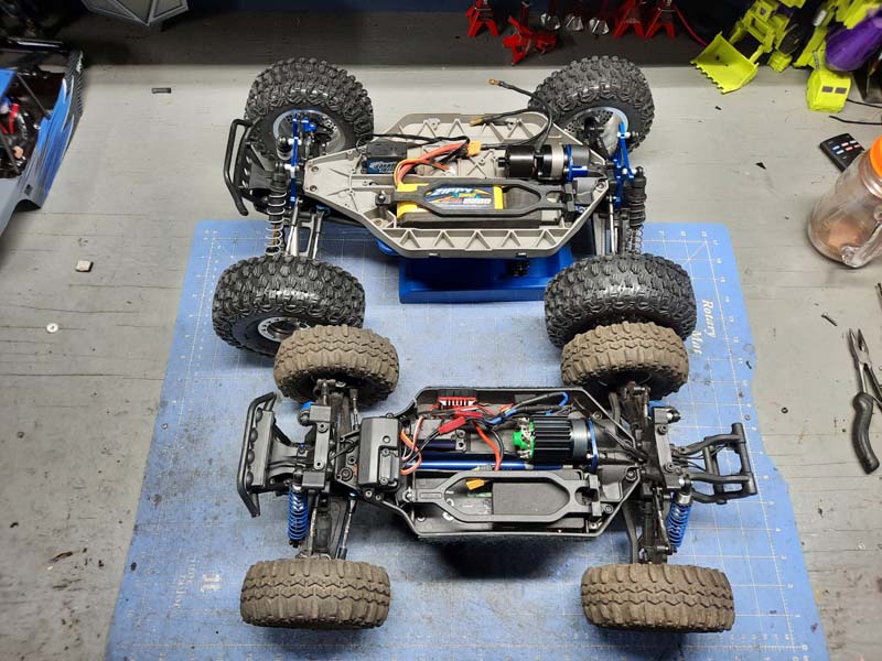

Compared to the trail telly...

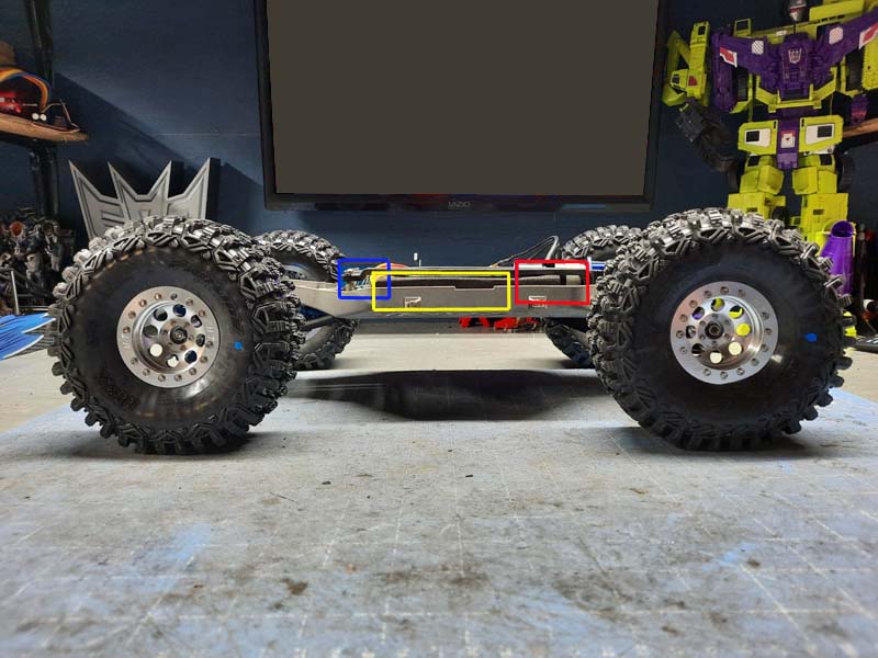

Looking at the side view, the ESC motor and servo are just above the wheel centerline at ride height. Should have a great COG!

Well, I did a standard Telluride ( with 'pede/slash 4x4 arms,) one with narrower arms (Telly/Rally arms), and one with even narrower arms (Bandit arms on the Trail Telly, which was the keeper). Feel like I've kinda wrung that chassis out, not sure what else I could do with it. Plus the Trail and Crawler telly were pretty much identical. Going Slash size give me a longer WB and opens up some other bodies - plus I can use all the same crap I've piled up. I've piled up quite a bit of Traxxas 4x4 chassis bits - 2 tellurides, 1 rustler, and 2 Slash rollers, plus all the random hop ups along the way. I certainly have enough to build another roller if I get bored. As of right now, Keeping the Trail Telly as is, building this Slash based one to crawl, and building up the Rustler to bash. The rest are spares.
