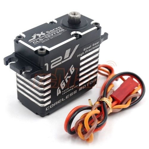

This truck performs very well straight out of the box. It can do even better with these modification. The included tires, motor and ESC surprisingly does what it is suppose to do. I upgraded the steering servo with the JX CLS-12V7346 and I run this truck on 3S.
Yes servo is the weak spot on the truck...those 20KG blue waterproof Power HD servos are great for just over $20.00!
