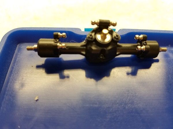

Started assembling the Jeep today.

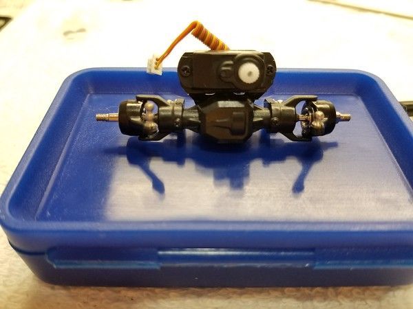

Front diff is all assembled and the servo is mounted
Rear diff assembled and ready to go
This build is going much better than my Pajero. Building it I used the enclosed tools, small phillips screwdriver & L hex wrench. It was a total pain trying to get the balls started using a L hex. For the Jeep build I got a 1.9mm hex driver and a #00 JIS driver which is the Japanese version of the US phillips screwdriver. The JIS screwdriver holds the screws better and has a bigger handle so it's easier to use. Have to use caution not to over tighten the screws as you have more leverage with the bigger handle. Don't throw the phillips that came with the kit away, there are a couple of places you will need it to finish tightening the screws as space is limited.

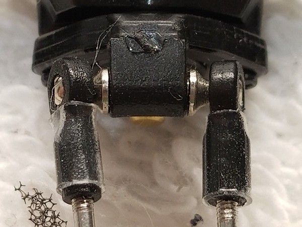

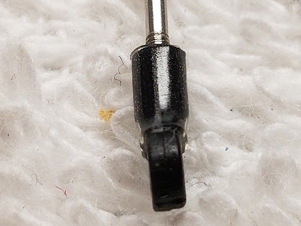

The next step was building the rods
Completed rods installed on the diffs
Had a problem with the Pajero splitting rod ends along the rod. I re-enforced the ends with 1.5mm shrink tubing 5mm long. After shrinking I'm hoping that this will give the some added strength. Only time will tell if this theory works.

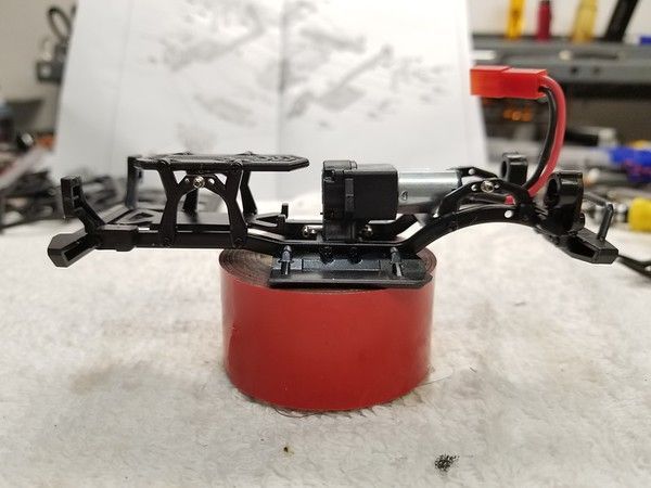

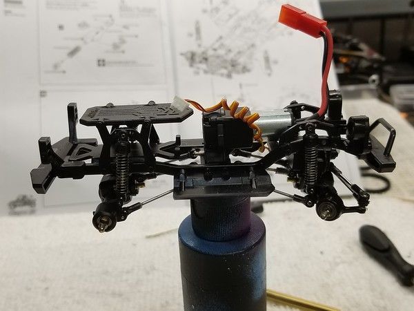

Next came the assembly of the frame
The combo kit came with a 150 motor ass did the Pajero. IT crawls okay but is a little on the slow side. So I'm putting a 300 motor in the Jeep.
Installed the diffs on the chassis
Skipped the step of installing the LEDS for now. I'll do this after a couple of test drives. The next step in building the front & rear driveshafts. Hopefully this goes better than it did for the Pajero.

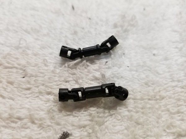

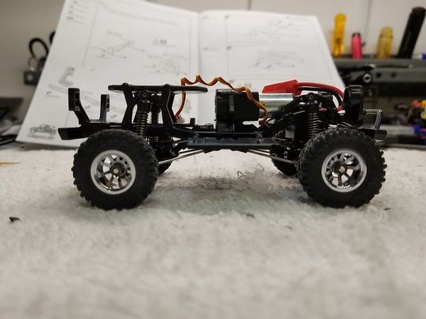

Finished up the Jeep today, well except for the lights. Started with the driveshafts. Kind of wishing I would have ordered the aluminium ones. For me I think that is one of the hardest things to do. At least this time is was easier than last time. I did discover that after putting the square block with the pins in the 1st piece, I start by putting them in the pinned block in the shaft end. I then used a tapered tooth pick behind the block to hold it in place while I put the ends on.
Completed driveshafts
I used XL-Racing's wheel mod to give it a bigger stance
I thought he used the stock wheels but when I did the mod to the stock wheels when I installed them and tightened the wheel nut the wheels wouldn't turn. I think it's the way the spokes are bent. Does look good with the reversed wheels.

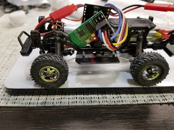

Test fitted the electronics. Thought I could mount them the same way I did the Pajero but the esc hit the windshield so I have to come up with a new plan. I cut the tabs off the transmission that I used to mount the rx and esc in the Pajero. This way I can mount the esc & rx lower in the chassis to help to keep the cg as low as possible.

That's why I went with the Tatic TXX300 the rx that comes with them is small and the antenna is built in so there is no antenna wire hanging around.
I cleaned up my wiring and it looks much better now.
