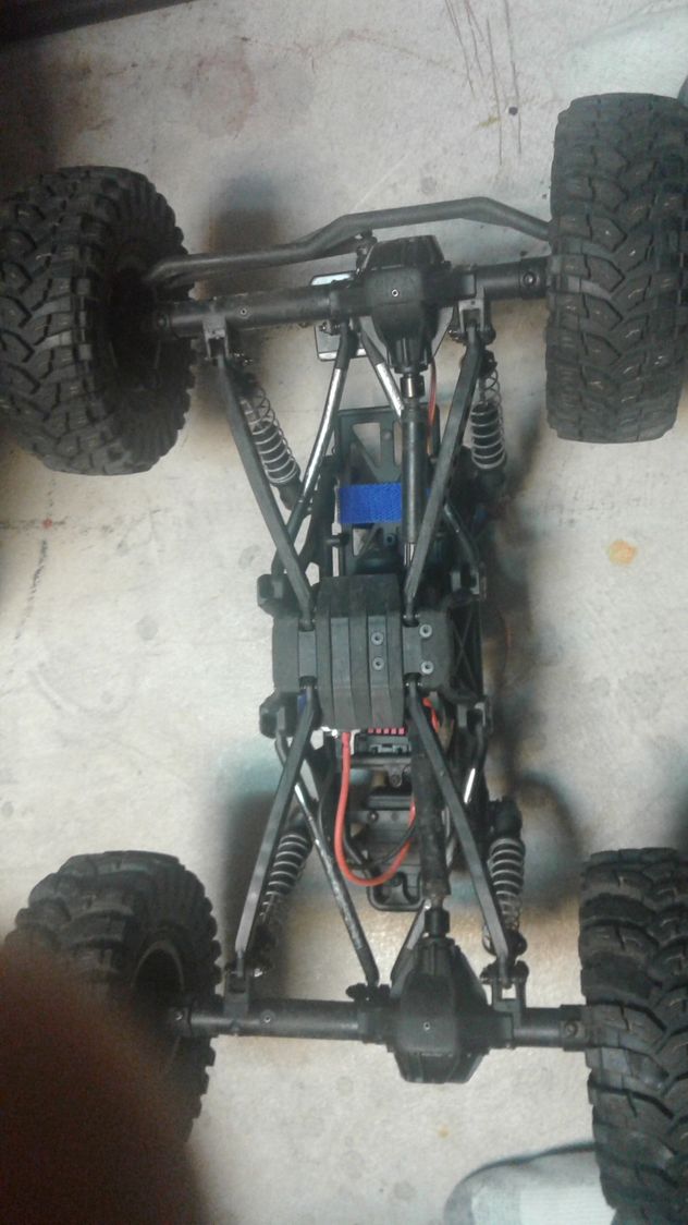

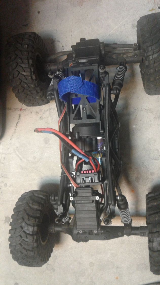

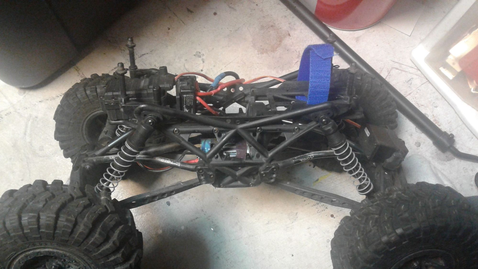

Im looking for some info on this chassis.
I know it's a old chassis
Is there a list of things I should upgrade?
Where would I find parts for it?

First off which chassis do you have? Does it look almost like a horseshoe or a ladder chassis? Cuz there are diff upgrades you can do depending on the chassis

I really don't know whatso I got? Can you tell me?

Ok you have a first gen deadbolt. Don't know what there is for upgrades except for the axles. Any wraith axle upgrades will work

You can look under AX-10 Ridgecrest. RCcrawler forums has thread for this chassis. Topcad has the vertical plates. But can be purchased from Integy, search under Ridgecrest. The lower links are from the the Wraith. The gear box is from the SCX10. The driveline is from the wraith. You can use a 550 motor but the rear part of the can will one of the lower links and reduce rear end articulation. The shocks are from the wraith also. I have this chassis but I migrated most of the parts to a 2nd hand wraith chassis to use as a FPV platform.
Good luck and have fun.
