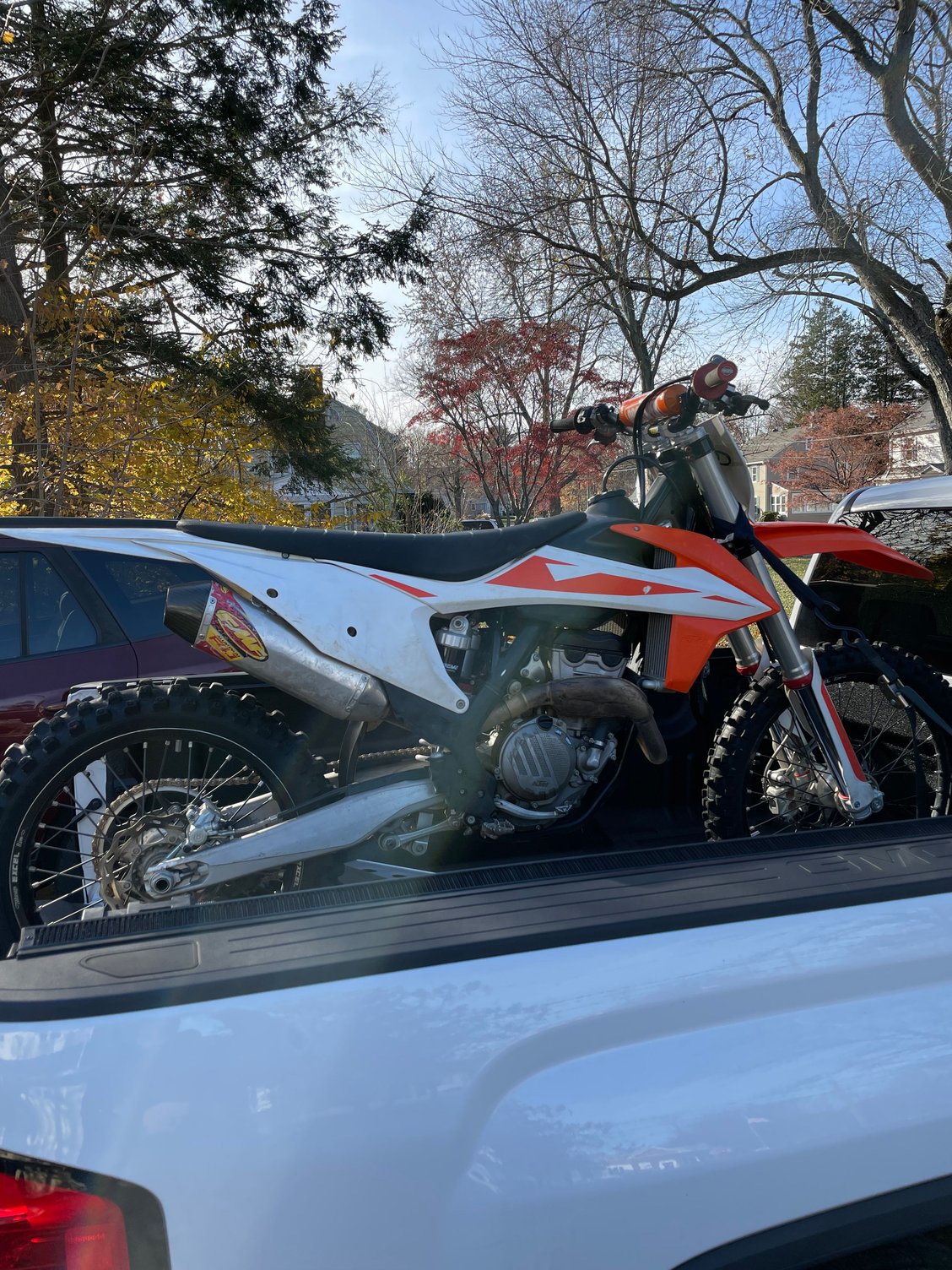

Picked this up this past weekend for 2K. Ď19 KTM 250 SXF with 70 hours on it. I was told the top end was done and it ran fine for a while until it locked up. I pulled the timing plug and tried to turn the engine over counterclockwise with my breaker bar. All it did was loosen the bolt on the flywheel. I tried going clockwise and it tightened the bolt. But the engine also started rotating to a point and then stopped. I checked the battery voltage and it was about 1.5V. Not sure how long this thing was sitting for. Put a battery from my old Aprilia VDB sumo bike in it, and it cranked over until it got to that same point where it locks up. Iím going to pull the intake, exhaust, and plug to check the valves and combustion chamber with my borescope. If everything looks good, Iíll start pulling the engine covers.
Not sure if Iím going to keep it or not. The reviews state that itís a great bike. But I really want a 2T. Couldnít pass this deal up though.

RM is setup for enduro not MX. Sounds like you'll be rebuilding or replacing that head. Trade you the RM for the KTM.
Nice RM btw
I'll put money on it being a valve hitting. I bet they put the timing chain on wrong, or the chain jumped a tooth. I bought a XR400 a while back due to the same thing. They said the engine froze, but it was just a valve hitting the piston. Got the bike for $500 and sold it a month later for $2500. I only put $200 into a new piston, and rings. The valve was still perfect. I only changed the piston and rings because I already had it apart, so why not.

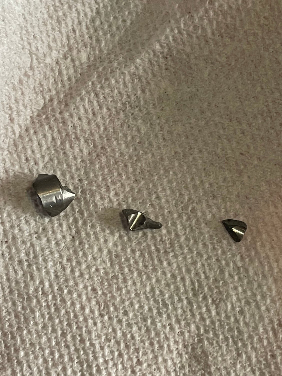

I was finally able to start tearing the bike down. When I removed the air filter, I found some cast metal pieces in the airboot back by the sealing surface of air filter. My first thought was intake valve guide, but why would it be back by the air filter? Used my borescope to look down the intake. Yup. Left intake valve guide. Iím surprised it made it past the throttle plate. Unless it wide open when it happened. I wonder if there was a massive backfire or if the pressure of a bent valve forced it back to the air cleaner. I need to remove the engine and start by checking timing to figure out what the cause was. I couldnít look at the top of the piston with my borescope. This thing has the smallest spark plug threads Iíve seen on a bike engine. I didnít measure, but looked to be 8mm or 10mm. The same diameter as the cable/camera on my borescope.

Hopefully it's just needs a new valve, valve guide, and maybe a piston. I guess you'll find out about the cylinder as soon as you pop off the top.

Yeah, but depending on what the combustion chamber looks like, Iíll probably have all of the guides, seats, and valves replaced. Peace of mind for myself.
