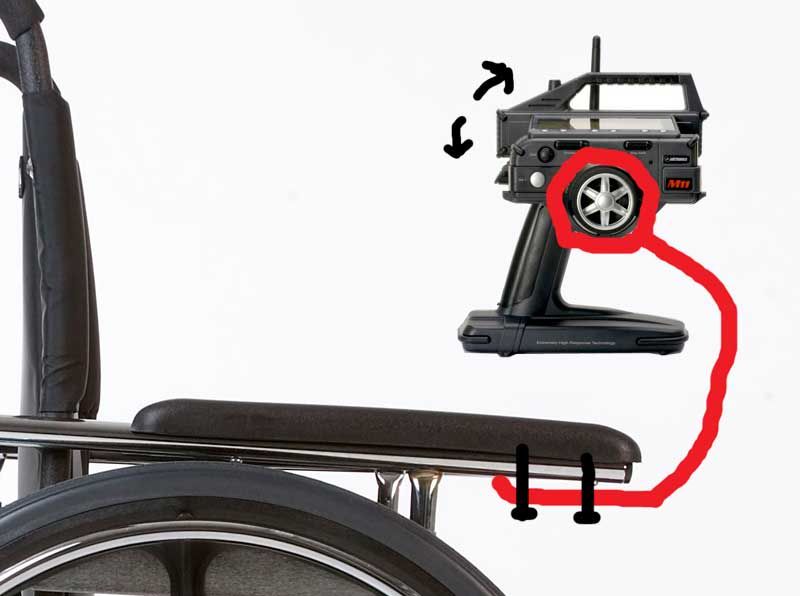

Lots of good ideas. I especially like the idea of a foot control. Adapting a set of pedals from a console game wheel would be a fairly simple task. It could be as simple as running extension wires from pot A to pot B.
For a fast easy solution though, I think a guy could just clamp the wheel solidly to his wheelchair and just turn the rest of the TX for steering. A couple zip ties and you're good to go. I'm not sure if this is the same thing Domit was thinking of. Of course, I guess right or left hand would come into play, but you could use a M11 or something similar.
Of course I've used my thumb for steering many times, it just takes a little getting used to.
This is a really good idea too. Very simple. Quick photochop for a visual...(should have mirrored the wheelchair image )
I just happened to only be able to find an M11 with a straight on shot
The red is the bracket of course, could use velcro strap to grab the wheel. The bracket could also wrap around the wheelchair arm. Again maybe velcro straps.
