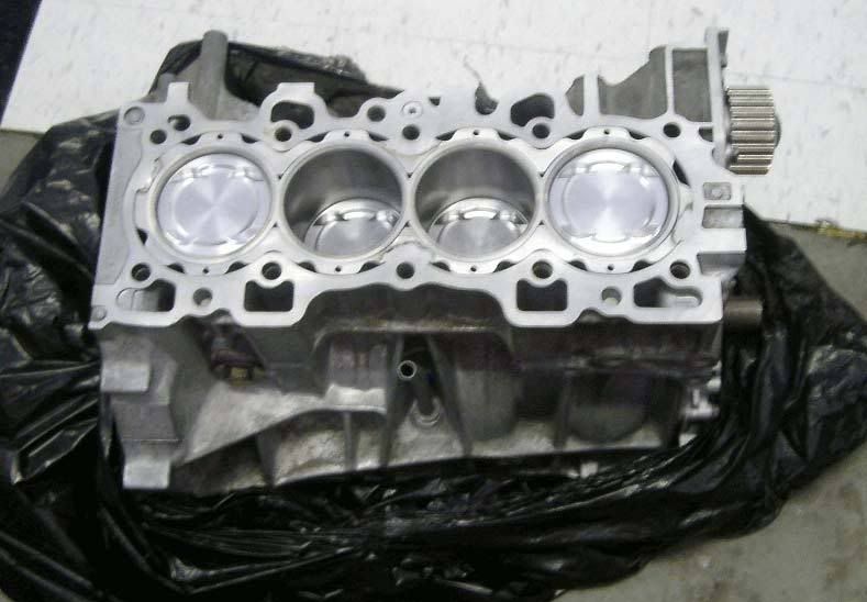

It's a B16
20 over Arias Pistons
Eagle Rods
Clevite moly coated bearings
GSR cams
Supertech springs,valves retainers
Turbonetics T3/T04E 60 trim compressor, Stage 3 .63 A/R exhaust side
Jank ebay turbo manifold slightly modified and Jet-Hot coated
Jank Tial knock-off 38mm wg
Greddy Type S BOV
Precision 1000cc injectors
AEM Fuel rail and FPR
MSD 6BTM
AEM Engine management with OBD1 conversion

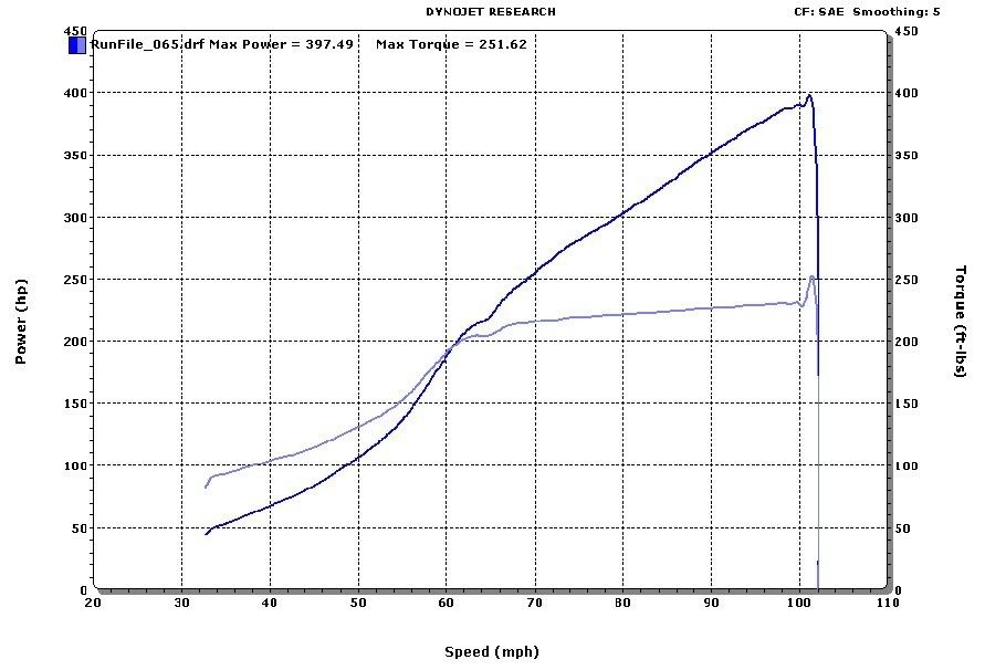

Made 397whp on 13-14psi, running 16-17psi now, but haven't dyno'd it since, prob making 420-430ish I'd guess.
Don't really have current pics of the motor, but here's a few:
1st build, block looks basically the same as this now
Here's the dyno graph of the lower boost
wow that is quite the peice of machinery. i wouldn't have a license if i had that car lol. Those AEM ECU's are pricey, would you say they're worth it or is there other ones out there that are just as good for half the cash?
