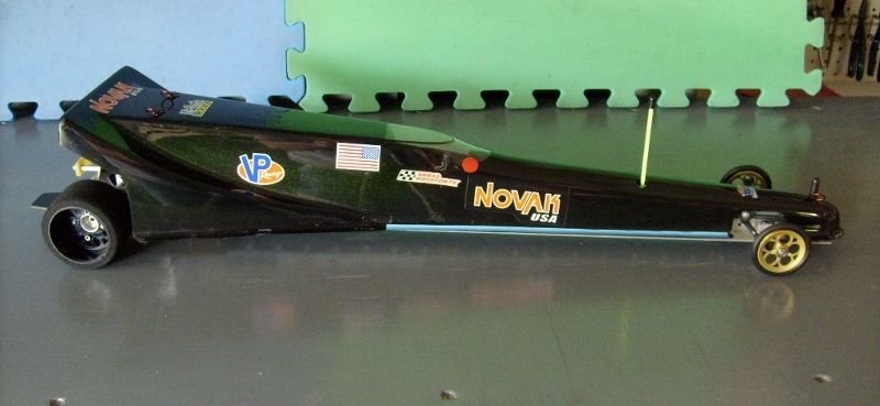

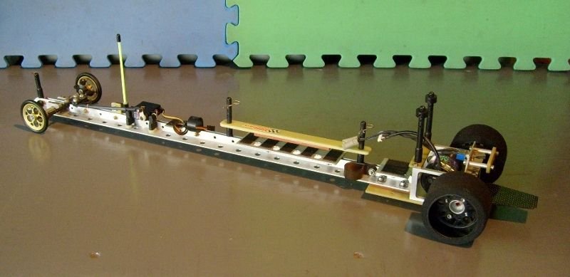

Ran a wedge body in 2009. RC drag racing 2.50sec Index Class. Speeds were consistently in the ~61-64mph range. Wedge will give you a lot of down force, although a lot of drag comes with it. For the class and the speed range it ran in, it provided a very stable, predictable platform.
The car was originally built for the Electric Top Alcohol Dragster (2s Lipo). I built my own chassis and they were always heavy and stiff. Not enough flex for the TAD class at ~90mph. Confident the wedge body would have handled that speed, though.
Something to consider, anyway. Good luck with your project.
